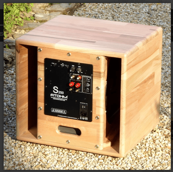

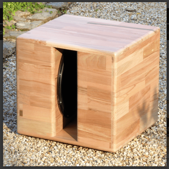

Beyma offer excellent, high performance and ruggered speakers - the 12BR70 is a typical sample. I use a pair of 12BR70 in my Omega Ripole Subwoofer :
Since I have several pairs, maybe I'll build a project of large sealed enclosure with them also... But they can be used in Open Baffle too, since they have FS=30Hz / QTS=0.5 / N=93dB/w/m, and interestingly :
I never tested them in OB configuration, but it is certainly a valuable compromise for what you expect.

@tubelectron I'm still trying to figure out what makes a design a Ripole?
Is it lowering of the driver Fs by X percentage?? 10%???

@Davey - have a look on my small website below :
https://guilhemamplification.jimdofree.com/hi-fi-other-projects/
There's some explanations on the Ripole (in French and in English), and links to good websites describing more in details the principle of this very interesting type of Subwoofer.
Search also for Ripole + Axel Ridtahler on google. There's many articles in English on the subject... And in German, of course !
