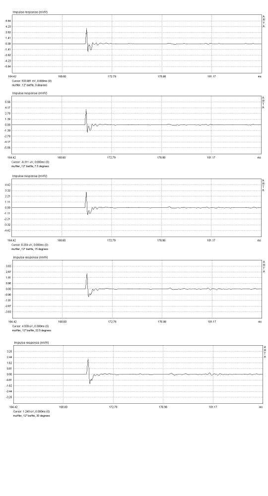

Adventures in cardioid
Same as above, 12" baffled muffler.
Yep, the baffles are uglier - not by a whole lot.
But - compared to the unbaffled muffler at 22.5 degrees, yes, they're worse. The way they settle down is lumpy and uneven, which is indicative of trouble of some kind. Most obvious guess is multipath, which has the unhappy property of being non-minimum phase.
I should add the 22.5~30 degree unbaffled muffler is really pretty good by any standard - that's pretty tidy decay performance (within electrostat territory). My guess is the wave coming from the rear is spread out in time sufficiently that it doesn't contribute to the comb-filtering we're seeing in the other graphs. Considering that deep comb-filtering is not really correctable by EQ, this is a good thing.
Good solid work, MBK. This is great data, and very informative!!!
Thanks for the flowers Lynn 😉 .
As I said above here I tried to compile a useful set of information first, with actual data, and to answer actual questions in an iterative way. So if it looks like a chock full at first, it's because it was intended to be comprehensive within its limited scope. And maybe it allows people interested in this approach to make at least some design decisions starting from this.
I'll be back with more whenever I get around it for a more fine tuned set of data, which may mean, weeks. 😎

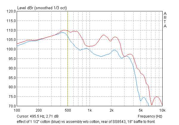

In the attached graph is an indication why - a comparison of rear nearfield output with and without the 1 1/2 " cotton of the muffler assembly (assembly in place for both curves, and 16" baffle used to avoid contamination by front wave). The cotton takes away about 8-12 dB but above 500 Hz only.
In my case this may not matter since I have a dipole bass waiting for crossover around 300 Hz, so I'll be quite OK if the pattern returns to dipole at those lower frequencies as long as the power response holds up, which it does according to Arta.

But John, that's exactly what is happening in my data:
- The LP has an effect roughly above 500-600 Hz (previous post), though the measurement was a one-off, not very clean and it was just a for the record exercise.
- The cardioid increasingly turns figure eight by around 600 Hz (post 13) . Post 11 has a sonogram to that effect.
We seem to be in violent agreement here...

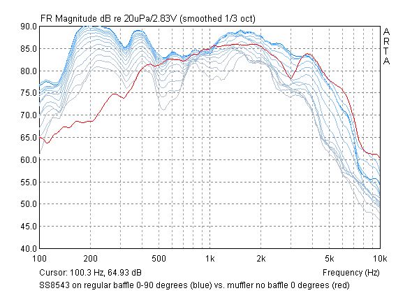

MBK, my question was refering to graphs show in post 2 and 8
if we look at the spl value at 1khz for exemple post2(on baffle) :less then 80db,and post8🙂about 85db is it due to cardiod or a different measurement position or level?
Hi Paul, good to see you here! - yes it took a while after moving before I got to do something meaningful in audio again... I am really interested in achieving more comprehensive, solid craft these days so I upgraded tools, go step by step, and refrain from posting just piecemeal tidbits. I thought of your felt actualy, results so far though indicate one must be careful not to overdo the damping to maintain good polar response. Much left to try!
Hobby1: now I get it, in short no I don't observe the +6dB. But the graphs in post #2 and #8 are to a different SPL scale, SPL per V, than all the rest, which are in SPL per 2.83V. So I re-drew these earlier graphs. Below is the first, as of your request 😱 . SS8543 on ordinary 24x48x7 U-baffle, no muffler, 0-90 degrees (blue) and for comparison, the 0 degree line of the same driver on muffler with no baffle. No 6 dB reinforcement, to the contrary the peak around 1600-1800 Hz is attenuated when muffler is used rather than the large U-baffle. This is well in the driver's directional region though so we have a mixture of effects here.

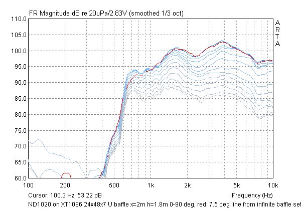

And for the record, the updated, standardized version of the 18Sound ND1020 on XT1086. The 7.5 degree line that had a glitch when measured on ordinary, 24x48x7" U-frame, was replaced with a line measured unrelatedly with setup on an infinite baffle (red), which also shows how little the baffle affects the FR here.
Edit: with 10uF protective cap acting as moderate HP.
