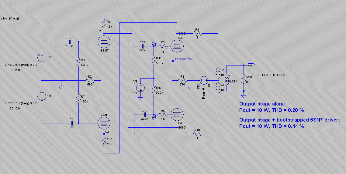

Very interesting driver with the neg. impedance loading (bootstrapped beyond unity). Does it oscillate without the global Neg Fdbk?
I wonder if "local" N Fdbks could still be added to the driver cathodes, without disturbing the 3rd H cancelling bootstrap loads.
In part, yes, but only to a smaller fraction. An even larger part of the H3 is cancelled by the x-coupled positive feedback around the final and driver stages.
No, quite contrary.
The output stage (with common cathode resistor) alone is more linear than the combination of the bootstrapped driver stage and the output stage.
So the "the x-coupled positive feedback around the final and driver stages" more than doubles the THD compared to output stage alone.
Attached the simulation results.

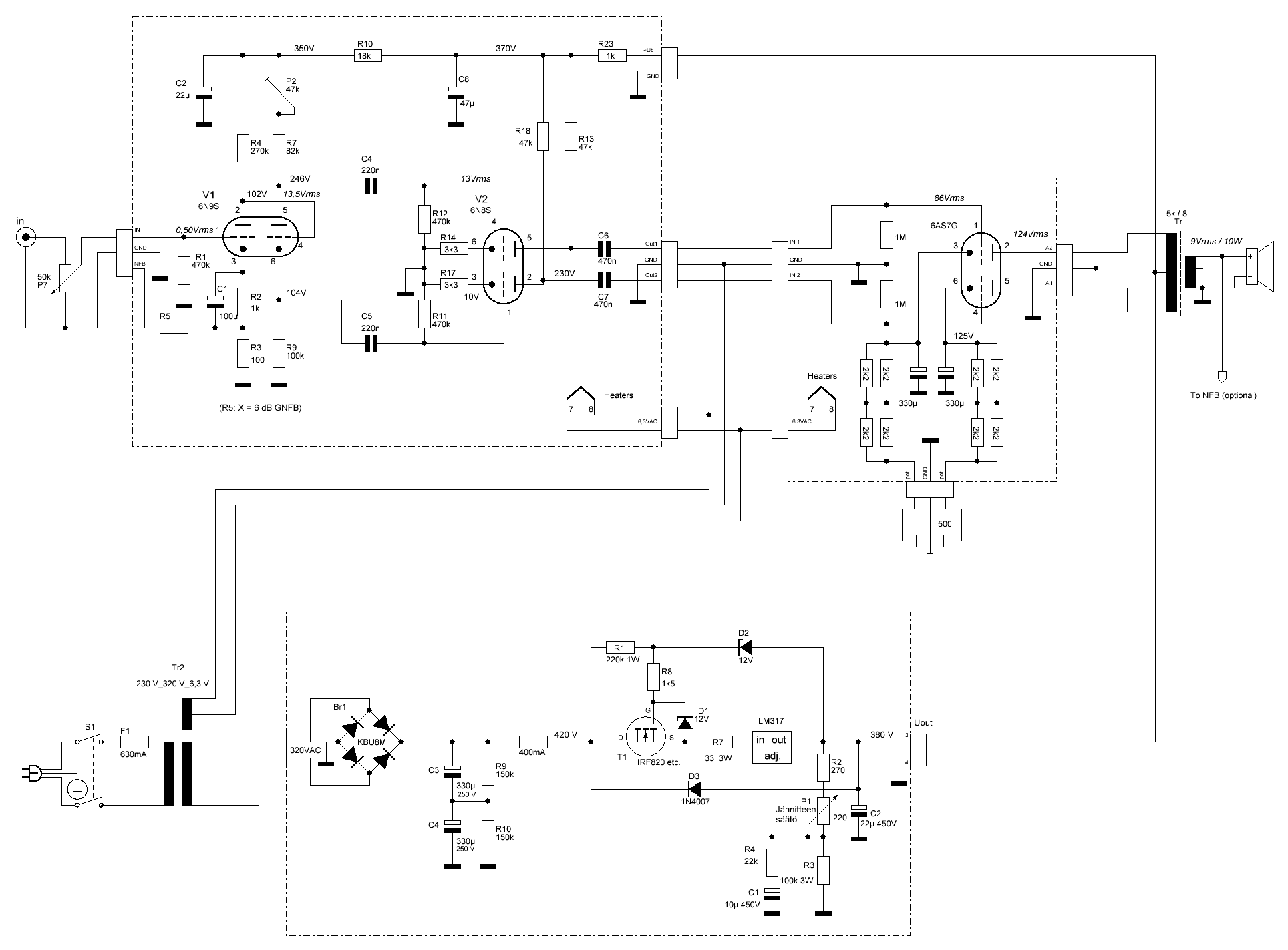

Please also note that my circuit also uses less overall GNFB
Your circuit has 11.8 dB of GNFB (R6 = 3k3), my circuit has 10.6 dB.
...my circuit keeps better power balance at varying loads than yours, even with less effective GNFB...
Please define power balance.

No, quite contrary.
It makes no sense to evaluate the combination of bootstrapped driver stage and the output stage in isolation. Obviously, the positive feedback boosts the THD inherent to the tubes. (It also re-duces the actual THD due to better load lines on the drivers thru another effect.) But then it also provides more gain, which can be used for more global NFB around all stages, which in turn reduces the total THD of the whole amp. This is a totally all stages integrated design. It doesn't make sense to just look on the single stages independently.
This view doesn't make sense. You need to take the inner positive FB into account as well.

It makes no sense to evaluate the combination of bootstrapped driver stage and the output stage in isolation...
What do you mean ”in isolation” ?
It is very important to evaluate the performance of the combined driver/output stage and also optimize it.
The valid design process is such that, at first the output stage is designed to work as good as possible. This means that it will be evaluated/simulated alone.
Then the preceding stage, already designed alone, will be combined to the output stage,
and this combination will be optimized to optimum performance.
Etc. Etc.
At first I must make a correction. The GNFB in my circuit is 11,7 dB (when loaded with 8 ohms).
The Global Negative Feed Back is the difference of open and closed loop gain.
In your circuit the GNFB is simply caused by the signal thru R6 (3k3).
The inner positive FB is out of this study.
