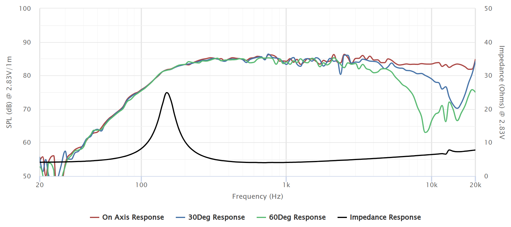

Yes, someone probably took a look at the Lewis.
The measurements are unfortunately not that nice, at around 3kHz a lot of energy is emitted into the room. And the TQWT is also not matched in a comparable way, but probably comes from a simple tool witch never works really well.
Certainly not bad for the price, but I would still invest a few more euros and build the Lewis.
