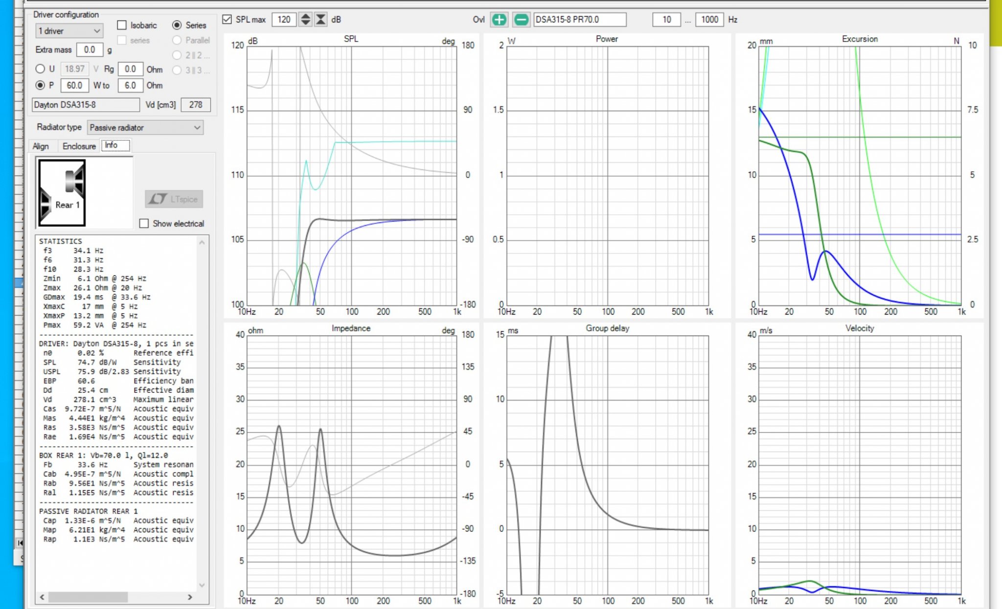

That makes sense. I purchased a 4x8 channel DSP, which has enough channels if I keep everything simple. (It was defective and is being returned, but I should have the new one soon.)
I had an idea for a more complicated arrangement that would use extra DSP outputs. It may be unnecessary or it may be a misunderstanding on my part, but...
Based on the idea that drivers in different locations in the room create peaks and nulls in different places, I wanted to send a combined signal to the subwoofers, which would be a summed signal below 60hz and a stereo signal above 60hz.
The idea is that both subwoofers would be playing the same low frequency content sub 60hz, and therefore I can EQ them individually so that they produce a more even bass response throughout the room. This is sometimes done in home theater with 2 or more subwoofers.
I took some measurements and found that when comparing the in room frequency response of my front facing woofer and the rear facing woofer of my cabinet. Their frequency response in room was different between 60hz and 200hz, so I can EQ them against each other in that range. But below 60hz they were identical. So I realized can't control frequencies below 60hz by EQing between the 2 drivers in the same cabinet. But maybe I can Eq between subwoofers in the two separate cabinets to control the lower frequency room nodes? It should work.
But there is one thing I do not know. I don't know if there is enough difference in the low frequency content between left and right channels to make it necessary to sum the two? If I can assume that the sub 60hz content is identical or nearly identical on the left and right channel, then I can forget about it and free up a DSP channel.
I do know that vinyl records used a summed low frequency, because otherwise the needle would jump too much. But it stands to reason that there won't be much of a difference in the low frequency between the left and right channels in a modern recording.
I've done a few sims and the WCW orientation has better directivity than the CWW format if you're crossing between 200-300hz. This depends on what you're willing to accept in terms of speaker height, but otherwise you get these ugly floor bounces and woofer combing.
One of the woofers in my design is actually a passive radiator, so I assumed it is not counted as a woofer? I assume that would change the simulation you are describing.
The best info I can find about PRs seems to agree that the PR doesn't create any significant output above the tuning frequency. At the tuning frequency, the PR is making most of the output, not the driver. So the PR should not matter in terms of it interacting with the coaxial?
I am planning on crossing the coaxial to the woofer at 250hz or lower,and the PR shouldn't be doing anything at that frequency. So the only thing that should matter is the distance between the woofer and the coaxial.
The PR shouldn't be doing much of anything until somewhere around 60hz, and there won't be any 60hz content coming from the coaxial driver.
But I am by no means an expert at any of this!
I missed that! You're right, it will act like a 3.5-way with the PR working out of phase to produce extreme low frequency. I'm used to seeing them on the back! This tends to help disperse out of phase noise in the correct direction-- backwards. Because it's more or less in phase on the reverse side, it creates a bump instead of a null. This can be EQ'd out easily with a high Q PEQ filter, whereas filling that void with an equalization filter would be much more difficult. This all, of course, depends on specific drivers, boxes, and arrangements. None of these are hard and fast rules, but it's consistent with data collected from Erin's Audio Corner. Worth looking into.
Is that really enough passive radiator? Most of the time, with similar suspensions and surrounds to the woofer, you need approximately double the radiator surface area. Usually this translates to one "size up", like a 15" PR for a 12" woofer.
This is a rad project. I really hope it works out.
According to the simulation the PR is enough. The woofer has 5.5mm Xmax, and the PR has 13mm. So the PR has slightly more than 2x the displacement of the driver.
I'm not sure about the phase of a PR. The common understanding is that the PR is out of phase, but I've read several forum threads where people are discussing how PRs are out of phase, and then someone who seems very knowledgeable shows up and explains that actually the PR is always in phase. I am leaning toward the latter point of view, but I don't actually know.
I think the simulation looks fine. Below is the data in a 70L enclosure. My previous drawing showed a 55L volume, which results in an F3 of 39hz and a +1db peak between 50 and 60hz.
