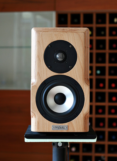

The initial diffraction attenuation I was going for was rounding over angle with a radius of between 18mm & 22mm (with a router) maybe in the future I could be doing bigger curves like with the "Kerfing" method but I have to practice that. Trapezoidal front face do not seem easy to do as are smooth transition curve around drivers, well at least for me, do you have an example of something better that could be done ?
Of course if you can't go wider with the design (or aren't willing to), you are somewhat stuck with what you can do practically speaking.
The Tafal's round-overs look about right for the basic design discussed earlier:

The design on the picture look like a large chamfer (3/4"?) with some round over of the edges, the router bit I have should allow me to make something more like a 1/4 of a circle of a radius on a 18mm panel I think, I can go up to 22.2mm of radius but that create a small inset that I would have to remove with sandpaper. Is that better or worst concerning diffraction ?

-the larger round-over (chamfer) looks quite a bit better.
Of course diffraction is all about angle (vs. freq.s and diffractive area) - the steeper the angle the greater the diffraction.
I'm assuming that VituixCAD has a good diffraction simulator that will provide a good idea of the result, rather than me saying (cave-man style):
".. hmm,
MORE WIDE-ROUND,
BETTER."

Ho yeah I know you have a great provider on wide round angle, I'm sure that this would be better, but I have no way to practically do that, and then what do you do with the top edge, unfortunately I have to be realistic about my skills, and even then I am yet to succeed in doing the simplest.
And then I have to find out also about correct bracing, and damping, nice flush mounting, finish, no really I am in for some difficulties.

Bevels and rounds are not so difficult with thick MDF: SP44 FRONT PANELS
Also side walls can have thicker parts in front which enables even more longer radius or bevels.
I see it do not seem that complicated indeed but It's difficult to know what the effect of the big bevels have without a direct comparison, .I have looked at other cabinets he made that are without that design and the flatter sharp edges seem to be "a bit" more curvy like this one : SP38/13
This one have roundover more like something I was planning to do but I don't know how to make curved sides like he did :

If I breakdown that design into what each choice do matter most, I can't tell yet. (maybe come from experience and tests) :
- Is it breaking the 90° angle in less steep angle between front and the sides, the SP44 edges are not much rounded
- Is it the shorter baffle size around the mid & high
- Is it mid & high drivers are out of axis
- SP44 is around 1500€ worth of drivers, that may help also.
And your answer will probably be all of those matter, but in what proportion is something I'd like to understand
Do you put any driver in that cabinet and they all behave at their best or is it conscious decision to apply that design to manipulate the response of those specific drivers, the latter would imply that you have build up some knowledge about what each of the choice is going to represent in the final result, or like you said before; Know your target.
Looks too flat bevels and short radius to be "everything possible is done". Probably not much difference to original - especially at mid-range. Should be multiple and more thick bevels + at least R=35mm rounding in every corner for tweeter (also with bevels).

Well the SP44 used a 32mm front panel have a 25mm difference of chamfer, I could gain on it, I pictured this one with a 36mm front and a 18mm difference, I could increase it by 8mm is that what you mean?
I don't understand what you mean by rounding the corners for tweeter, the tweeter recess is for the waveguide it has to be square, and if you speak of the roundover for the other version of the front baffle, my round over bit is max R=22.2
Ok thanks I take note for that crossover possible issue between W & M
Haha yes good idea for the casters brakes
I was talking about tweeters without wave guide. Didn't notice that your tweeter has wave guide. So mid-range is main target of anti-diffraction project.
