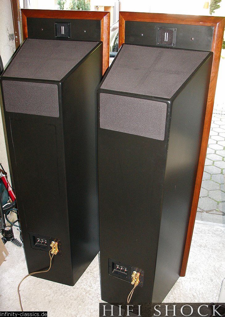

I just stumble upon that IRS Sigma baffles and the implantation with the dipole planar reminded me a bit of the design of the cabinets here :
Infinity Reference Standard Serie
Also is the the design of the front baffle that does not come flush with the back is something that work in general in regards to diffraction ? (I do not mean for the design now but more in general)
Feet recoverd quickly (or mostly so). Unfortunately that meant that my free time was required for that garage redo among other activities (..and I say "redo" now instead of clean-up - because that's what it has become.)
![boggled :boggled: :boggled:](https://files.diyaudio.com/forums/images/smilies/boggled.gif)
Only a bit like the Infinities.. (the tweeter is open-baffle - which is different, and the midrange "enclosure" isn't quite the same either because it appears as if not only the rear is "open" but the "top" seems to also be open.)
I think they did that for several reasons: aesthetics (panel-look Infinity is known for), reduced reflections for the rear tweeter, reduced resonance for the mid. enclosure (even though it's only a 3-sided "enclosure").

Yes I did noticed the differences, difficult to understand and imagine result of that kind of enclosure as anything coming from the back must be out of phase, does it deliver a kind of sound that is slightly akin to reverb effect ?Only a bit like the Infinities.. (the tweeter is open-baffle - which is different, and the midrange "enclosure" isn't quite the same either because it appears as if not only the rear is "open" but the "top" seems to also be open.)
