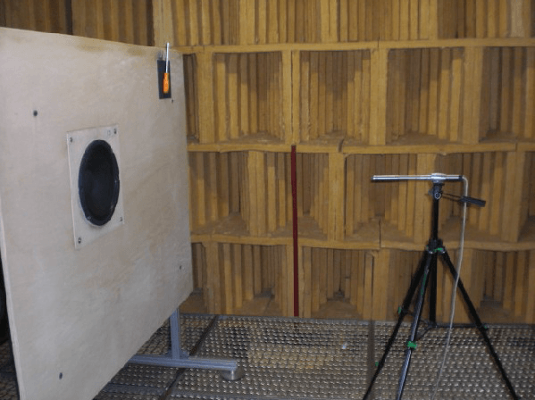

Well, in the end I don't really understand the principle behind that setup for the measurement, but that is to be expected.
I have noted by searching online that often I find measurement done with the driver already placed in a cabinet, and the few I see where the measurement is done with a large front panel they don't write much about it.
Article : Speaker baffle design, diffraction and baffle step – Audio Judgement
In the linked article find some things my brain can process, I don't know if it's accurate.
By going with a to measure with a large front panel are we avoiding that the edge diffraction of the higher frequencies and back firing waves "pollute" the measurement ?
I was supposing with any panel size and edge type it was possible to interpret the frequency response and compensate the reading, but from what you write it seem it is not that simple.
The other problem I see if I get what you are writing right is that in practice my drivers will be placed at the center of that +-5x5 that mean it will effectively have the floor +-2.5 feet from center (You ask for 4 feet).
Would it not be possible to play with a front panel that is the size of the actual cabinet project, close the sides of it and use some absorbing material at the back to eliminate some of the back firing waves?

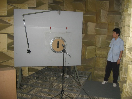

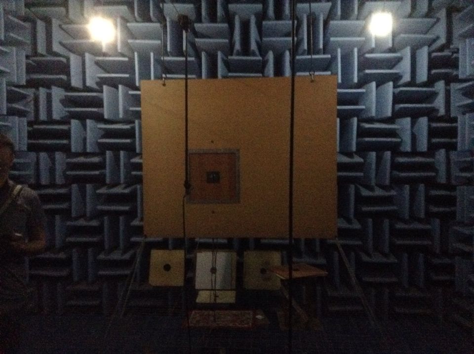

It's not that simple.. but it doesn't have to be particularly complicated either.
The "IEC" has several baffles for testing. (see the pic. below.)
Just remember that you are mostly interested in freq.s above 1 kHz.. for typical domestic (far-field) measurements.
BUT you want your windowing (reflection free zone) more than an octave below that if possible. (..windowing introduces artifacts to the measurement for an octave plus above it's freq..) So ideally you want your window to be lower than 500 Hz.
Yeah, you need to lift the test baffle off of the floor (stand) and have the driver almost equidistant from floor and ceiling. Alternatively you can stack pillows at the bottom of the floor. Or you could do a ground-plane measurement. (..you'll have to search for that.)
Measuring on a speaker cabinet already assumes the speaker is "the" shape: it takes a huge "chunk" out of the process of loudspeaker design within a modeling program. What happens if that's not the cabinet shape that you want for a really good design? ..or (particularly) the driver isn't placed in exactly the same position you want for a really good design? It's an ***-backwards way to design a loudspeaker.
Note: with the off-center position and measuring off-axis: measure off-axis toward the most distant point of the test baffle. Ex. in the pic. with the gentleman off to the right of the test baffle, you would move the mic./mic stand to the left of the board (using a protractor + ruler to get the right angle and distance from the driver being tested). This is for omni sources where you need only one group of angles out to 70 degrees (or so). HOWEVER for your little line tweeter you might want to test it again the same way/mic position but a second time with the tweeter rotated 90 degrees (on the test baffle) so that you measure the vertical response with the same amount of baffle. (..however there should be little practical difference with the measurement so high in freq..)
-btw, nothing says that the baffle need be made of wood. I've done it with small driver-mount area of wood and the rest of it with damped cardboard on a rear frame before.

The unfinished rig :

I"m back from my trip
It resulted in a pretty big change in my life hopefully that will not slow down too much this project.
I am at the moment thinking about the router model I will purchase, I could settle for a dirt cheap one but at the same time I think I could also use it in the longer term for other wood-work tasks so not decided yet.
In parallel I am thinking about the design for that test rig, I want to go for total size of horizontal of 8 feets and 6 feets vertical, the main board will be 4'x4' in MDF and the other parts in a lighter rigid material that I didn't found yet (sandwich panel?)
For the inserts it I think I have it right, I will make a square of 13.77 inches with a lip that will be held in place in the back with some toggle clamps, and for small drivers I will make another insert of 4.72 inches into that bigger insert also held with clamps
I started with a basic structure but I quickly realized it was not going to be practical, the design issue I have is to make a structure to hold everything together that is removable and easily stored taking a minimum footprint when not in use.
If you still have time to answer I have a few questions :
1- I have seen on a few pictures of similar test rig that the insert is not in the middle, I suppose it's to evade that square effect in diffraction, should I do that ?
2- Do you know a small amplifier that I could use instead of every time having to unplug my main home one?
3- My noise floor can can reach 50dB, what is the acceptable lower limit dB to measure the with the sweep so that I have enough headroom that the test is not impacted by ambient noise ?
