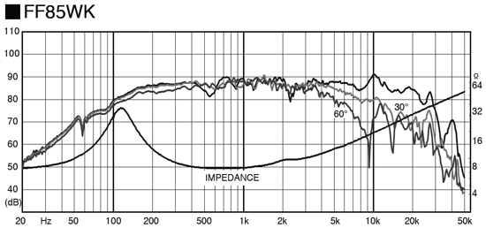

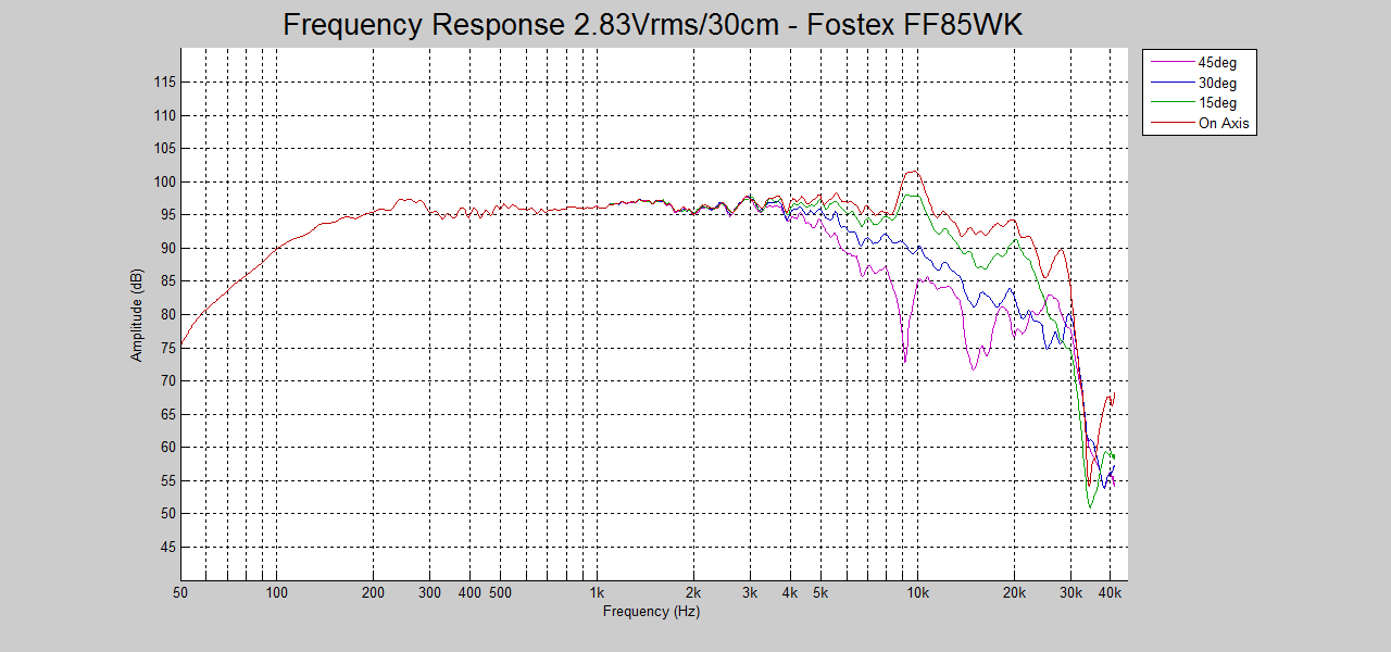

There will of course be some variation in Fostex samples:
1st is spec. sheet
2nd is independent w/ 1 kHz at about *86 db w/OUT baffle effects and 88 db at 3-5.5 kHz where you'll get some oscillation from diffraction (higher and lower spl). Diffractive gain below 1.8 kHz should raise the response to almost match that 3-5.5 kHz region.
*compensate by dropping the pressure 10 db from what's shown.
THEN there is the contribution of the Gradient and Tweeter (if any) that will "lift" (increase spl) that result a bit, and insertion losses that will lower it some as well.

One other thing; how did you calculate the loss in dB from specs 2.83V/1m from the other 30cm 2.83V/30cm for the Fostex measurements ?
It was Tim's (educated) guess, and actually I think he spec'ed -10.5 db, not -10 db.
Of course at about double the distance (30 cm to 60 cm) the "average" would -6db loss. 60 cm to 90 cm would be -3db. 90 cm to 180 cm for -6 db, but it's only 10 cm (from that 180), so about a 5+% loss of -6db or slightly more than -.3 db. Total around -9.3+ db..
Critically though, the testing was NOT done to find a 1 watt 1 meter response, but rather just the linear response and axial response when compared to other drivers tested in the same manner (and even to show overall pressure differences between those drivers). In other words I'm not confident in the outcome presented.. but then again, I'm not confident in Fostex's either.
I'm not even confident in the merged response on it's own, and in that respect I am reasonably confident in Fostex's overall response (..how it behaves relative to the average below 1.5 kHz).
Basically clear as mud!
In any event you still need to make your own measurements, because relying on anyone else's data can get you into "trouble".
