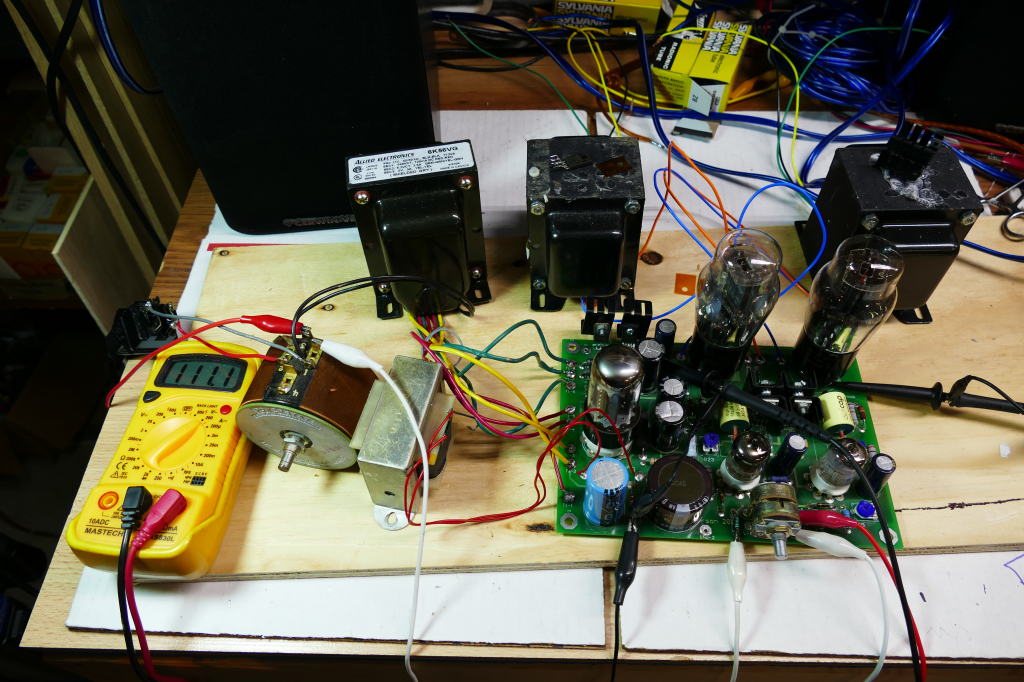

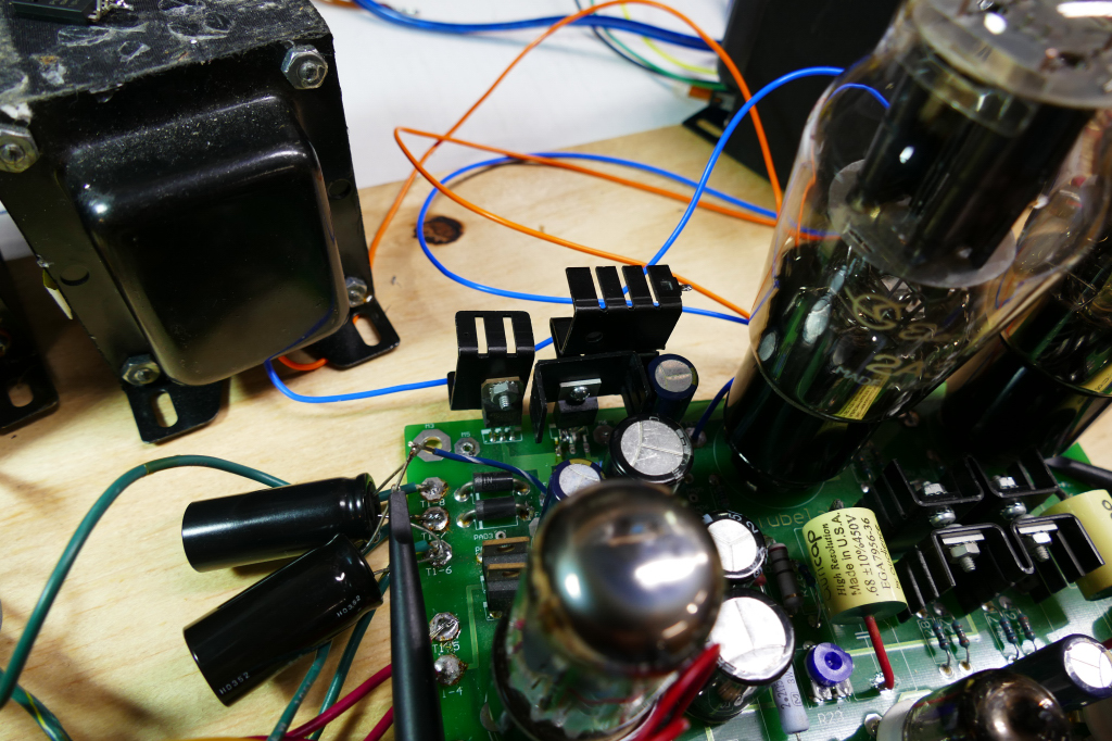

I set up a quick bench test system to evaluate regulator chips. Please do NOT duplicate my rather crude and unsafe test setup. There is exposed line and B+ voltage everywhere.

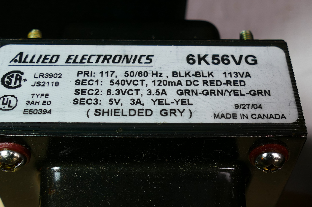

The picture shows a TSE board on a piece of plywood with a small Allied 6K56VG power transformer which is a good choice for a 45 board. There are a pair of Transcendar 3K ohm OPT's which were designed for a 300B amp, so I put the 8 ohm speakers on the 4 ohm tap for a 6K load, and a power supply choke robbed from a HP audio oscillator.
The tubes are 1930's vintage RCA 45's. The entire board is connected to a small variac with a DVM across it's output for applied line voltage measurements. A dual trace scope is used to monitor the raw DC voltage out of the filament rectifier and the DC voltage at the filament pin of the right most output tube. An iPAD is used for a source, and a pair of really inefficient Cerwin Vega HT satellite speakers are used for quiet listening.
I removed the stock dual heat sink that is fitted to both the filament rectifier and regulator and fitted small individual heat sinks to each part. This makes swapping regulator chips a bit easier. Note the melted green wires caused by dropping a 4-40 nut from one of the heat sinks on to a live board. It landed right on the exposed leads on the left side of the diodes. Smoke ensued, then the middle green wire unsoldered itself and the amp kept right on playing!

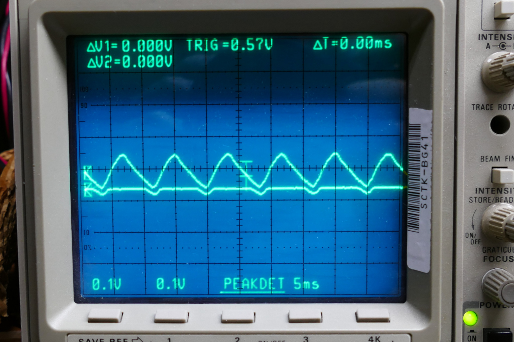

The amp was playing music while the line voltage was adjusted for the lowest line voltage that produced PURE DC at the tube heaters. Note the first picture of the scope screen. The vertical scale is 1 volt per box. The DC line (bottom trace) is at 2.45 volts, while the top trace shows 3.3 volts average with over a volt of ripple.

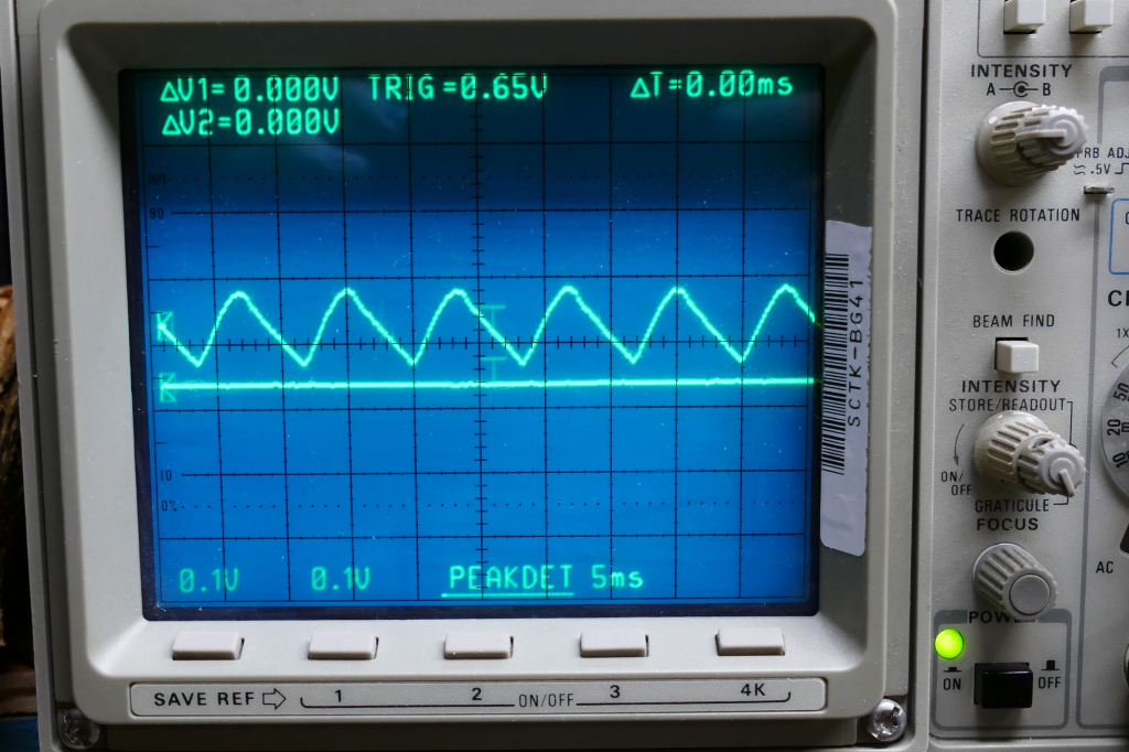

I then reduced the line voltage until ripple was seen on the tube filaments (second picture) and then turned the variac back up until the ripple just disappeared (the first picture) and recorded the voltage.
The voltage required for zero ripple with the 5 Amp Sharp chip was 114.1 volts. I installed the 3 amp Sharp chip and performed the same test again. The voltage was 114.4 volts. Slightly worse, but two identical chipps could have done the same thing. The voltage difference between the two traces is known as the dropout voltage, and both Sharp chips perform significantly better than the published spec.
This shows that the 3 amp Sharp chip will work in the TSE board. Obviously it will not power a pair of 2A3's (2.5 amps each) but 45's (1.5 amps each) and 300B's (1.2 amps each) should be fine.

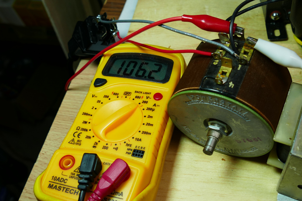

I put a new 2005 vintage cap in place of a well used 2005 vintage cap, and it did make an improvement. The line voltage for dropout went down to 111.1 volts. I turned everything off, and revisited the amp this morning. The voltage needed for dropout was now 109.9, virtually the same number.....
If one cap is good, two must be better, right? How many of us have Aux caps on our SSE's and TSE's? So does two caps work better than one, you bet! Voltage for dropout is now 106.2 volts.

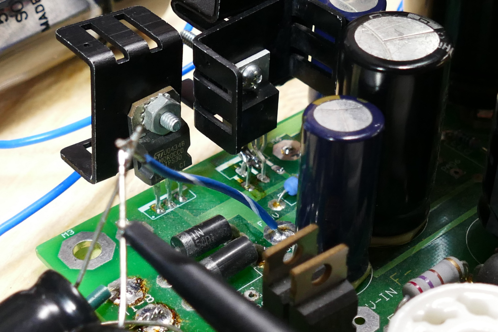

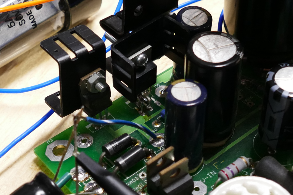

Now it's time to rip the board apart. I have 3 different regulators from Microchip / Micrel that all share the same pinout. They are the only parts I can find in a leaded package with a sub 1 volt dropout.
It turns out that with some creative lead bending, you can fit these chips into the existing board without cutting any traces or running any jumpers. I stuffed the best ($8) chip into the board and plugged it in. There was 2.52 volts in the tube socket, without any output tubes, so I popped in my 45's and cranked up the tunes.
It plays fine, but the dropout voltage went from 106.2 (two caps) to 107.8, a considerable loss of ground. If this is the best chip, what will the cheap chips do? I don't know yet....I'm going to beat on this one a bit.....OK, a lot. For 8 bucks each it should be bullet proof, and maybe even conjure up some audiophool magic!

I was thinking about how to torture test the new regulator when a reader asked some questions about a TSE for 2A3's. Suddenly the light went on.....What would happen if I simply stuffed a pair of 2A3's into this amp as it site. Would the remaining smoke get set free from my power transformer when I ask it to give me about 6 amps from its 3.5 amp heater winding? What would the Microchip regulator do when it looks at the near dead short presented by a pair of cold 2A3's. Well there is only one way to find out....plug them in!
When the plug hit the wall outlet there was a thud from the transformer. The filament voltage moved up to about 1.5 volts then slowly climbed to about 2.2 volts and stayed there. My variac was still set at the same place where I got 107.8 volts with 45's, but now I'm only getting 105 something, so crank the variac up full, 122 volts (its cold outside). The filament voltage levels off at 2.51 volts, and music plays. It takes 119.5 volts to keep the regulator out of dropout, but my 6.3 volt winding is only making 6.0 volts.....and this IS a Hammond built transformer(notorious for too much voltage).
If one cap was good, and two was better, lets try THREE! Bingo, The board was happy dropout voltage was 112.3 volts. I put the speakers on the 8 ohm taps, set the bias for 60 mA (again sucking about 140 mA from a 120 mA HV winding) and listened to some good sounding music......for about 5 minutes, then silence.
I suspected blown parts, but the Microchip had simply shut down. I had used the tiny little heat sink shown in the previous thread. I simply screwed the original double heat sink and the tiny new heat sink together and used that. The amp played all day. Within about an hour the power transformer got too hot to touch, but after about 8 hours of stress, no smoke was released.

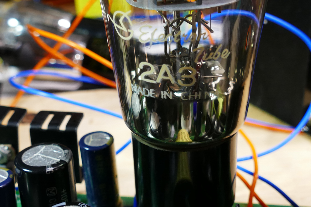

I still haven't tested 300B's, and I want to try the 2A3's with a real power transformer. I dug through my collection and found a Hammond 372HX still in its box, never used. This will feed the 2A3's too much B+, but who am I, Captain Red Plate?
