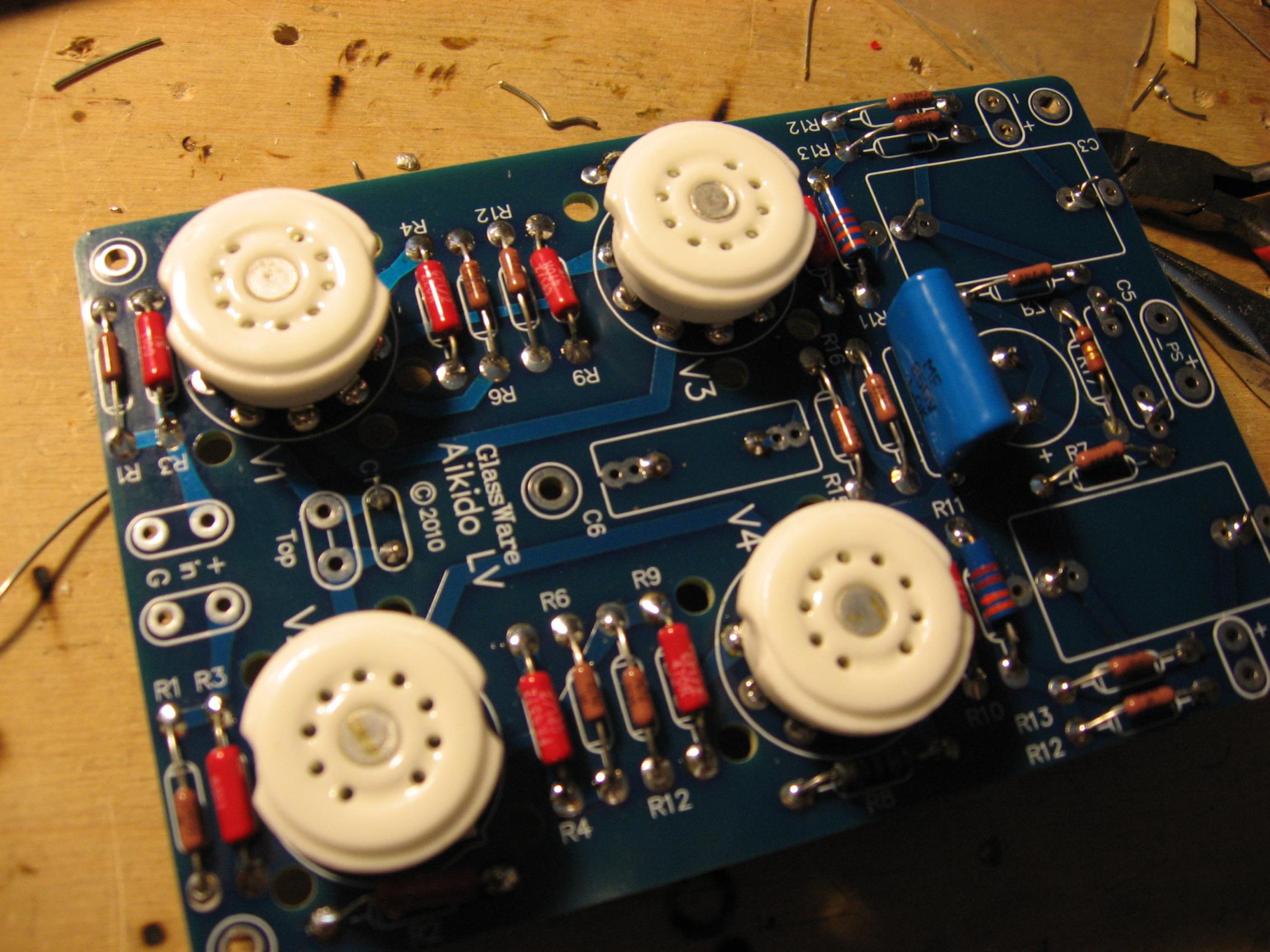

Okay, this is pretty much my first foray into tubes although I've done my share of DIY on other fronts. I've got an Aikido LV w/ 12BH7 and 48v .52A Jameco Meanwell wall-wart. I powered it up, nothin' happened, then I realized I forgot to bridge the heaters in series. Did that on the 'test bench' and things got a-glowin' okay. When I moved the Aikido over to my gear and powered up (admittedly with the switch on already), nothing. And I haven't been able to get anything to happen since.
The board is simple and I've looked over the solder job and wiring and PS, etc. I've used my DMM and get 48v exact reading from each tube, so something is happening. The tubes are rated for 300mA or so current so my wall-wart should be okay, but I am totally stumped. Any ideas? I got no glow, no nothin' after that one time.

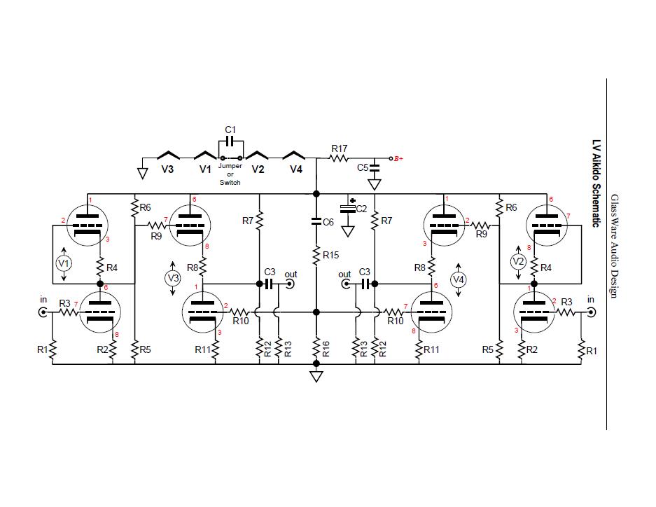

Here's a pic of the the circuit. This is a PCB going straight to a 48v wall-wart smps (linked in the first post), so I'm not sure if turning off the HT separately is do-able. It's late so I'll have a go later in the morning.
If you are measuring 48v from the PS to all the heater pins that means NO current is flowing. I would imagine that R17 is open.
I don't see a jumper at C1, it won't work without a jumper or switch there.
Hi Bill. That pic was just for show, taken before all the wiring. The jumper is in place now. I will check out R17...
Now we see Low voltage Aikido.
You don't need the 10 Ohm. R17 does the same job! If you check from ground to junction of R17 and V4 heater then at junction of C1 or link you should have approx half the voltage of supply. If you have full supply then V1 or V3 is open. If this is OK the check between V1 & V3 heater. The current drawn should give a voltage drop across each of the valve heaters.

Thank guys! I swapped in a 2.2Ohm 10W Eagle resistor for R17 and now they're working. I'm reading 11.8v between heaters and 25,2v at the V3 junction... Is the 2.2 an okay value?

I'm sure the turn on surge took it out, 1/4 watt was pretty iffy. A 3 watter would be plenty. The voltages across each tube wont match very well but anything close should work fine. Someone a few years ago did conductance tests on a few different tubes at different filament voltages and concluded that most will operate properly well below their rating. There is always a chance that one will not though, but you should be within 5% as M Gregg said.
