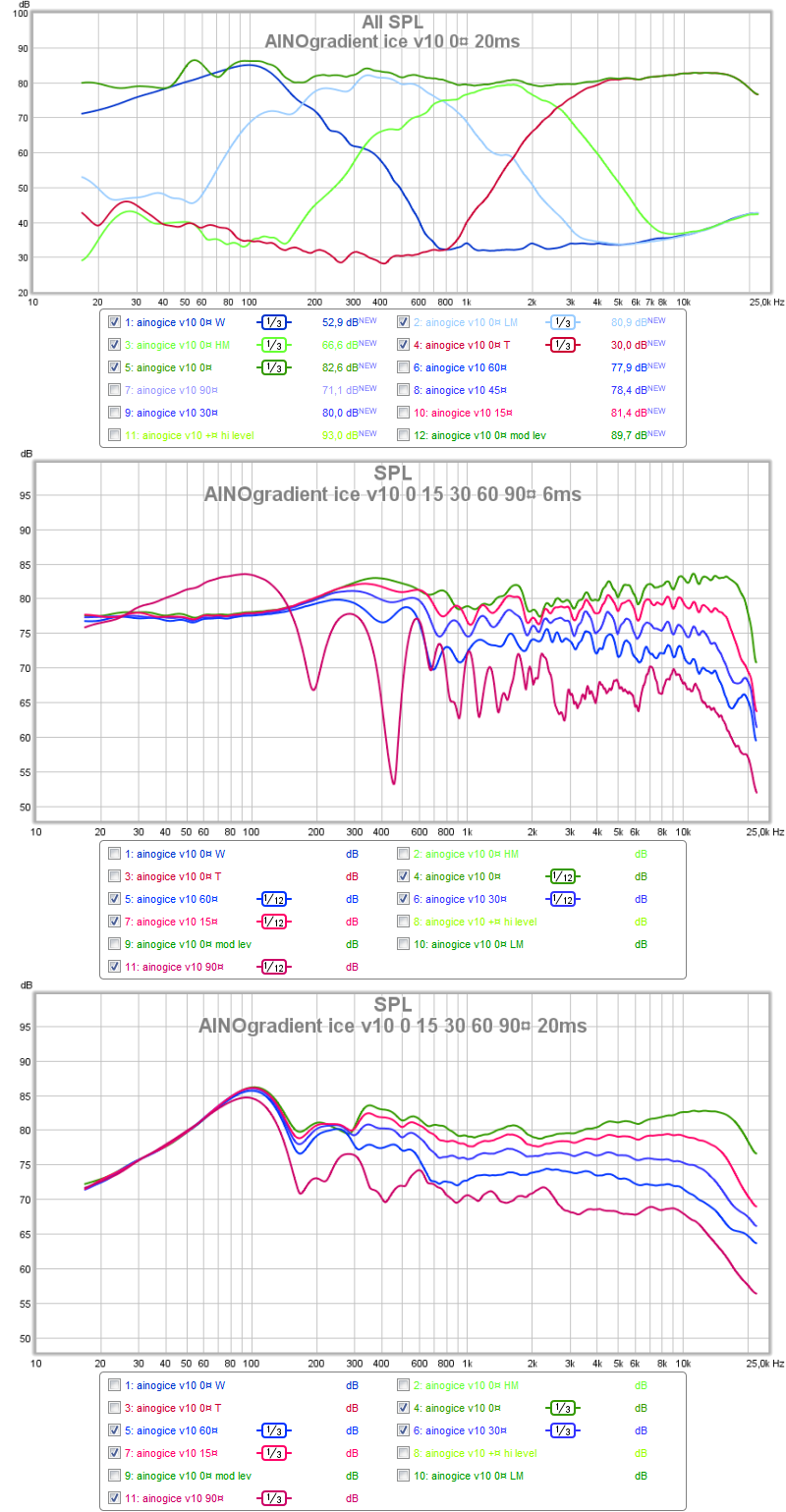

Edited my measurements a little,

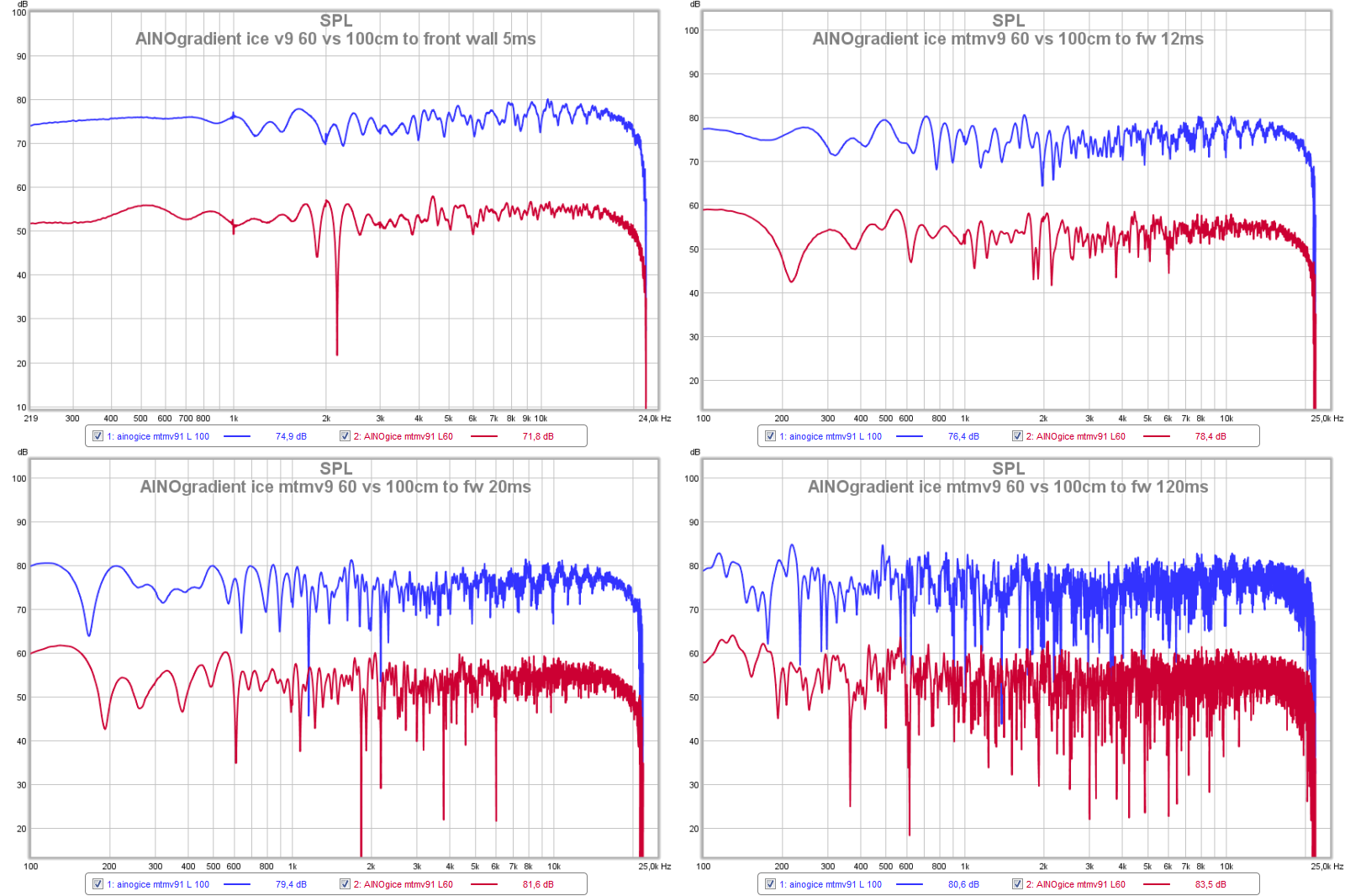

Distance to front wall
Mic position same, position of speaker moved 100cm vs 60cm to fornt wall. Horizontal angle a bit different but not significantly. In both measurements speaker is roughly at 30¤ angle to wall and 5¤ to mic (left speaker of stereo pair, mic at hot spot). behind the speaker is a window, which presents the WORST possible material.
My analysis. The effect on bass is not shown here but it is as loudness boost below 100Hz. The dipole radiation range of AINOs is 200-3000Hz, but I can't see any really big problems with these positions. Cancellations are more significant at 60cm but I can hardly hear any changes except low bass. Obviously nasties increase exponentially as distance gets even smaller.
60cm to front wall is the everyday position. For solo hi-fi sessions I just drag the top-gymnast 42kg AINOs to 100-110cm off the wall! Dipoles should always be toed-in at least 30¤!

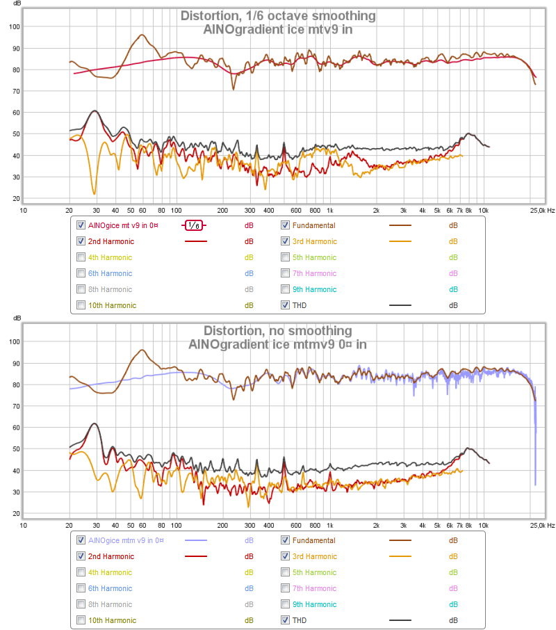

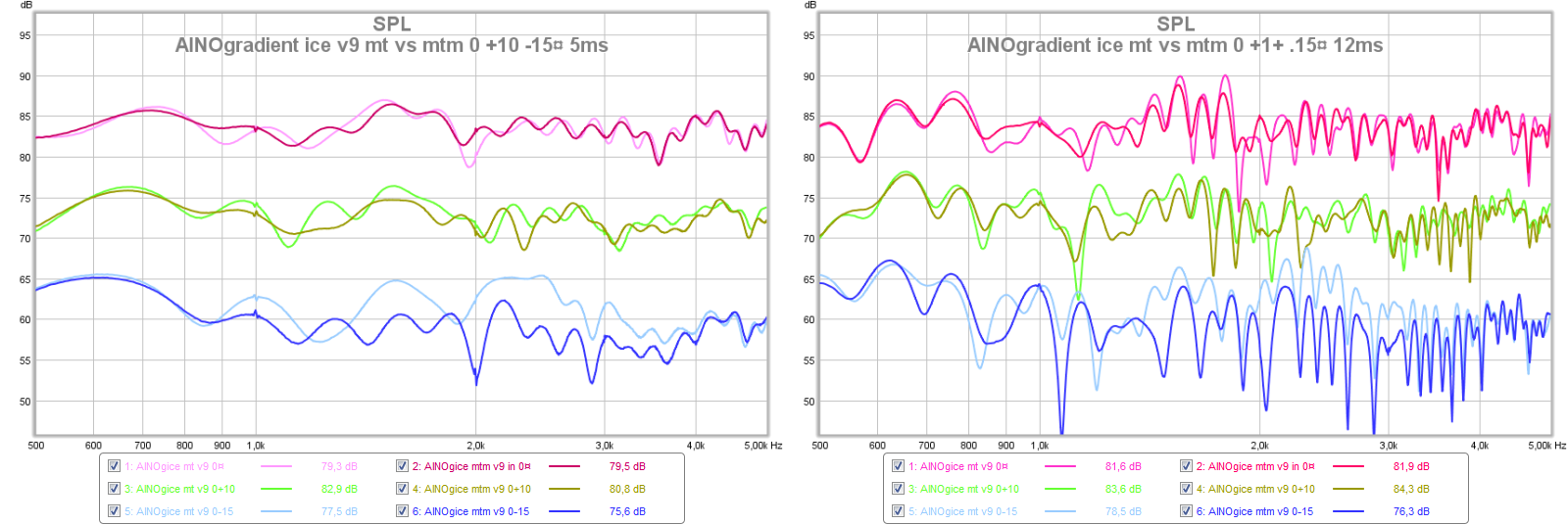

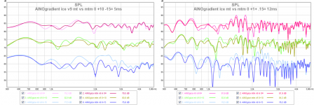

MT vs MTM
Previous measurements edited and distortion test.
Previous vertical offset measurements get a closer look here, without smoothing but different IR windows (postprocessing in REW) Only the lower and upper mid(s) and tweeter playing in these measurements. XO frequencies are 1kHz LR4and 3.3kHz LR4.
Analysis: There is a difference but I can't say which is better overall. MT is better around 3kHz but MTM better around 1kHz.

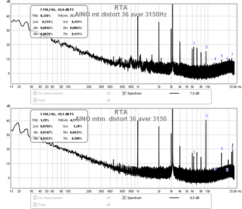

Distortion with only a single or two upper mid playing, sine at 3150Hz. 36 samples. Please disregard 1kHz and its harmonics, they come from the defective sound card.
Analysis: M is significantly better, mainly because of high odd harmonics of MM
Note: I must perform more distortion measurements after changing the soundcard of UMIK-1. Distortion is a known problem in one batch of them and I got a replacement free. I just haven't changed it yet.

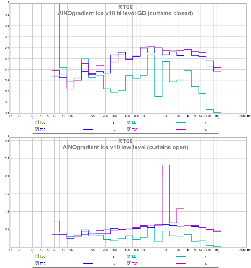

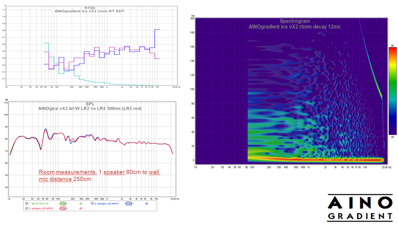

RT and EDT of my room - the effect of closing the light curtains kills the resonation at 2kHz.
It is now obvious to me that the 2kHz undulation I hear is very much this window resonation. These indoor tests don't tell the real behaviour of the speaker! Windows and furniture are rattling too! I haven't fixed the lower mid driver very well - it has vibrations around 100Hz. But overall the system looks solid. The weather doesn't permit outdoor measurements now.

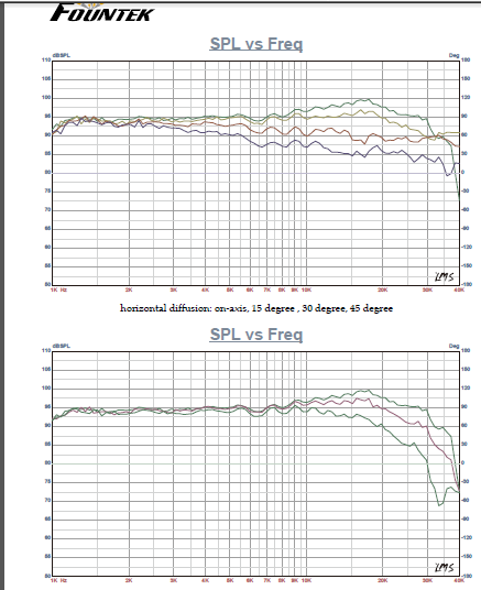

Fountek datasheet says that Neo3.5H has an impedance flattening circuit built-in
http://www.fountek.net/uploadfile/1011/25100645.PDF
Ih has a special off-axis that made me to choose it!

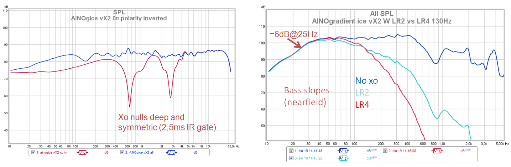

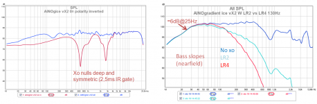

About bass performance, I took some nearfield measurements and here you can see the options of LR2 and LR4 at 130Hz. -6dB in nearfiel is at 25Hz. 300ms room response start at 15Hz if we believe UMIK and REW! The bass channel of minidsp has Linkwitz Transform type peq at 40Hz, Q=1, -6dB (to avoid digital clipping) Driver is SEAS L26ROY in 25 liter sealed cabinet.

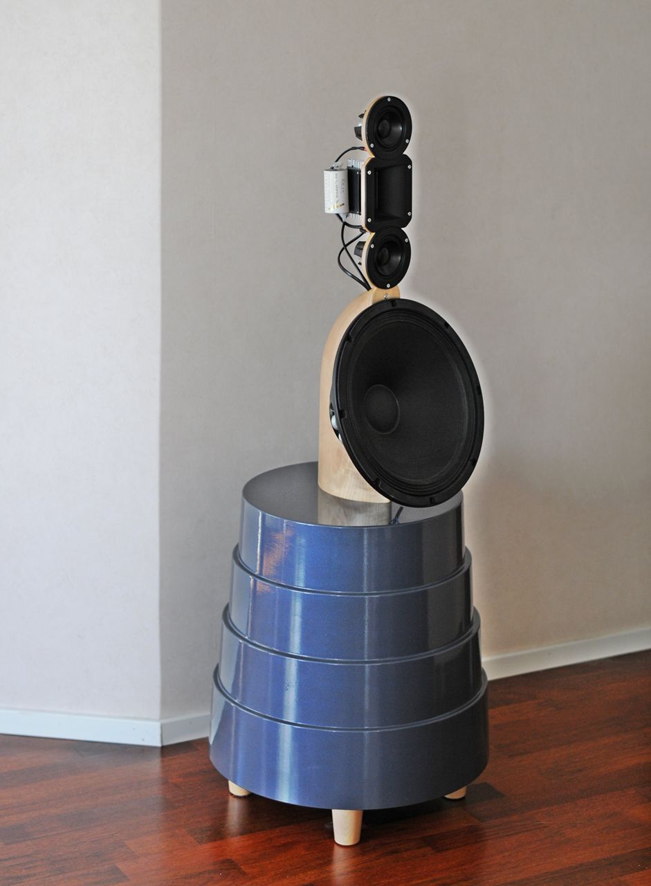

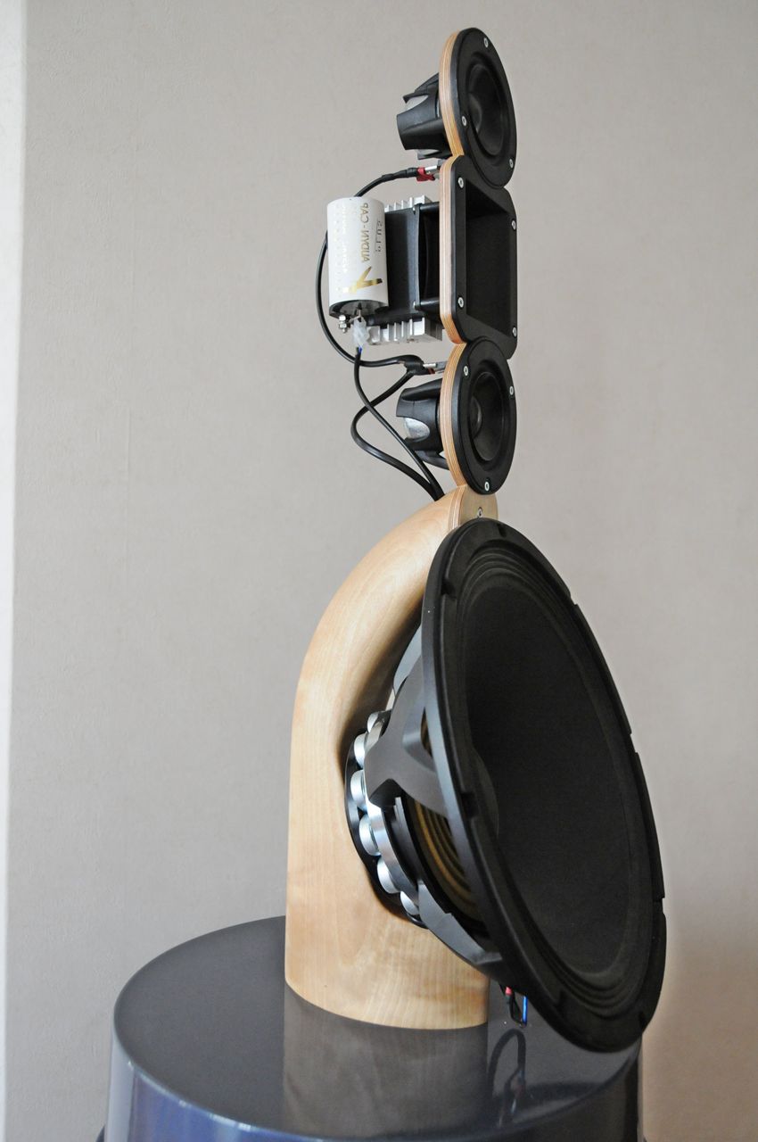

Juha,
Your Aino is a beautiful artistic statement piece (suits a Fin).
But from an audio point of view, it would be better off if you kept the sub and dipole as separate units (just my opinion).
This would allow you to better place the subs in the room.
Also you would be more free to experiment with the dipole design.
For example, a swinging dipole design might sound better.
And I agree, largeish nude drivers ring a lot when driven below 200-300 Hz.

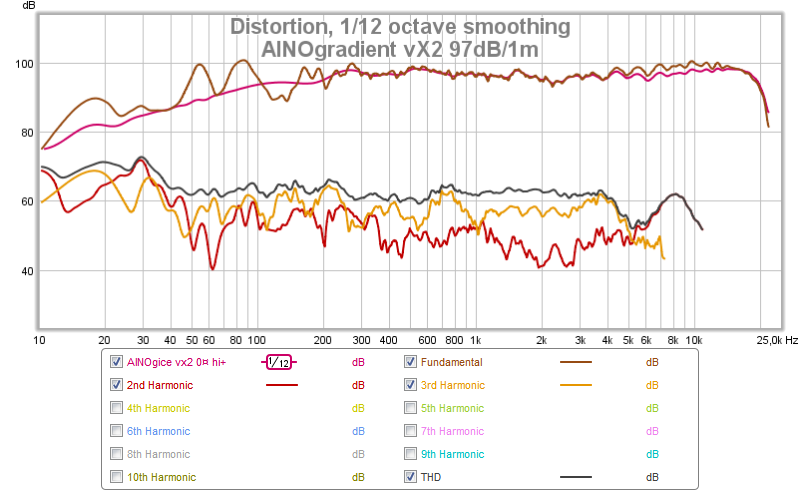

zmyrna, I went back to lower xo and there are no problems with distortion, when crossing at 2500Hz LR4. The horn obviously helps a lot in comparison to 3.0. Parallel mt is no-no - strong unsymmetrical (L to R) lobing. T/MM (a triangle) might be worth doing?
Aino at 97dB/1m distortion, measured indoors at 1m distance. T xo 2500Hz LR4

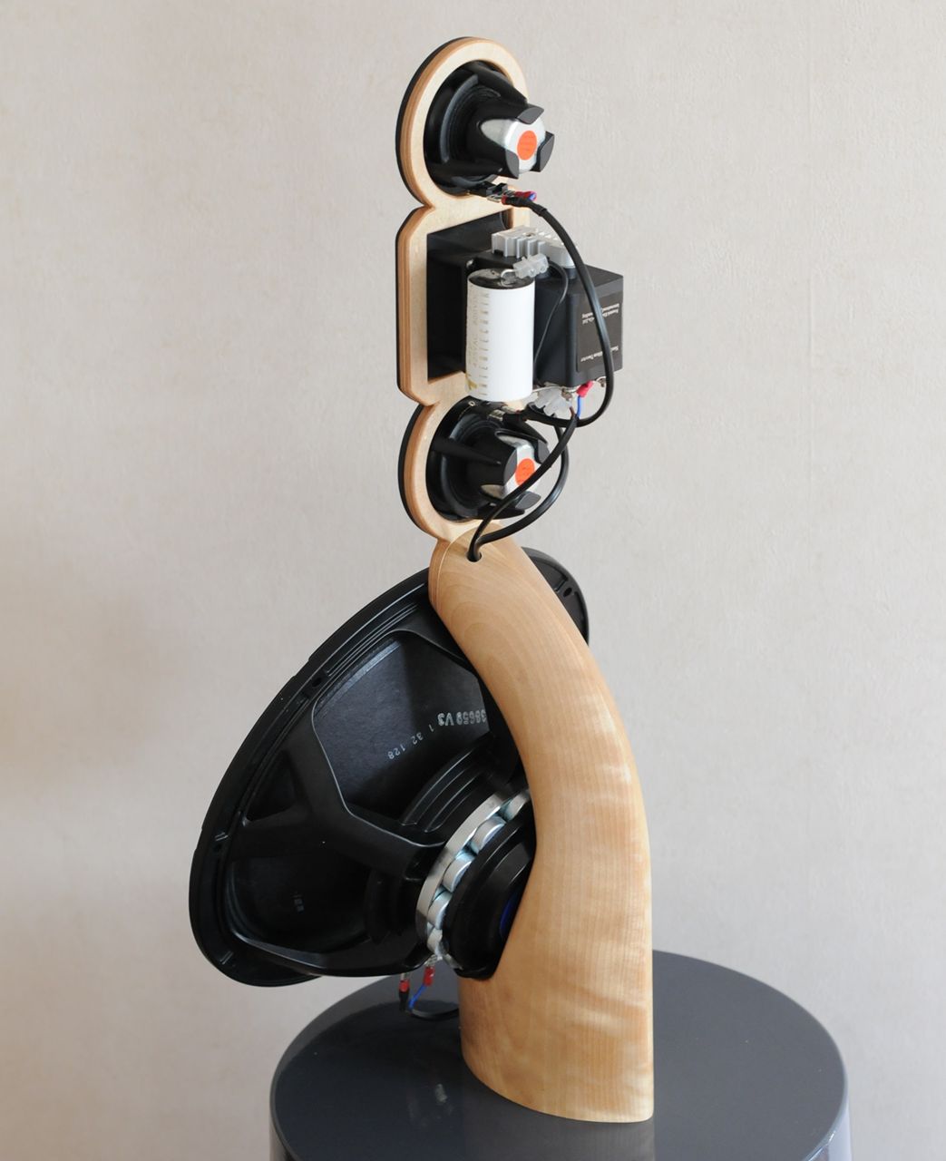

Due to the 3.5's height and the narrowness of the BG8's this would be difficult to pull off. BUT, if we were to lay the Neo8's sideways with the CD3.5 between this may work when crossed <2.5k. Perhaps even better would be to have two Neo8's horizontal above and below.Juha,

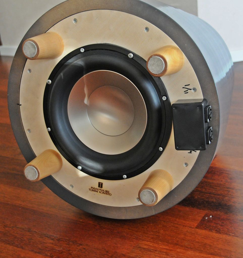

About bass, I am very pleased to have two woofers covering 20-150Hz. My previous speakers were mostly used with one subwoofer xo 80Hz. Two low-going woofers are better in my room! The ideal system, I believe, would be a multisub ala Geddes for below 80Hz, but that is unrealistic for me in my living room. In my HT I have two subs, three would be better but I don't have a place for #3 now.
