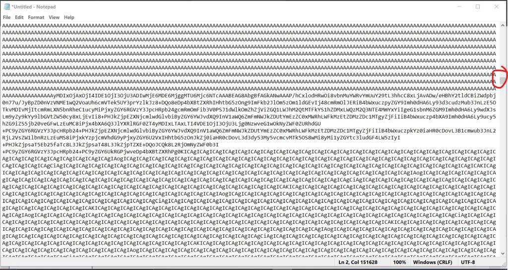

Mello4, I have had to remove your image links because they were totally corrupting the page loading of this thread.
You can see just a small part of your links in the image attached, they were hundreds of thousands of characters in length.
Please attach images correctly using the forums own uploading utility
