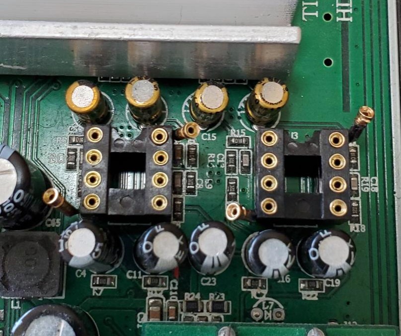

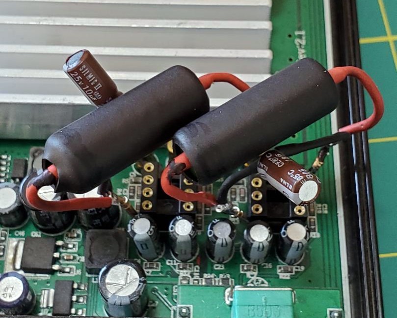

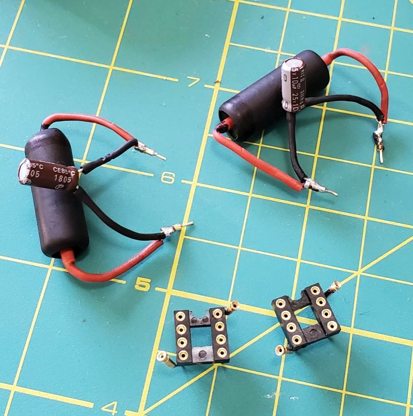

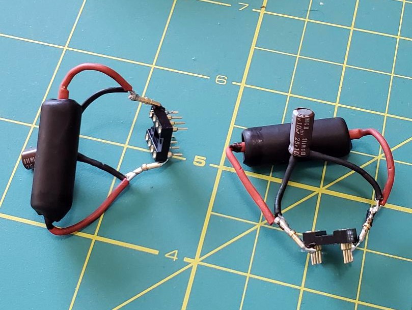

OK, after a little thought I changed my design for adding bypass caps to my OPA1656 Op Amps.
My new design allows for Very Quick install & removal of any bypass cap configuration.
The small cap is a Elna RFS SILMIC II 10 uF 25v, the big cap is a Russian K42Y-2 PIO 0.1 uF 250v, both are considered very good "Audio Grade" caps. (yes, I can make them fit)
These are currently burning-in, I will start my A/B listening tests tomorrow.

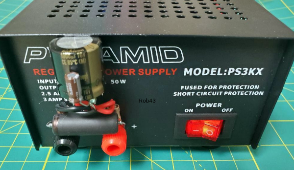

First tweak, “A” in my list, is an external SMPS filter of mine, between the Meanwell SMPS and the amps.
Cluade... and Gilles
Claude, I'm really look forward to your "A" & "C" results, I hope they sound good !

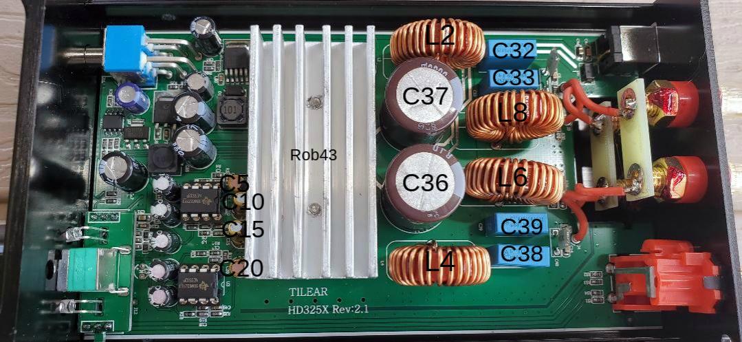

1) 4 Wurth Inductors ~$29
2) Caps at C5, C10, C15, & C20 ~$1.60
3) OPA1656 Op Amps ~$15 (DIY) to ~$35 (Pre-made)
4) Caps at C36 & C37 ~$9
5) Caps at C32, C33, C38, & C39 ~$6 to ~$10 depending on what's chosen
6) Smoothing & bypass caps for Meanwell PSU ~$6 (easy, no soldering required)
7) Shipping & miscellaneous parts ~$10
Rough Total = ~$79

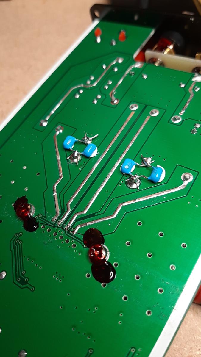

Moving on to mod I: bypassing the 2 big PS caps (C37, C38) with quality 2x2.2uF Murata X7R caps each.
This is an easy mod and cost 3$, so worth a try. Interesting point is that Gilles performed this mod alone and he a) never ever had done such a thing before, b) didn’t know at all what it was about nor what to expect « if at all », hence for me a very neutral feedback. I find he did a good job placing the caps cleverly and it is very straight forward given their tiny size. Yes, he didn’t finalise cutting the legs : that is because we are not done so we might need to desolder and solder them back again, hence not finalising / caring about the cosmetic (no danger).
Gilles did it… so what about YOU ?
The aim here is to help the 2 big electrolytic PS caps by having some quality ones bypassing them. It is important to understand that both big caps are in parallel and not in different rails. We chose 4 x 2.2uF because the bypass ratio seemed right to me (see previous post) and it was easy to fit under the board that way (many small, small also meaning we couldn’t use C0G / PPP etc.). Now you can either consider that we bypassed each 3000uF with 4.4uF directly in situ (important not to have long wires there), or alternatively as I like also to view it, that we do bypass the last 3000uF big PS cap (out of a bank of 2) with 4.4uF, half of it being directly located at the cap, the other half admitely « apparently » a bit remote… of the cap. And that applying regardless what big cap you consider, LOL ! But all this is academic as at the end it would even be better if these bypass caps would be located at the amp chip’s legs and not at the caps, so who cares about bypass caps being at one or the other big cap as these are as far away from the destination ! Note also that it is feasible to get them to the amp chip’s legs… but really not very practical for us, hence sticking to the big caps legs as easy and safe soldering points with then a hopefully low R route to the amp chip.
Now to the sound, we found :
- Perceived faster attacks / rising edge when starting a tone, feels like more impulse / faster response time +2, very easy to spot on bass percussion
- Cleanliness on mids and treble, lisibility of multiple tones on complex music with various instruments. They all appear less blured, the amp sounds quicker and much sharper, + 1
- Decays and echo are more realistic and lasting longer, +1
TBH, Gilles surprised me as that is exactly what I do expect from such a mod, but I didn’t know if this amp would be reactive or not. With say an overall +2 perceived sound improvement (a tad more noticeable overall than say the SMPS filter) it works great and is indeed better VFM than my own filter (poor me !)… but then of course both bring something very different to the music and have additional effects in our case. Who knows if this cap bypass wouldn’t have worked even better on an amp without filter… or on the apparently lower grade PS caps Aiyima now fits ? You to tell !
Is it worth going further in that direction with these big PS caps ? IME not. Explanation: tweaks that are correctly performed either work or not IME. If bypassing works, then it works quite well if Ok executed, eventhough you wouldn’t use the best possible quality parts or the ultimate bypass cascade. And if it doesn’t work… well it doesn’t regardless, or very very little. In short, as with most tweaks, I am confident we are now at « at least 80% of what is achievable » around the topic « bypassing these PS caps ». Bypassing further with smaller values, using other caps etc. might one day, after a lot of hassle, perhaps, bring us from +2… to +2.5. Perhaps. Not worth at that magnitude. Perhaps OK when you have a majour tweak like a subplatter on a TT that brings +10 and you are looking for +12 going for another subplatter material.
