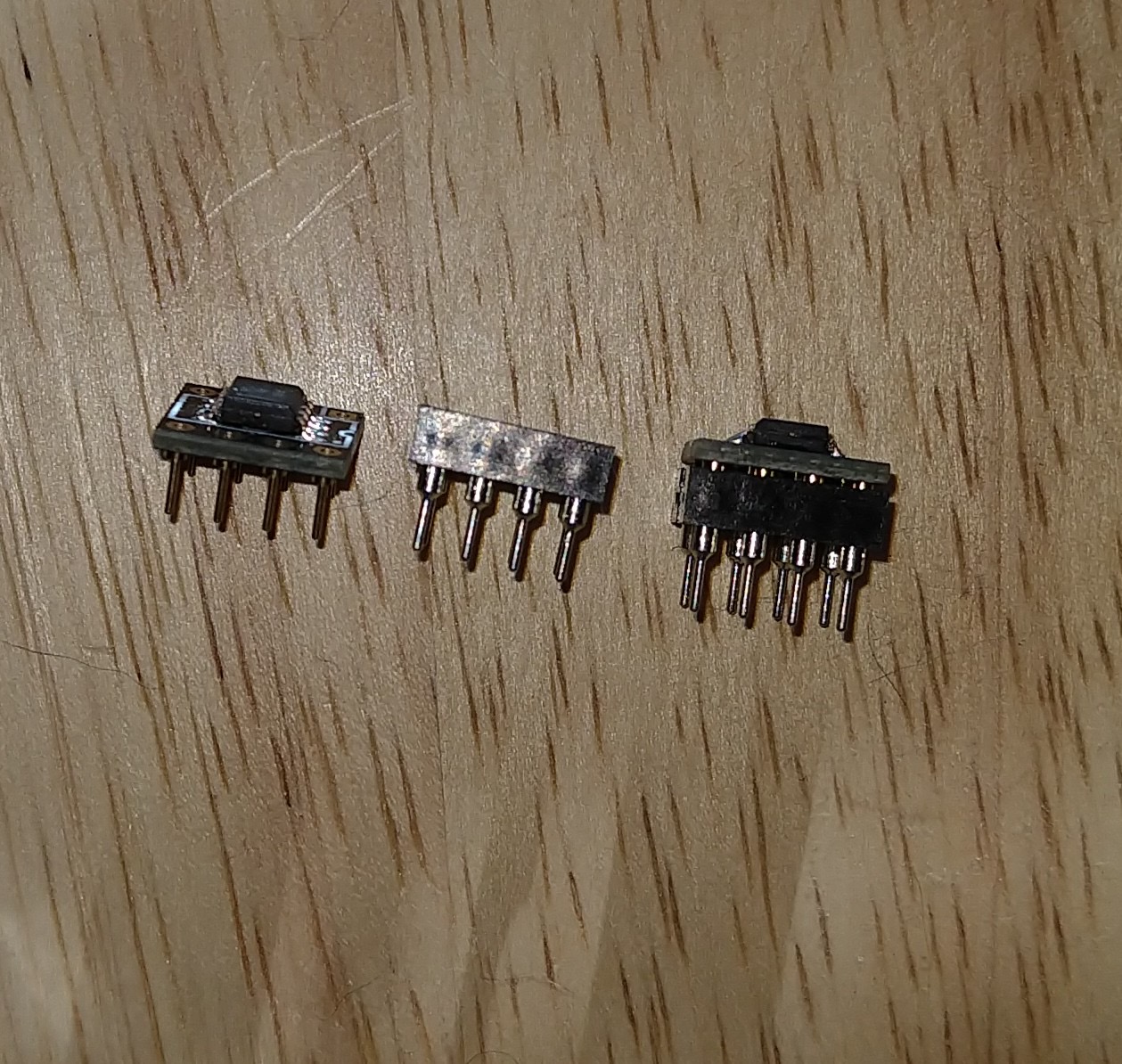

I don't know the Brown Dog... but out of curiousity, what do you mean by 'the pins are too small for this socket'?
Pins are usualy pins, they are usualy std size both in diameter and pitch between pins. Sometimes you believe they are in, but you need to push a little bit more to make sure they are completely locked. So they are rather tight... most unexperienced people even struggle to get them out without braking anything or need special pliers to do so.
Now, should your "pins" be loose, then that would probably mean that your socket is too large. In which case the socket is the problem. Very unlikely, very std again... That is unless someone has forced something inside them, such as square section pins instead of the round ones. One would feel something is very wrong when trying that though, nearly forming the socket.
But should that be the case, than there is hope! Replacing the socket is the best option, being very careful not to ruin the tracks when desoldering. Replacement sockets can be found very easily and cheap. If really the socket has been enlarged, only std OPAs will fit and perform OKish, that is hoping for the best re contact...
Before throwing the brown dog away, what about trying it on a std socket (not the ones inside your amp)? And if still wrong, then complain to teh company who sold them!

Diameter on them is tiny....theyre just loose in the socket. Ive never seen pins this small in diameter before.
Any idea how these sockets are mounted on the board? I dont feel like opening it up again right now. I assume through hole? Im trying to figure out what sockets I need to buy. Fortunately I still have a pending order I havent placed yet.

They fit fine in new dip8 sockets. Once you’ve used a larger pin size it stretches the socket’s holders. In older sockets that have had a lot of rolling activity I’ve had to use new dip8 sockets as intermediate mounting sockets in between the browndog adapters and the existing (soldered in) dip8 socket and full contact is made.

I feel sorry for you... well, try a socket you have handyjust to make sure and if still VERY lose, in a way you believe contact is not good, ask the seller about this! Perhaps he has an explanation... perhaps he got it wrong on yours and them it is up to him to sort it
Try to post a pix so we can see how it looks like...
