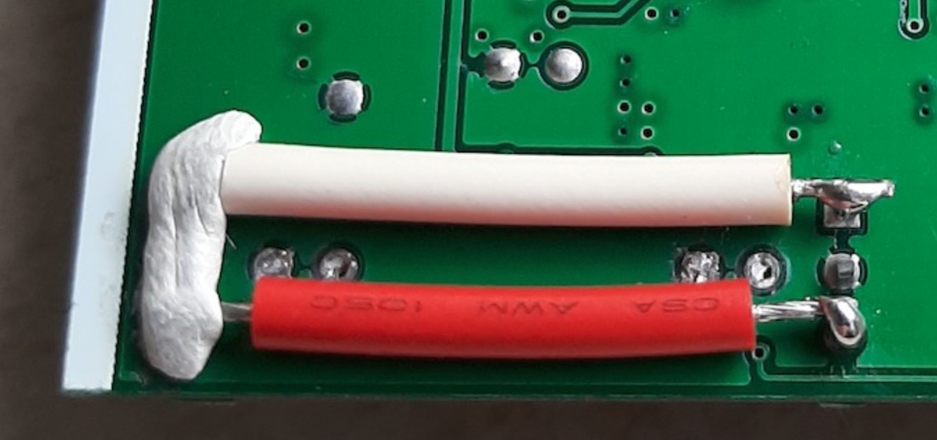

You may want to read the thread, this has been already done and described, even with pix...
Short version
If you think about it, you can't just short it: you need to take it completely out.
And then just put 2 wires (1 for each channel, to connect the corresponding pins again - mass is already continuous). See pix, can be done at the bottom or at the top.
The only way we found to take the damn' pot board out was to dremel it. Desoldering it with a professional continuously sucking desoldering machine, 2 soldering irons, 2 other pumps and 2 quite advanced guys didn't work in our cases (2 amps)... some legs are like glued, perhaps to hold the board in place while soldering it?
Anyway, once you take the vol pot out you get quite a sonic benefit as this is clearly a bottleneck. But you need then a device to enable you to adjust the input level to what becomes a pure power amp.
I hope this helps you, TNT

This?
"... mass" = ground?
Dremel the small pot board as we did was the best way we found not to damage anything else. Unsoldering had been impossible for us. Detroying the pot itself, maybe, we did not try. But of course someone else could have a better idea to get rid of the pot ! Feel free to share if you find a better way 🙂
TBH, I don't see a way to destroy the pot that could be more efficient than our simple dremel work. Space is an issue...
I don't remember how the board looks like, but if the relevant tracks all run at the top side (=access) of the board, there could be a way to do 4 track cuts to cut off the 2 channel INPUTS and OUTPUTS without removing the small board.
You to tell us...
