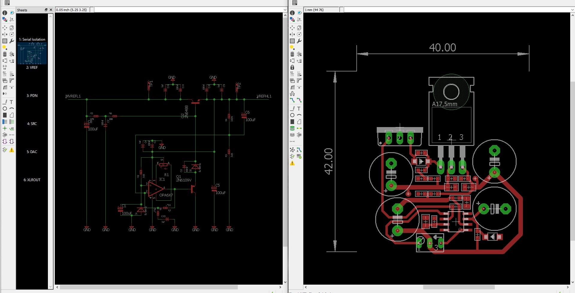

have started doing pcb from latest pdf attached few posts up.. but must confess i have not fully understand this vref part of circuit, especialy opamp inputs part. maybe better i continue tomorow, here is preview. please advise if you see something that needs change, gnd vias and other details will put later.
