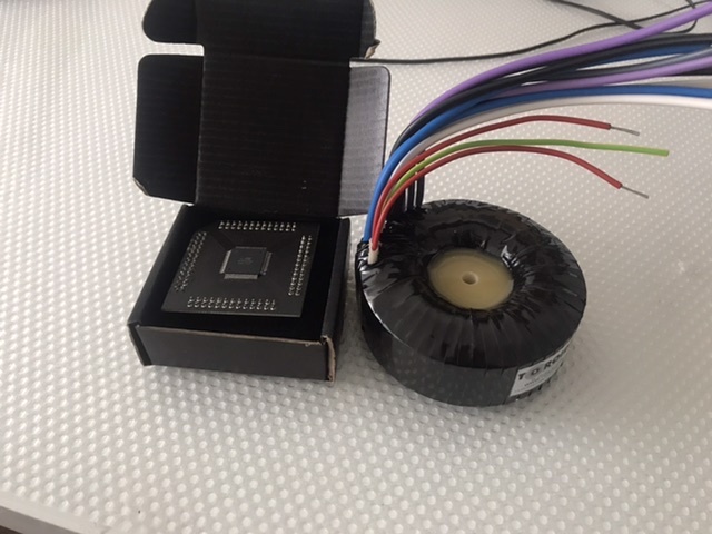

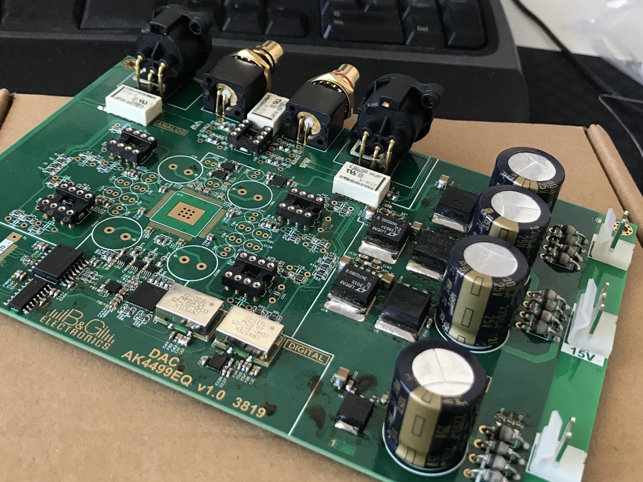

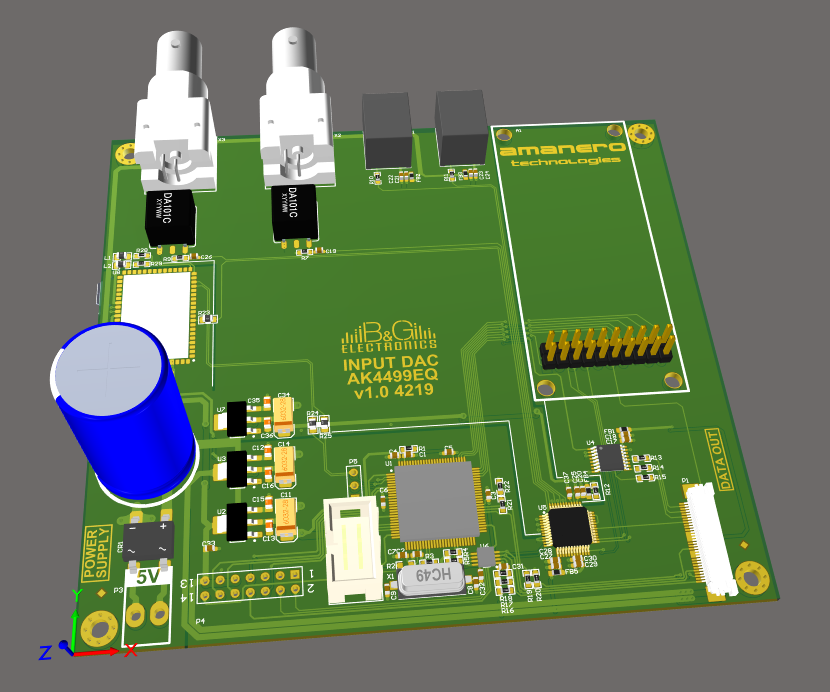

My DAC based on AK4499EQ :)
At the end of this year I hope it will run.
