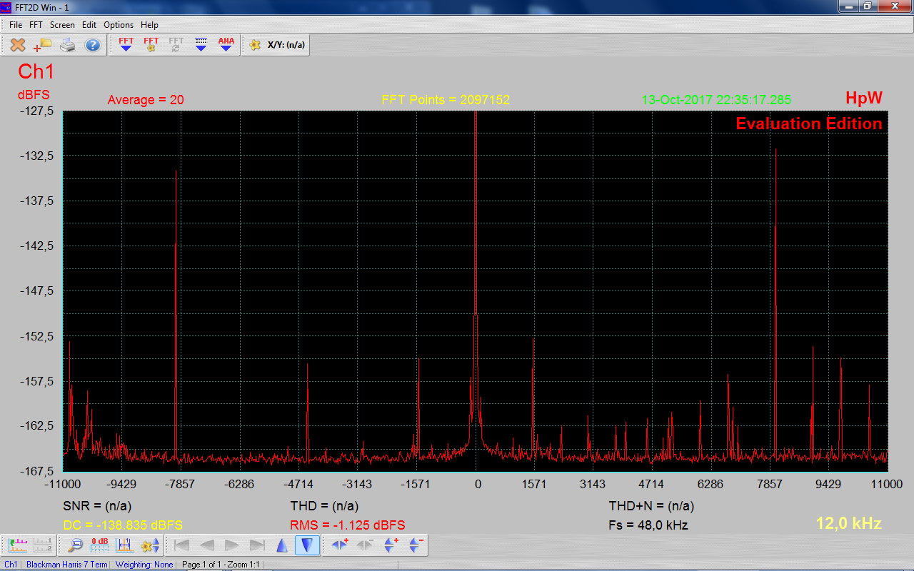

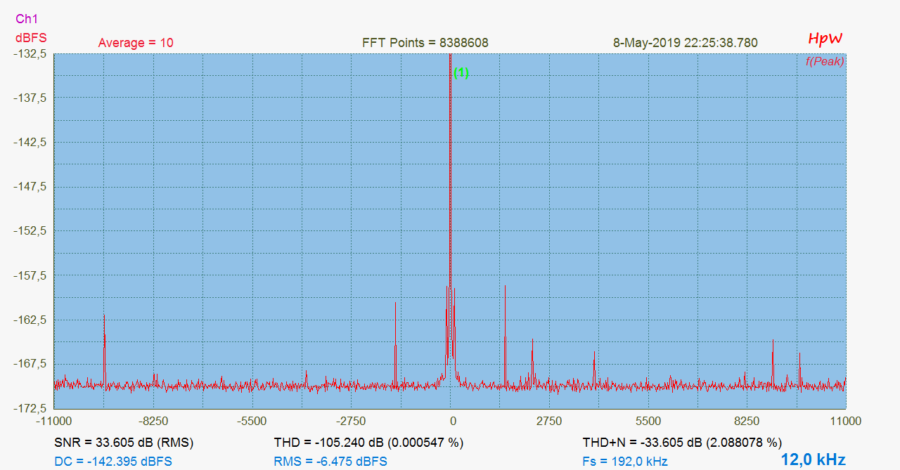

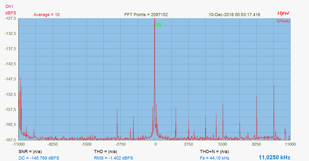

It's interesting that You say that. I have spent quite some time fiddling about my Mirand dac, based on a 4490.
I have documented with testing the steps of advancement, which mostly consisted of cleaning up crosstalks in the ground plain, by clearly spearating routes for the reference PS etc..
First is jitter spectra before the latest tweaks, second is the same but after tweaks, on the output of the converter. Clock already had been changed, that was one of the first steps.
Each and every intervention around the converter can be seen on the output jitter spectra, in my humble opinion..
And this was the original format, from where I've started from. I'm sure that all this is totally not audible, I am just "fooling myself" , but that all this is not measurable, on the output of the dac, permit me to refute categorically.
You fixing pathological issues with your DAC has nothing to do with your fantasyland levels of phase noise and audibility. A bunch of plots without context are not useful.
Where are you controlling this experiment for close-in phase noise differences only?
No one is disputing that you can make measurable improvements to a cheap DAC as far as I’m aware.

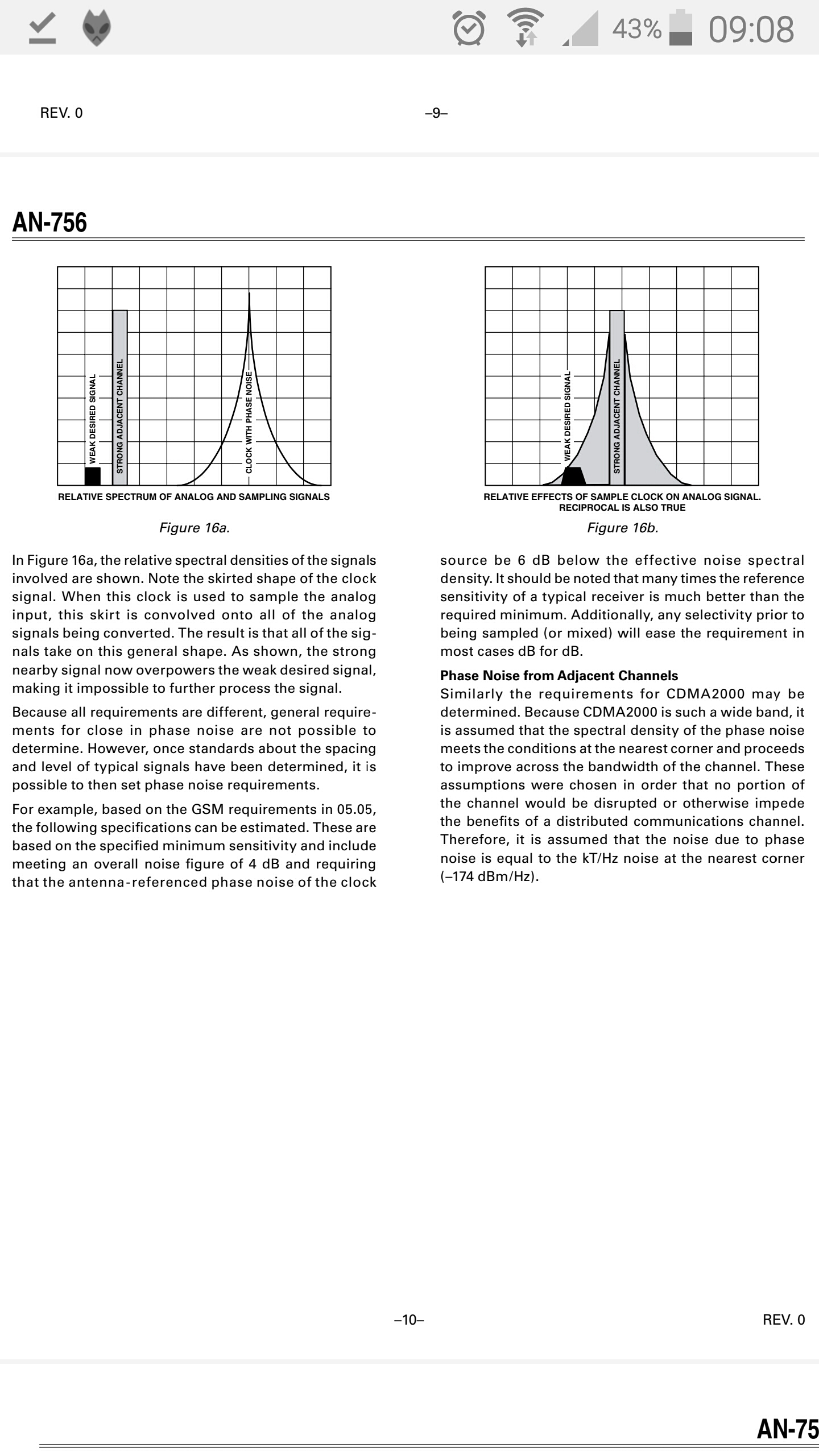

This also seems pretty relevant:
https://www.analog.com/media/en/technical-documentation/application-notes/AN-756.pdf
If I'm not mistaken they're basically talking of a masking effect where low level signals get masked/buried by the widening of the base by lf phase noise of an adjacent stronger signal. Kind of like the average mp3 is defined.
Now if only we could calculate when this masking effect takes place and becomes detrimental to our perceived SQ.
For instance, is it true that a clock with a lf phase noise of -60dB at 1 Hz makes for a base -60dB wide at 99 and 101 Hz, if the high level signal of e.g. 0dB at 100Hz was taken?
I'd really like to know if that reasoning is correct, because to me this seems like a rather noisy signal.
Nothing at all like the free of rumble, hum and wobblefree digital source it supposedly should be.
And this happens when digitizing as well as when putting back to analog, so we're now hypothetically talking about -54 dB?
I am imagining my speakers being shaken -54dB on the rhythm of every signal it gets.
