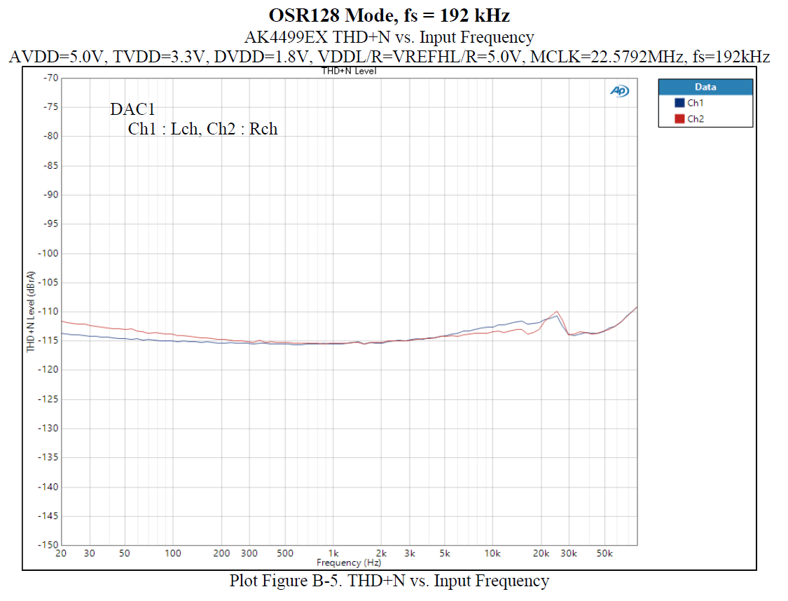

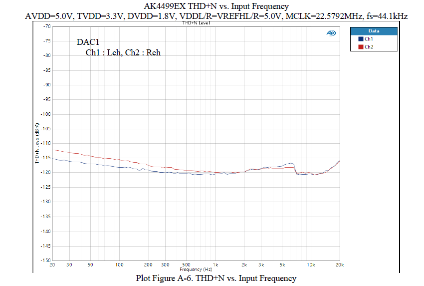

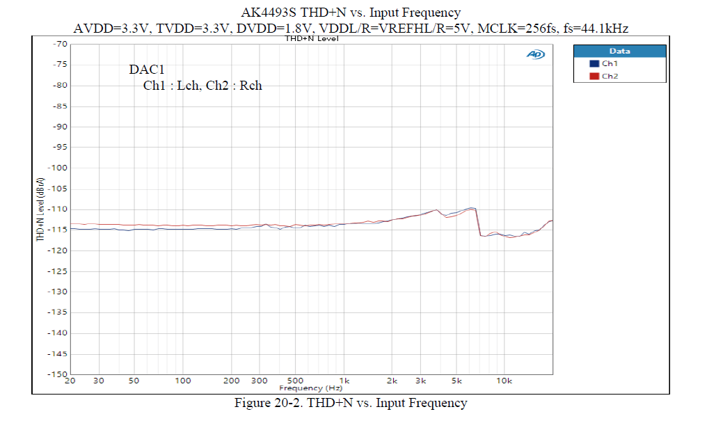

BTW the hump in THD+N graph of AK4499EQ evaluation board is probably caused by Vref (Jung-ish as Markw4 mentioned). New AK4499EX and AK4493S evaluation boards use the same Vref regulator and both have similar hump.
While there may be people who are able to hear a difference at these low levels I doubt the hump is a cause for the bad sound you reported especially since these are measured from evaluation boards. So the hump probably does not exist in every dac using AK4499 (or AK4493).
Isn't that just a measurement artefact? With a bandwidth of around 21 kHz (44.1 kHz sampling) the third harmonic will "disappear" once your fundamental gets above 7 kHz. There is also a small reduction just above 10 kHz. This could be where the second harmonic is outside the measuement bandwidth.BTW the hump in THD+N graph of AK4499EQ evaluation board is probably caused by Vref (Jung-ish as Markw4 mentioned). New AK4499EX and AK4493S evaluation boards use the same Vref regulator and both have similar hump.
You are probably right. Although in 192k measurement the hump drops a bit too soon if caused by "disappearance" of 3rd hd and no reduction for 2nd hd disappearing.Isn't that just a measurement artefact? With a bandwidth of around 21 kHz (44.1 kHz sampling) the third harmonic will "disappear" once your fundamental gets above 7 kHz. There is also a small reduction just above 10 kHz. This could be where the second harmonic is outside the measuement bandwidth.
