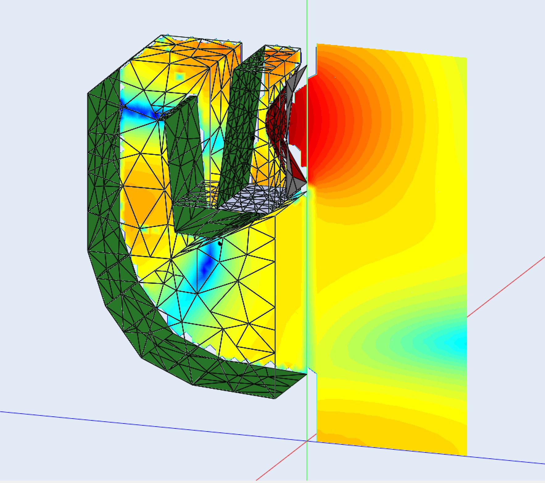

I'd like to use AKABAK to investigate an unwanted resonance a transmission line speaker.
The example file 'Speaker Cabinet Bass-Horn Bogart' looks like a good learning candidate. However I have a couple of questions:
1) The shape seems to be defined with nodes rather than a mesh file. How are they importing these node points? The cabinet shape looks too complicated to just be working it out on a post-it note without CAD.
2) How does one know when to use an additional internal domain? Here we see multiple sections of the horn get their own internal domain, but I do not understand what necessitates the split at those specific sections. Why can't the horn be a single internal domain?

Hi Tenson, sorry I can't be more helpful, would also like to know when to apply a subdomain.
I find it quite easy to enter objects as a mesh file using fusion360 to model. I use the unstitch command to break down solids into shells, export to .step and then use GMESH to generate version II mesh files (.msh). This is a lot easier than using manualy calculated nodes (how I did my first simulations).

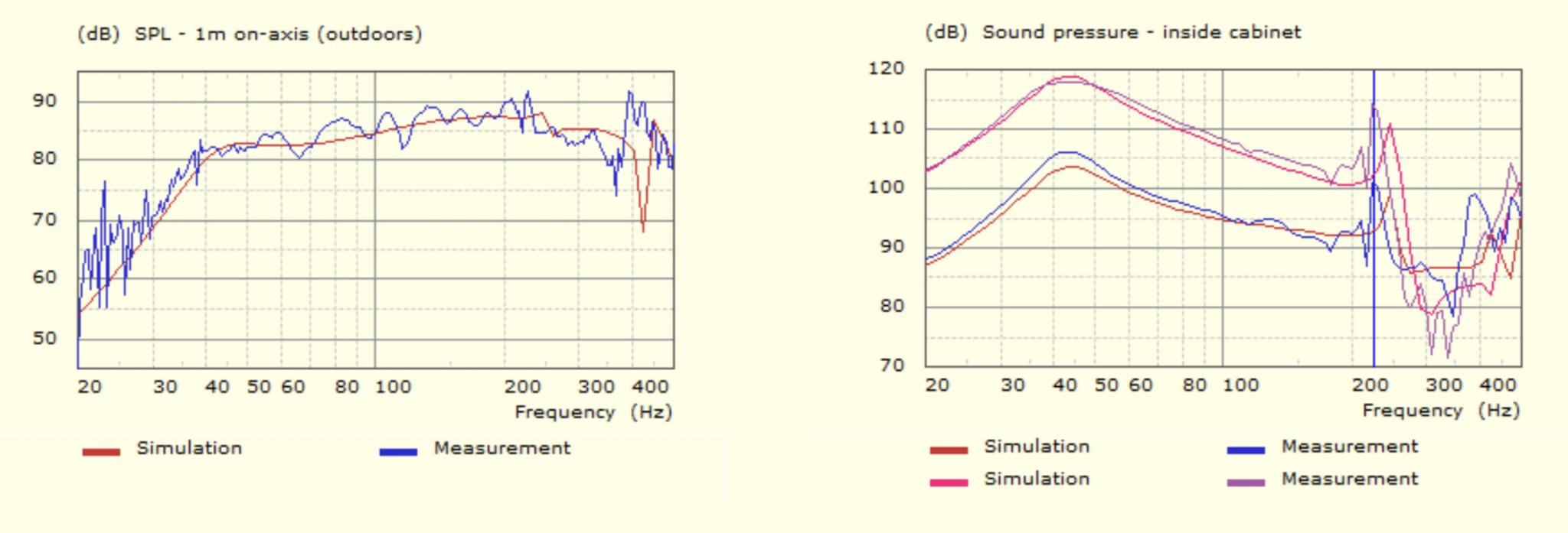

A linear acoustic BEM code isn't the right tool for this type of study. The effect of the damping material in the line will be missing. This will not only lead to an incorrect Q for the resonance but also an incorrect frequency because the damping material changes the effective speed of sound in the line. More seriously, if the resonance involves incompressible fluid motion (e.g. Helmholtz resonance) the relevant terms will not be present in the sourceless linear wave equation used in a linear acoustic BEM code. In addition, for long thin internal shapes the numerical error in the boundary integral evaluated by BEM code can become large and swamp the answer. This can be checked and possibly got around.
A reliable simulation would need to include both the physics of the damping material and possibly relevant incompressible motion. The 1D network models often used to simulate transmission lines usually include this physics but, obviously, don't include any 2D or 3D effects which may be relevant. To include everything you would need to use a low Mach number CFD code or an incompressible CFD code with an acoustic code that can use the CFD predictions to construct the relevant source terms. For example, look at what the various types of numerical methods are used for by KEF here.
Thanks Andy, I did read your comments earlier and hoped you might chime in.A linear acoustic BEM code isn't the right tool for this type of study. The effect of the damping material in the line will be missing. This will not only lead to an incorrect Q for the resonance but also an incorrect frequency because the damping material changes the effective speed of sound in the line. More seriously, if the resonance involves incompressible fluid motion (e.g. Helmholtz resonance) the relevant terms will not be present in the sourceless linear wave equation used in a linear acoustic BEM code. In addition, for long thin internal shapes the numerical error in the boundary integral evaluated by BEM code can become large and swamp the answer. This can be checked and possibly got around.
I can't pretend I really understand the mathematical limits of BEM vs CFD. Any way you can try to explain in laymen's terms?
What you said makes me think maybe BEM is not very accurate where wave velocity approaches zero (and pressure is maximum), such as at the actual boundaries?

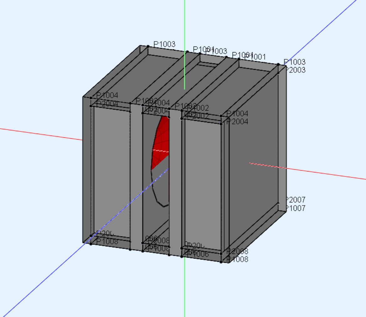

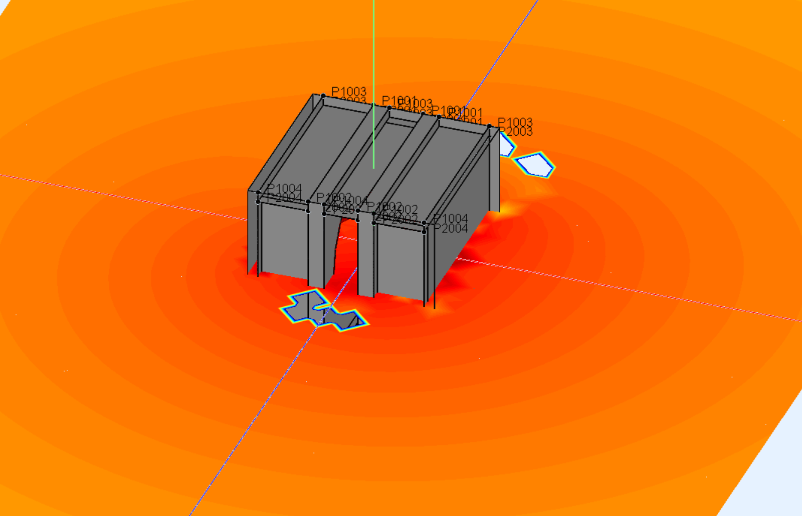

A good way to think about it is that subdomains each represent a relatively stable acoustic field behaviour. If there’s a significant change in a section’s volume or direction, then that’s a good indication that breaking it down into subdomains is needed for improved accuracy. The simple 2D BEM example of a duct with bend here uses two subdomains, for example:
https://randteam.de/_Docs/AKABAK/Studies/AKABAK-BEM.pdf
This set of presentation slides also highlights the possible differences in resonance details mentioned by @andy19191 in BEM sims versus reality. Check the measurement comparisons:
Likewise, any section that is relatively narrow should have its own subdomain with correctly set meshing parameters to avoid overlapping of calculation point radius from the centre of each mesh element - see the latest version for a nice visual example in the help under Meshing, plus a relatively new pink highlight when the solver detects this error.

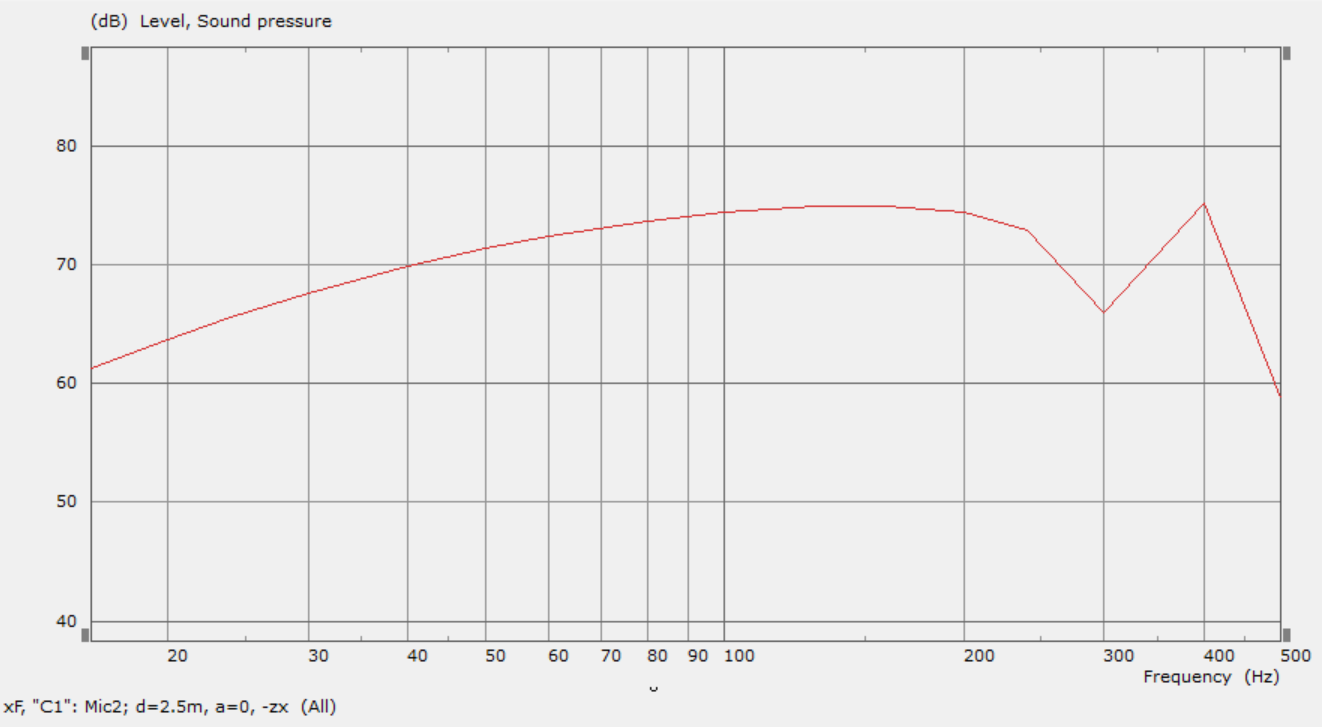

Hello again, I'm back!

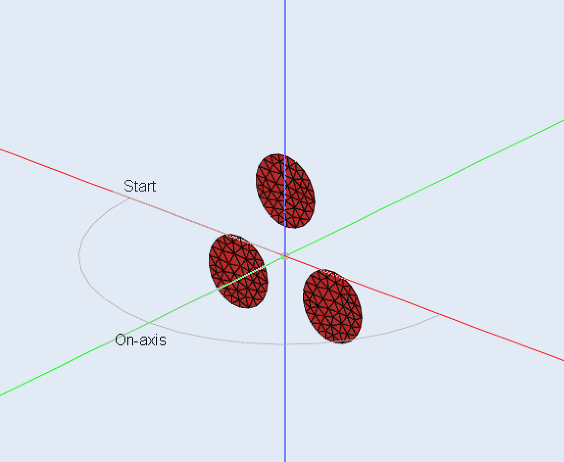

Is it possible to implement a FIR filter in AKABAK simulations?
I want to simulate 3 identical drivers where two of them reduce in level with a linear phase response to control directivity of the array. If I could import a filter impulse from RePhase that would be great.

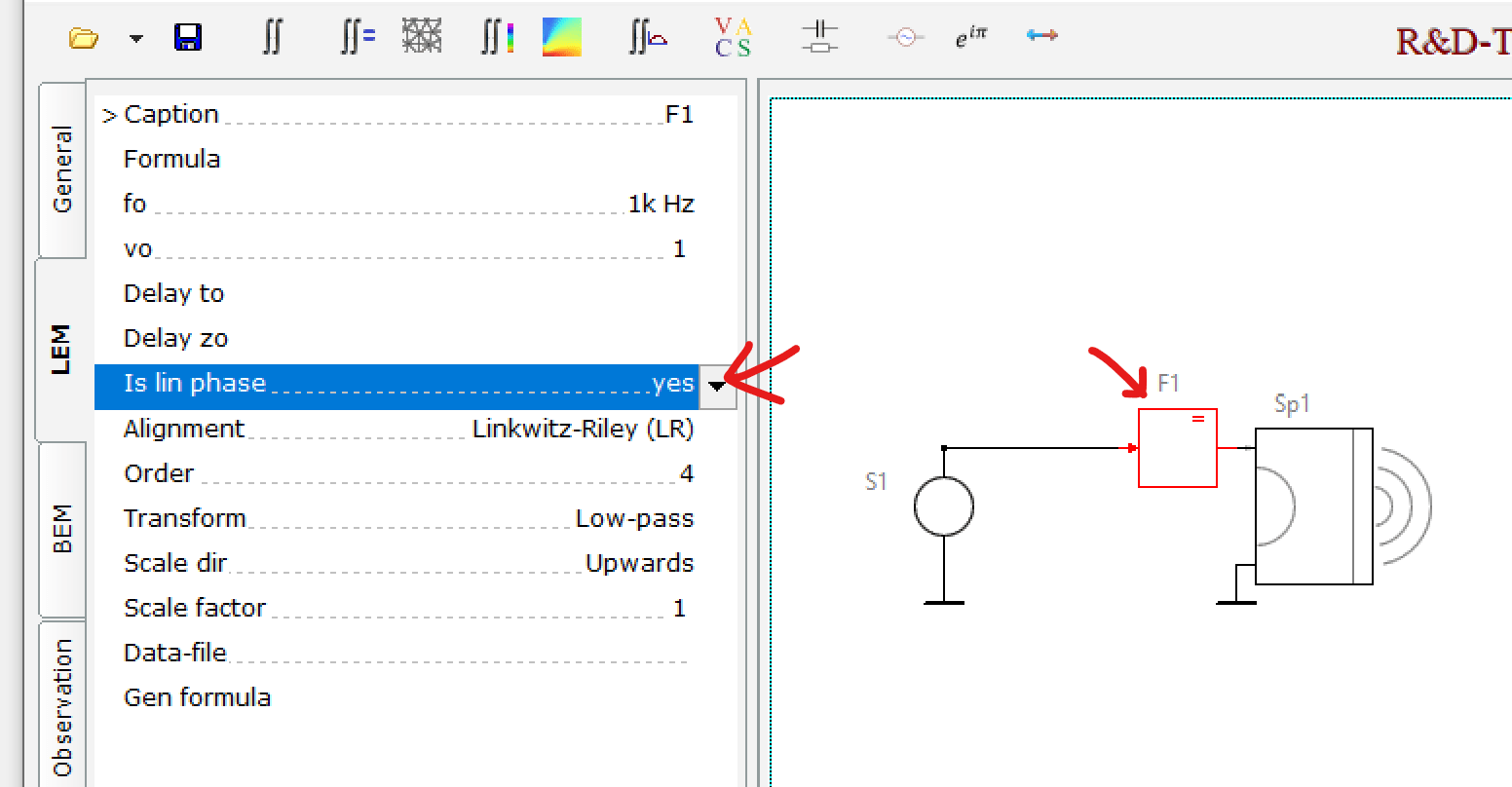

Does anyone know how to utilise biquad coefficients in the Filter block in AKABAK?
Coefficients generated elsewhere (e.g. from VituixCAD or https://www.earlevel.com/main/2021/09/02/biquad-calculator-v3/) don't seem to translate/work well when defined in the Formula area of the Filter block.
There is an example for Linkwitz-Riley in the software, but it's very basic, and the coefficients there don't translate to other software.
Feel like I'm missing something basic here.
