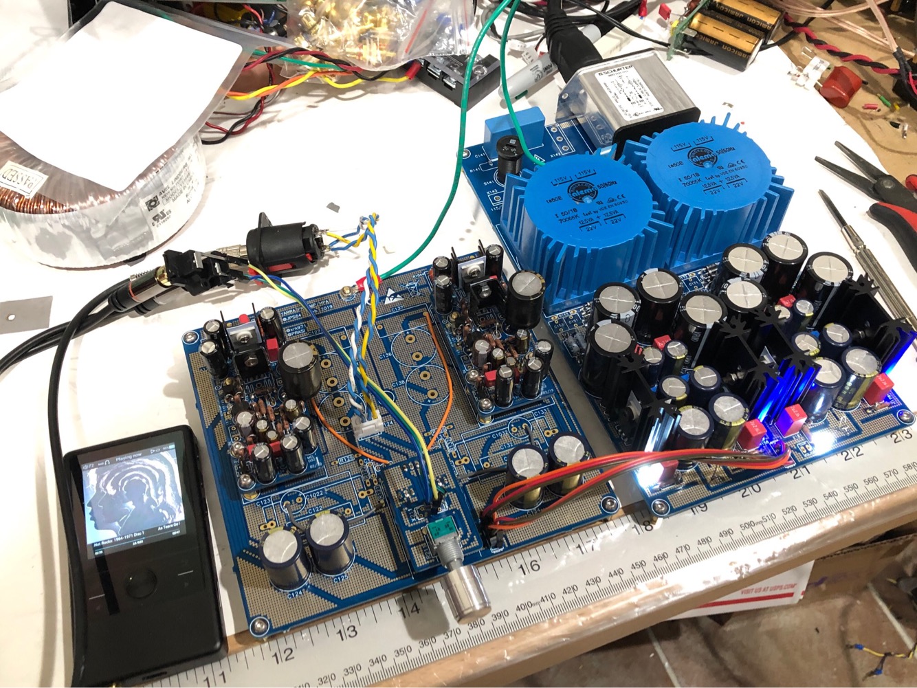

Yes I have the output from the pre split to drive the ACA and a subwoofer.
Not sure where to go from here. If it is heat related I could test by putting a fan on it temporarily to see if that cures it but it sounds doubtful that's the issue.
Could it be something basic I am just not aware of or simple like a bad power supply or volume pot or cable shielding?
Did you test the preamp before connecting the input selector panel? You may have a cold slider joint somewhere. Re-touch all solder joints from RCA in to RCA out and. All connection points in between.
If the bias current is correct on the amp core and DC setpoints are correct, the preamp should be working well. It is probably a connection or power supply issue. You are certain the bias current doesn’t change when the distortion sets in? It would be helpful if you can record the distortion sound and post it. Play on ACA and speaker and use phone to record video and post on YouTube. That’s the easiest way. Send me a PM for private link to video of you want vs public posting.
Try a different DC-DC step up. Take some closeup photos of your amp main board and duaghter boards from various angles and post. We might be able to see something.
Thanks for the guidance. I did not test the preamp before connecting the selector panel. I will try to bypass it and see if it clears up. One thing though is the volume pot does not attenuate the distortion, it remains at a constant volume regardless of how loud or quite the music is.
I will get some pictures and record the distortion and report back. Thanks again for the help.
Think I sorted out the problem and the preamp has been singing beautifully all day. The issue seems to have been a bad solder joint to the primary left channel rca out. What happened is while I was trying to record the distortion the left channel to the main speakers kept cutting out. This was a new twist and eventually I tried connecting both the speakers and the sub to the secondary rca out with a y adapter and all was good. A bit odd because I run connections from the primary rca out to the headphone jack then to the secondary out. This meant the only connection not testing well was the flying lead from the pcb rca out to the left rca jack. Re-soldered these points and no more distortion or lost signal after a solid day of music.

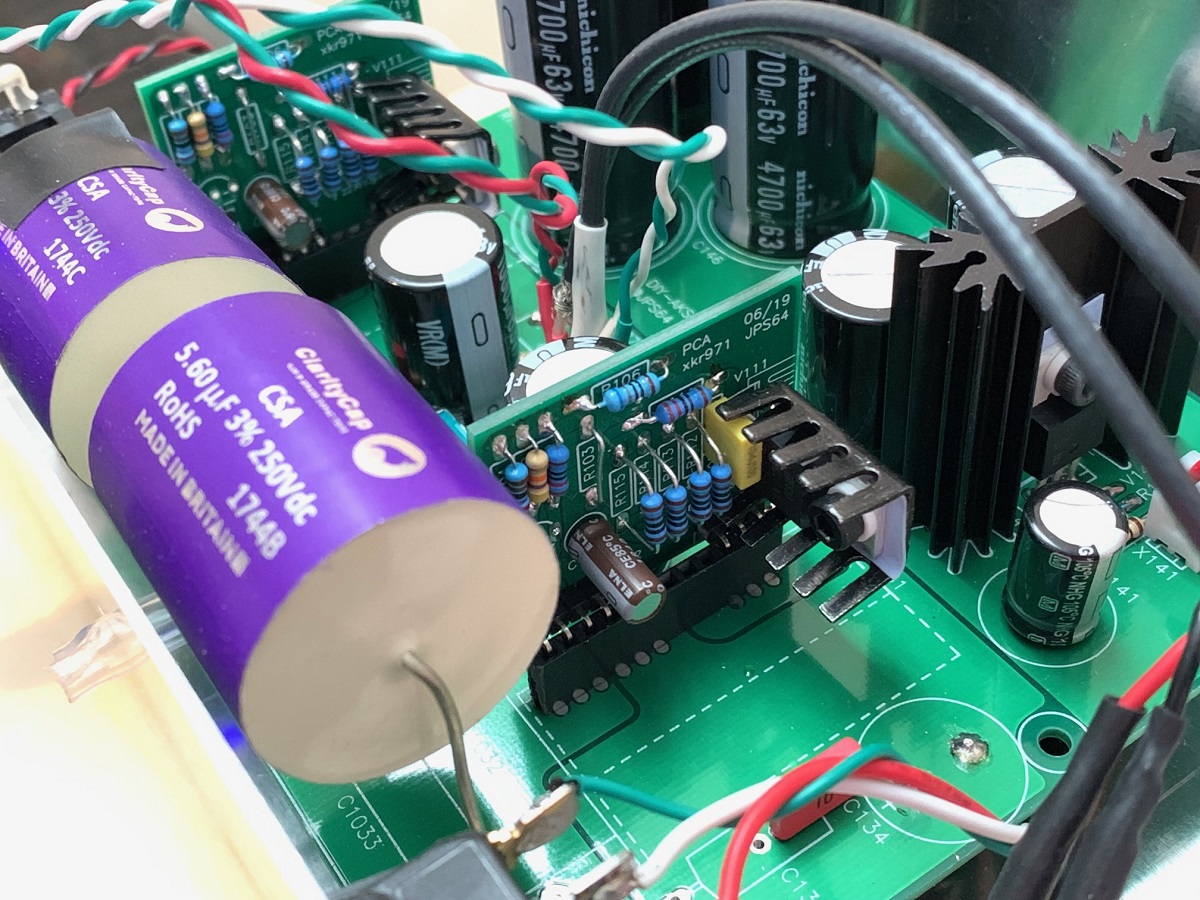

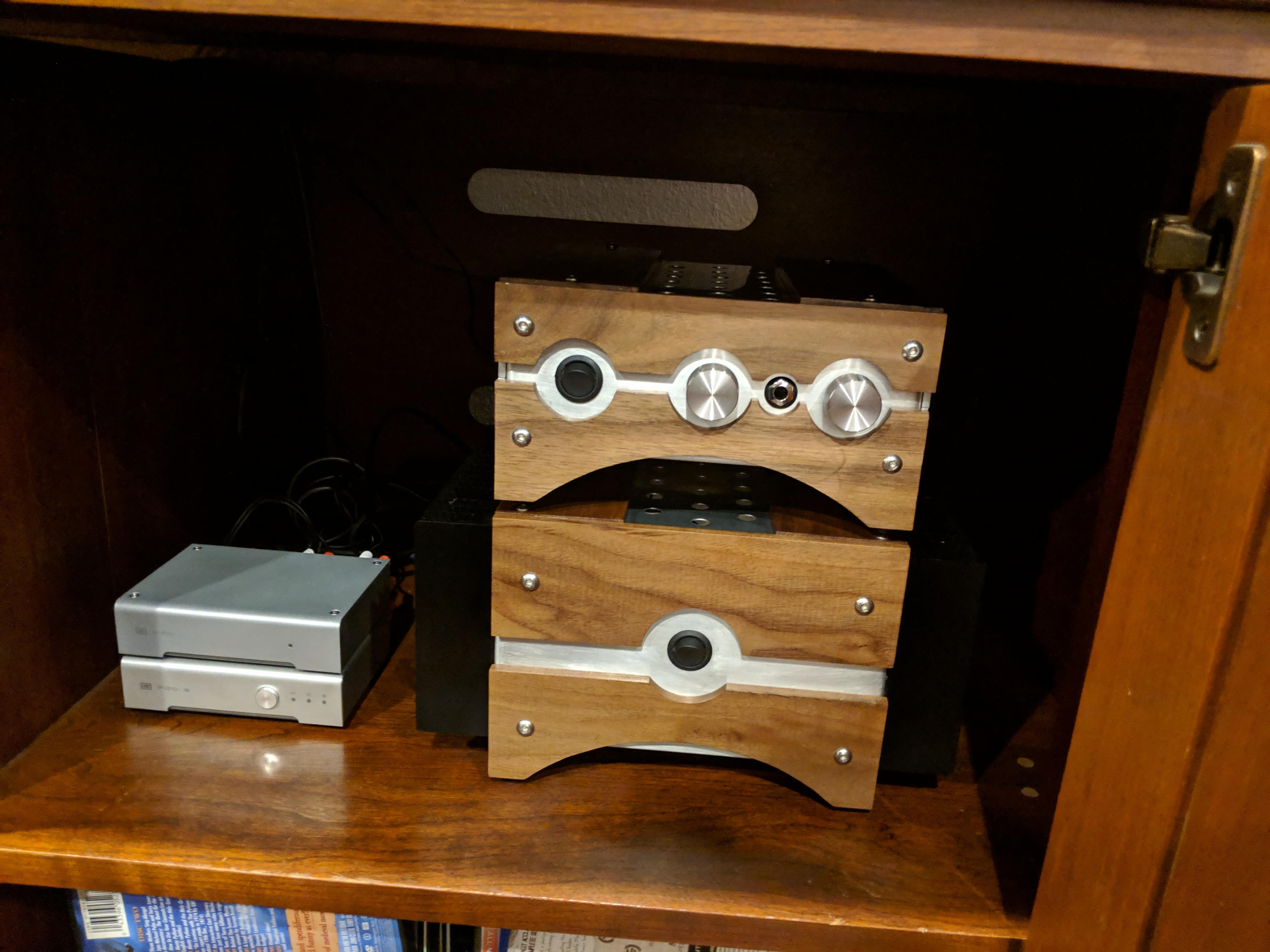

Attached is a pic of the preamp in its new home on top of my ACA.

Your wooden panel faced boxes look great. Very nice and you have something you made yourself and it sounds great. This is the satisfaction one gets that keeps us firmly planted in DIY.

Beautiful work!!

Beautiful work!!
Thank you for the kind words, I am please with the way it turned out. You are right, the satisfaction that diy brings is a huge draw for me. I can not thank you enough for making something like this attainable by someone such as myself.

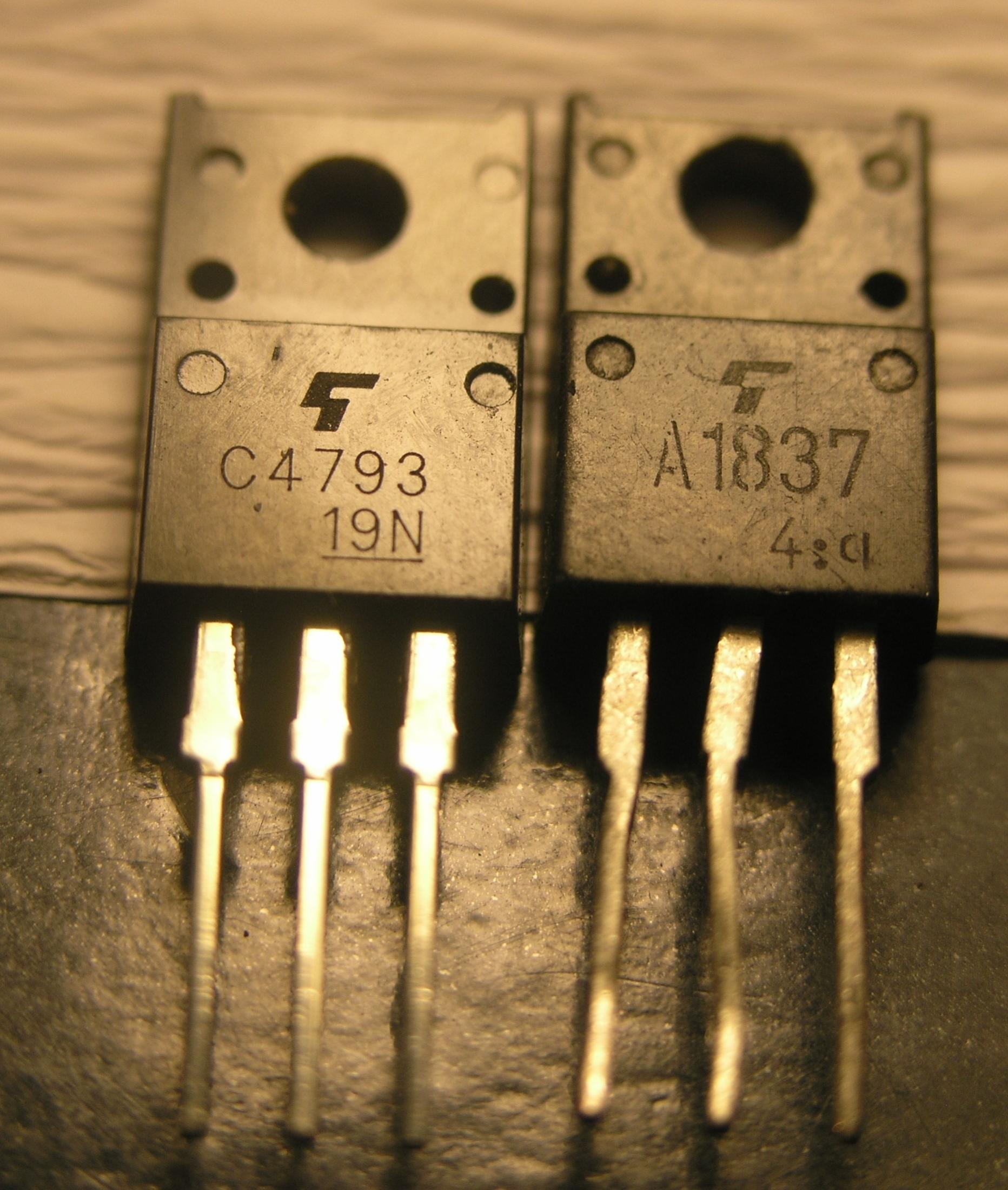

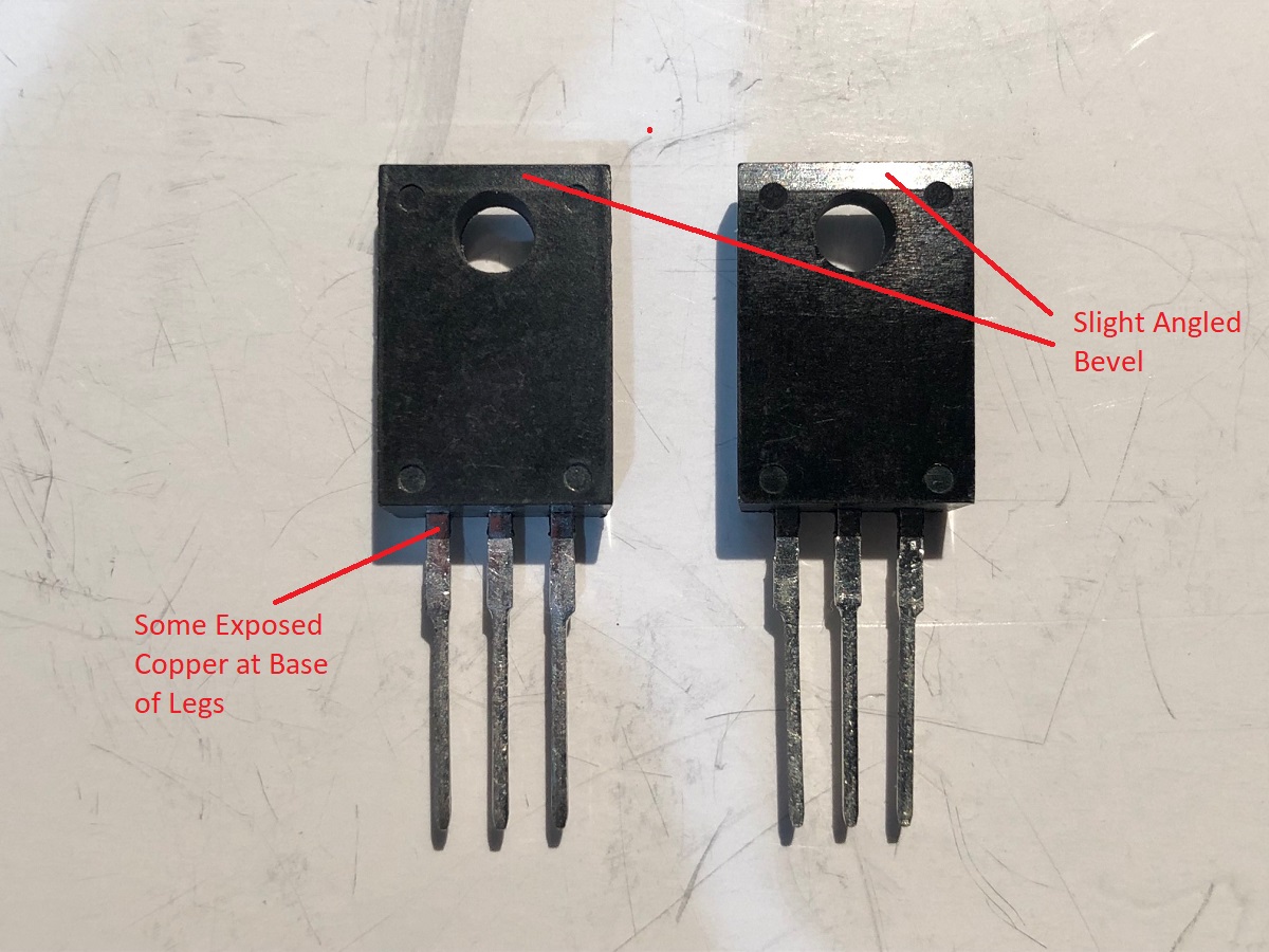

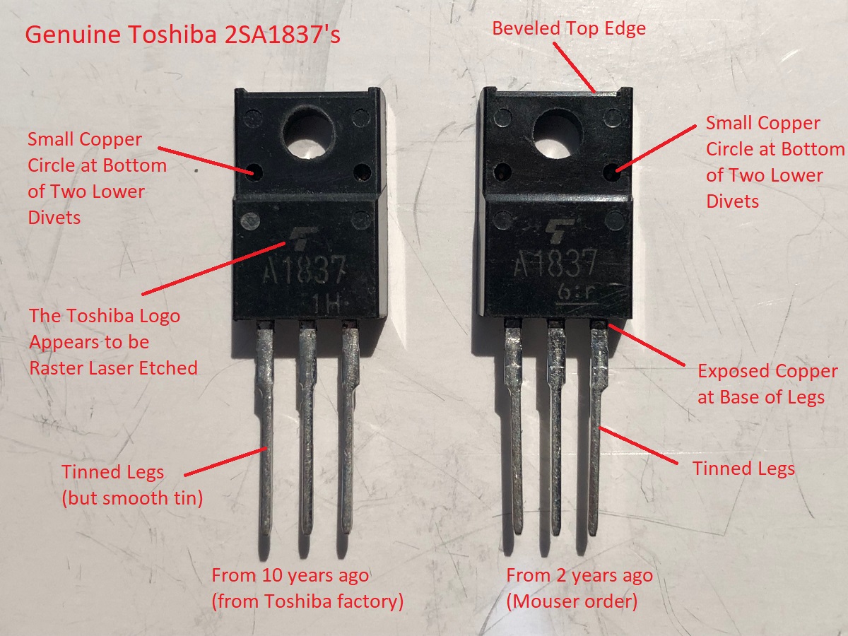

I took another careful look at my genuine 2SA1837's - and I have two batches. One Aksa, who said he got them from the Toshiba factory 10 years ago, and one from an order I placed to Mouser 2 years ago. They may actually be laser etched - but finely done and deep. Not lightly done as on some knock offs. There are a few details like bevels on the epoxy and a small copper circle visible at the bottom of the lower two divets on the front tab. The legs are the biggest giveaway though. New knock offs will not be tinned but shiny plated stamped die-cut metal (maybe not even copper). Genuine will be tinned with Pb solder (before the who Pb free era) smoothly done over partially exposed copper legs.
Here are some photos of front and backside:
Looking at your photo your 2SA1837's, I see the copper in the divets, the bevel on the case, and the tinned legs - I believe you have genuines.
Thanks X for the post. I have a local supplier of 2Sa and 2Sc.
Here is what I have.
Looks to be genuine, isnt it? (pic taken with android camera and shared over whatsapp.

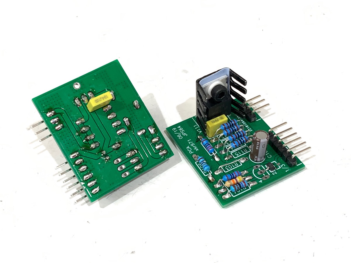

Here’s another option for folks with an Aksa Lender to swap out boards and try sound of a PCA:

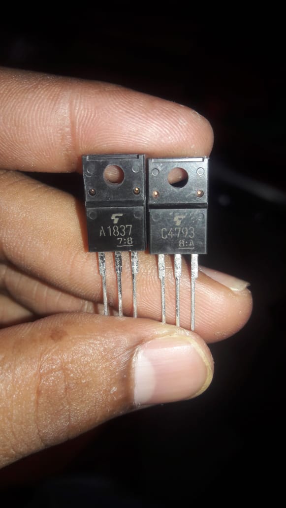

Hi.

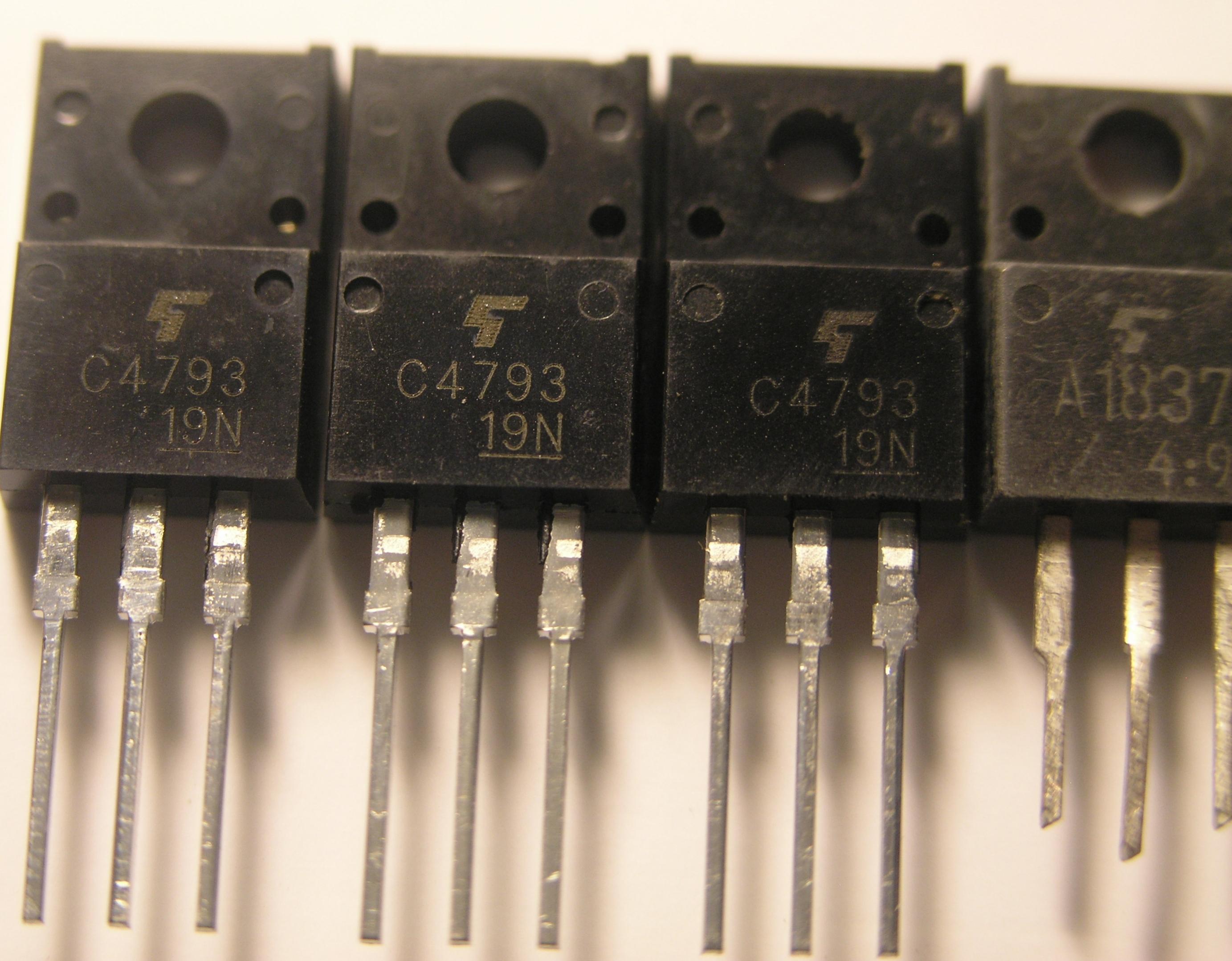

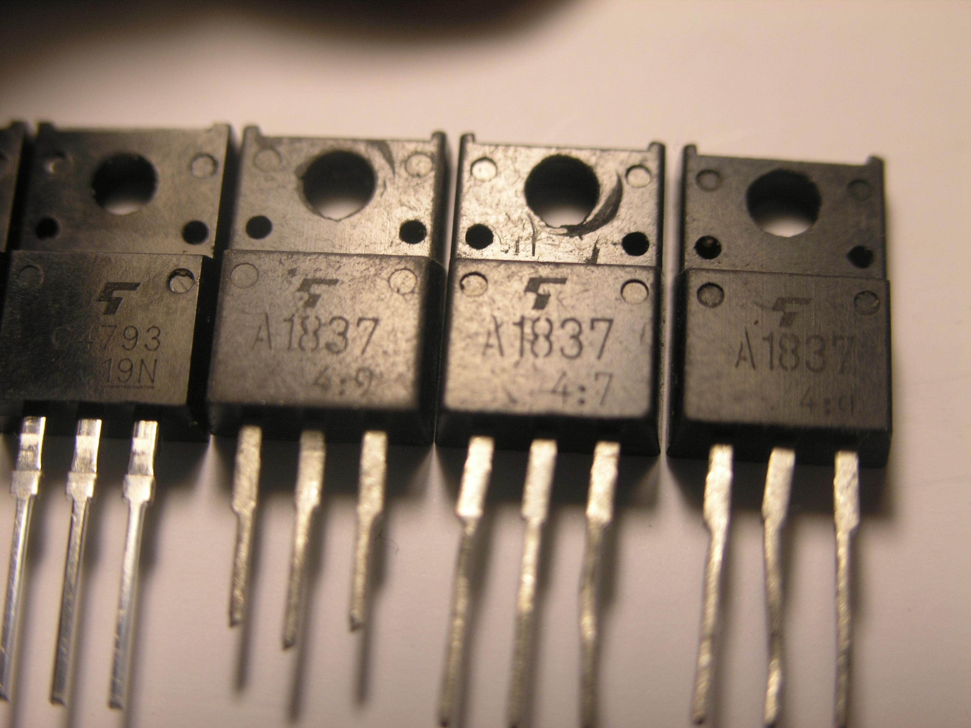

Just bought a few of the 2SC4793 and 2SA1837 myself. Not used the supplier before and they were very cheap so nothing ventured...
They measure within the ranges from 130 to 160 HFE for both components. If they are thought genuine I am happy to share the source.
Best to all.
Best to all.
Hi Jotom,
Try comparing yours to the key features on my genuines. There is also the angle of the cut on the pins. Genuine is angled and yours are straight perpendicular. The laser etched labels on yours do not look right. They have a clear left right faster pattern and the genuines are more uniform. Look for exposed copper at base of pins. That’s a good one. The fakes are tinned 100% before they were encapsulated with the body.
