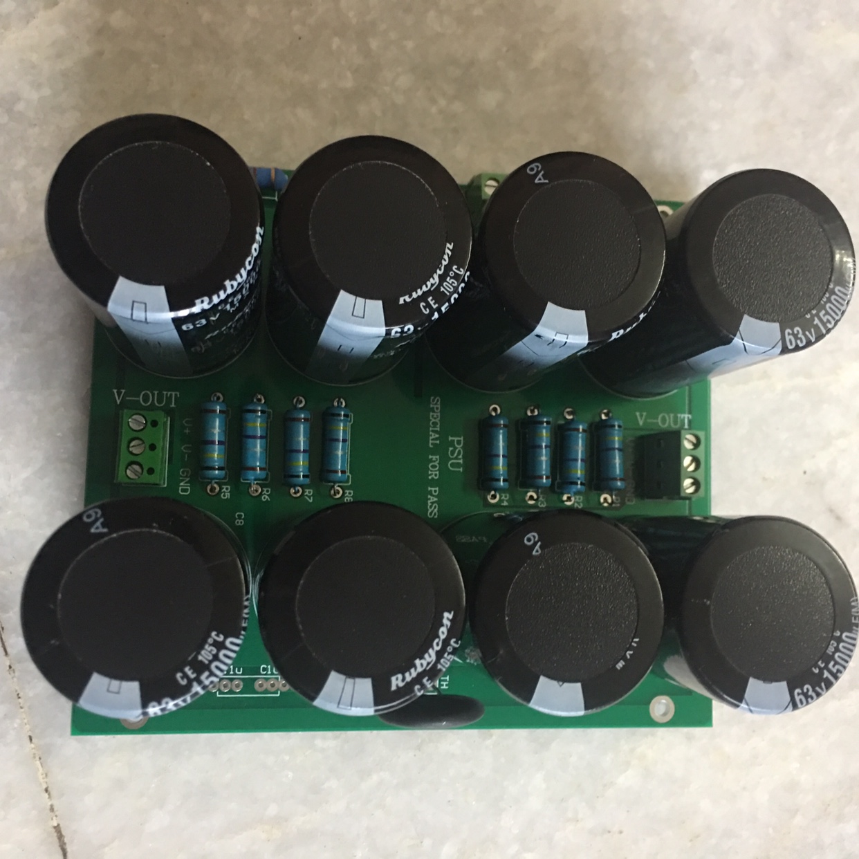

Unfortunately my psi left channel is not working 🙁, will post the results of alpha20 once after getting the psu ready

One more thing regarding the psu left rail fix, do i need to change the R values (would that have gone?) or any things to check?
Am using the crc psu
No, that's fine. Just change out the active sensor resistor for 0.47R, should liven up proceedings.......
