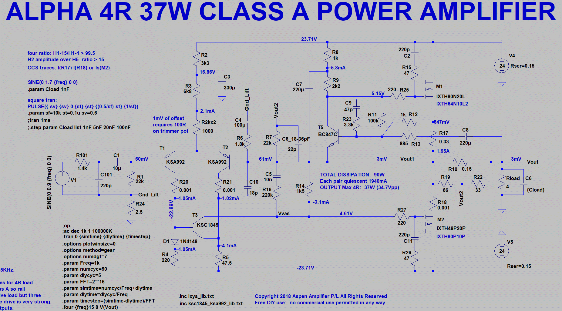

Here's the version that will be choke powered.
I'll run it also at 1.9A with a 0.33 source resistor
Other changes:
- added a voltage/FB divider 66-33ohm over the 0.15 output/FB resistor,
this doubles the damping factor
- changed the 820r shunt FB resistor to 1.8k for less gain and 4R stability
- added a ground lift to the input signal,
for this I needed to cut 4 traces (left of c111 and above r101, both sides pcb),
soldered four 10r resistors over the traces cut.
- use of IXYS IXTH64N10L2 and IXTH90P10P
- added snubbers 220p-47r to both mosfets

Very nice! Can you hear the difference with the snubbers and increased damping factor? I'd imagine damping factor is very important when driving larger woofers...
I have built mine with 2.2K for the shunt FB but I would like to change it for lower value to yield higher gain because my source (DragonFly Black V1.5) peaks at 1.2 RMS. What value would I need to achieve full power with 1.2Vrms input? I am using 100uF for C111 and would like to keep it unless it really needs to be changed.
Assuming you want 35w into 5ohms, that’s 37Vpp. If your DAC puts out 1.2Vrms that’s 3.4vpp. You only need 11x or 21dB gain. The Alpha has more than 21dB gain so you should be able to hit 35w no problem. That’s the stock Alpha with 820R feedback shunt. As you set yours at 2k2 the gain is (22k+2k2)/2k2=11 or 21dB exactly. You are marginal so maybe drop 2k2 to 1k8 and you should be able to hit clip.
Yes, I have also installed 1k8.
The snubbers are just preventive to avoid oscillations, they're soldered directly on the mosfet pins.
The increased damping will definitely be noticeably with my double 10" woofers.
Also with 4ohm speakers the damping factor is halved compared to 8ohm speakers.
So with this trick the DF for 4ohm speakers is the same as in the original Alpha20 with 8ohm speakers.

According to the schematic, the impedance is 22k as set by R102.

It depends on what the impedance is and what you consider flat deep bass.
For an input impedance of 22k set by R102, the characteristic RC time constant is 0.7RC or 0.7x22000ohmx2.2uF=34mS or about 30Hz. That’s the -3dB point. I would aim for a value of 10Hz -3dB to make sure there’s not too much attenuation at 20Hz.
10Hz = 1/(0.7 x R x C) solve for C
C = 1/(0.7 x 22000ohm x 10Hz) = 6.5uF
So 6.8uF is what I think is needed if you want flat to 20Hz.
