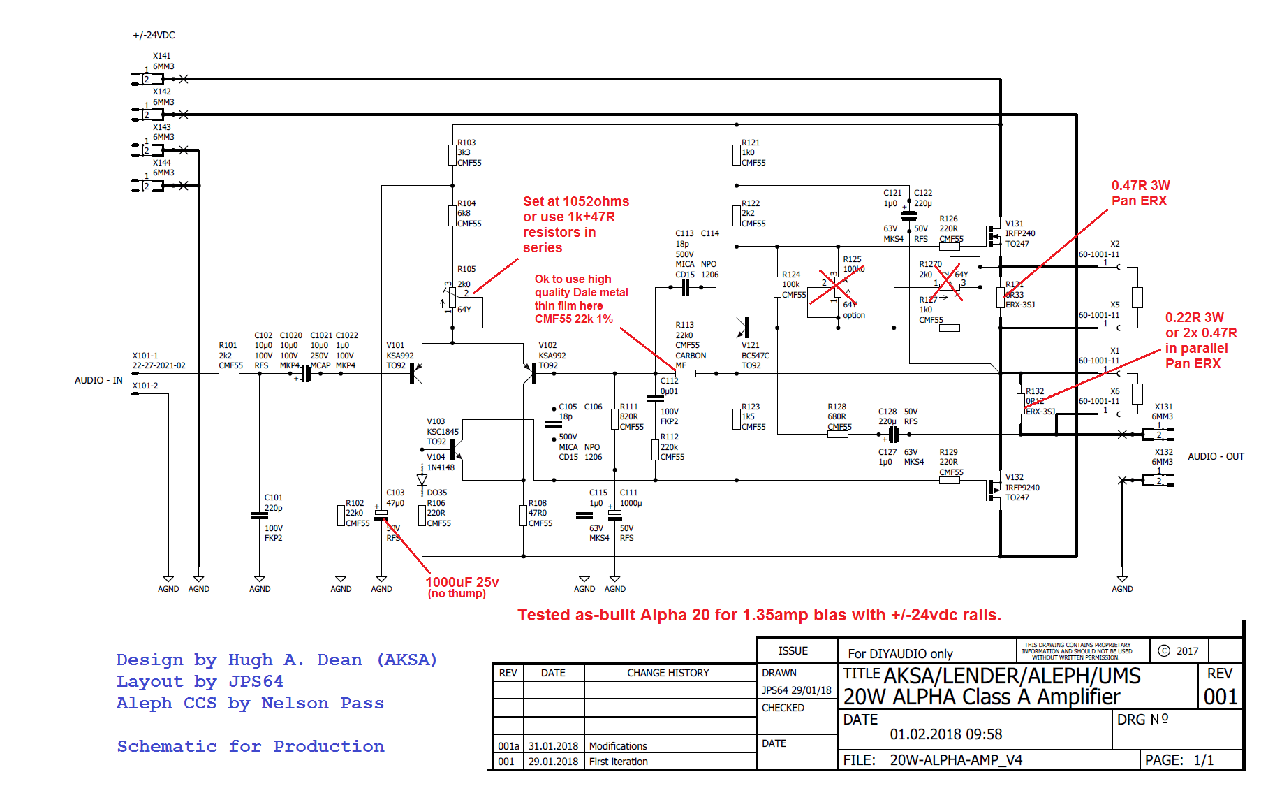

Hi guys,
I have read all your treads for this amp and and I appreciate the goodness of it.
I would like to ask you if you think it is possible to make a version with power transistors without many problems and obtaining the same results?

Yes, XRK is correct, a new amp with quite a few changes to use bjt outputs.
In truth, I would use Sanken darlingtons, excellent transistors......
HD

Thank you Carlo.
Even the experts disagree on bjt vs. mosfets!!
The advantage for Class A is that mosfets are superb in high dissipation areas. They do not suffer from the 'hot spot' issues with bipolars.
You could try simply replacing the mosfets with Sanken darlingtons (2SD2560 npn and 2SB1647 pnp), it will work, but there might need debugging.
These are relatively inexpensive devices and presently available. In principle the replacement would work.......

Carlo,
+/- 32V DC is too high for the ALPHA 20.
If you use a cap multiplier circuit, you will be able to drop 3-4V DC, and that should get you close to +/- 27V, which is suitable for the ALPHA Nirvana amplifier that has an output of 39 watts @ 8 Ohms. However, the AN amplifier will need bigger heat-sinks vs the ALPHA 20. And the ALPHA 20 is also an easier amplifier to build.
Please note that you will require a dual-rail power supply that gives both + and - voltages.

Hi, Zman01
A protective multiplier circuit would be an extra complication. I don't think it's worth it and I don't care about the 39W version. At this point, I might decide to built the ALPHA 20 version (20W into 8 Ohm), with its right power supply.
To do this, I only ask for your help in one thing. I have read all your posts and, definitely, after all the improvements, the replacement proposals and more, I have lost the true face of the 20W 8 Ohm version.
Would it be possible to see a final version published that contains all those improvements? I would be grateful.

Founder of XSA-Labs
Joined 2012
See post 1 of this thread. The “as built” verified build with all notes and components specified.

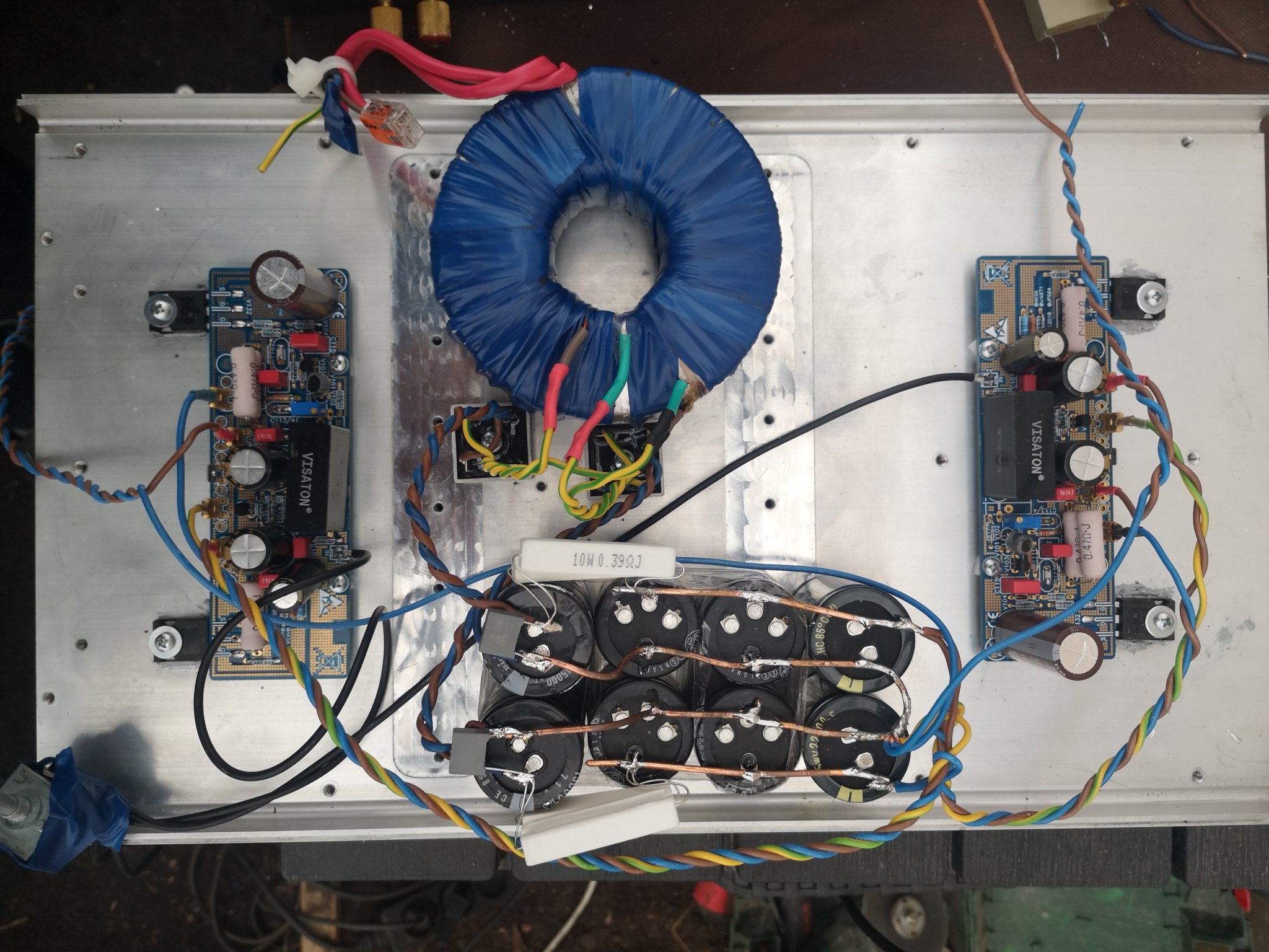

Hello, I have build aksalender 20w amplifier. Part list from BOM file. I have big thump when powering amplifier, and small humm. Trafo 250w 2x20V. Psu kbpc3510 15mf-0.2ohm10w 8.2mf 8.2mf 22mf. Maybe psu capacitors capacitance too small, i will buy 22mf per rail tomorrow. ? I tried diode bridge ground braker, shorten inputs,
