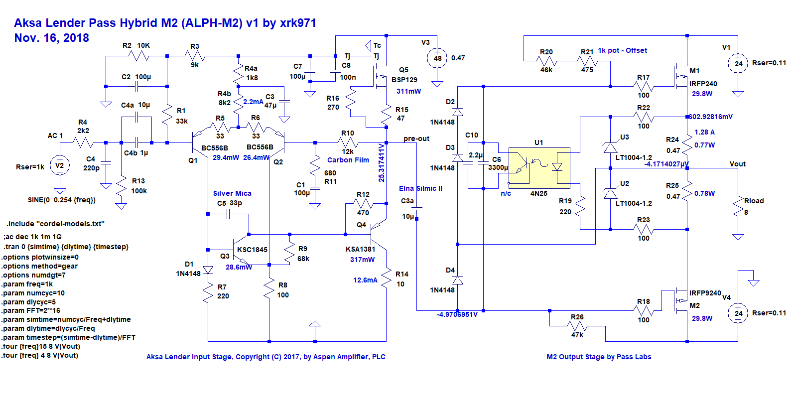

Following in the foot steps of the ALPHA amp, I have hybridized the Aksa-Lender input stage with the output stage of the Pass M2 amp. Instead of the un-shielded auto-former that provides the 6x voltage gain (but is susceptible to EMI and hum pickup), I have used the Aksa Lender preamp to serve as the input stage and the voltage amplification stage. The Pass M2 output stage has a self-regulated slow-ramp bias scheme which makes it really nice for easy setup and no turn-on speaker thump. Some people may feel the magic of the M2 is in its autoformer, but I for one had a lot of noise issues and it has never been as quiet as I would like even when using mu-metal shielding on it. I got noise down to about 400uV rms at the output. But if I pressed my ear to the speaker cone, some residual noise was still present. Overall, i think this will be a wonderful match as the output stage has no global negative feedback, and the input stage has very low negative feedback (local). This should make for excellent soundstage, imaging and a natural engaging sound quality.
As the M2 power output stage is already capacitively coupled with a 10uF electrolytic cap per the original M2 design, so it was a simple matter to add the Aksa Lender front end. This has another benefit in that circa 15dB gain of the M2 basically always required a preamp to drive it to achieve the full range swing for 25wrms. Now, setting the gain of the input stage and VAS to 25.4dB, the ALPH-M2 needs no preamp as it is built-in. I do recommend a separate single rail power supply for it which can easily be drawn off the existing +24v rail through a step up DC-DC converter and cap multiplier CRC combo as is customarily done on the Aksa Lender preamp. I may add a custom on-board DC-DC step and cap mx for the front end PSU as that is not that hard to do with just a small handfull of parts.
Here is the LTspice schematic:

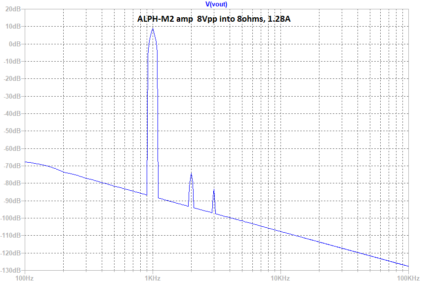

Here is the predicted FFT for 8Vpp into 8ohms - signature is pure H2 and H3 like a good SE Class A amp:

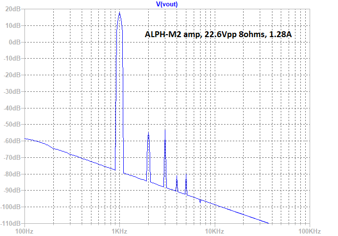

Here are the predicted components of the distortion for 8Vpp into 8ohms, about 0.007% THD and mostly H2 and H3. This is with the usual 1.27amps bias current and +/-24v rails:
Here is a louder playing level of 8Wrms, THD is about 0.01%:

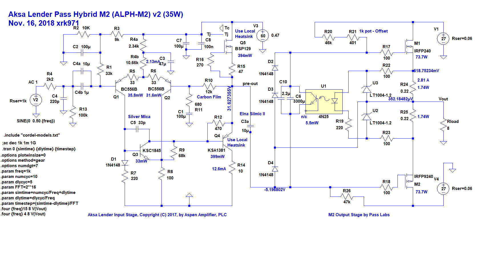

Interesting mod is to run at +/-27v rails, use 60v for front end, and change R24 & R25 to 0.22R for 2.8A bias and 72w dissipation per MOSFET. Then upgrade outputs to larger die IXYS MOSFETs used on Alpha BB amp. Now the amp becomes a 35w Class A. This is a significant improvement in headroom over a 25w amp.

Here is a 35w variant with +/-27v rails and 2.81A bias current:

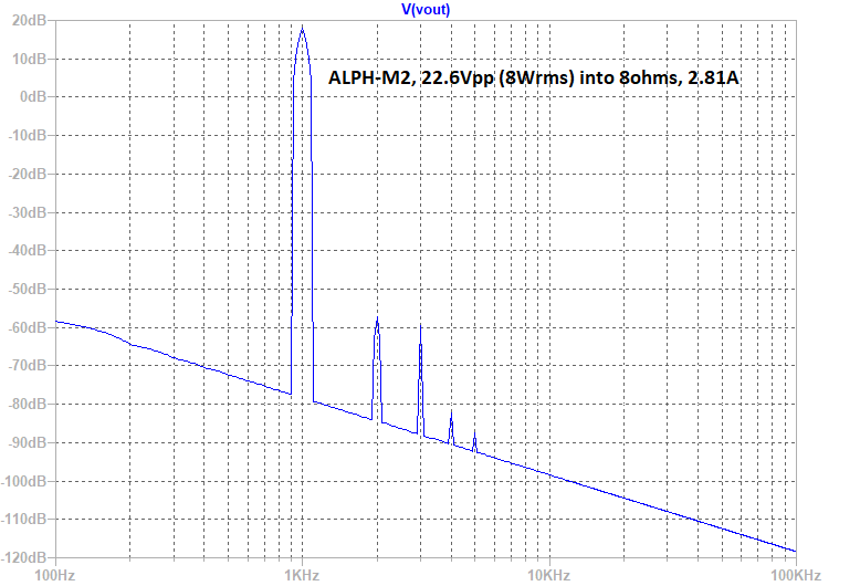

Here is predicted FFT for 8wrms into 8ohms, looks much better now:
Here are predicted distortion components and THD is about 0.02% but dominant H2 and lower H3, 8wrms into 8ohms:
For 1W into 8ohms is is now 0.005%THD
