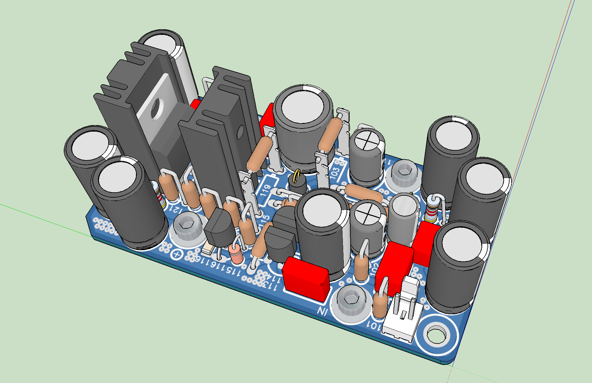

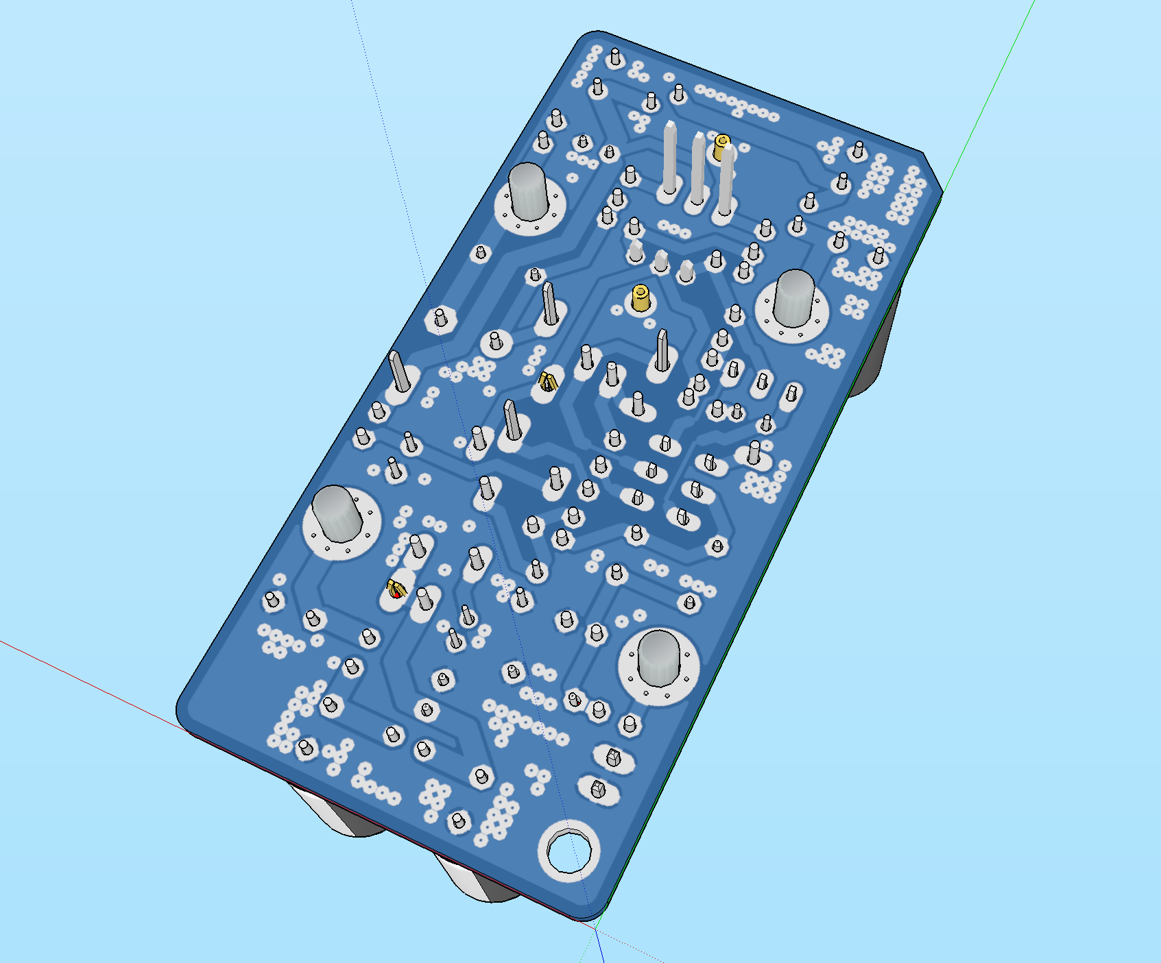

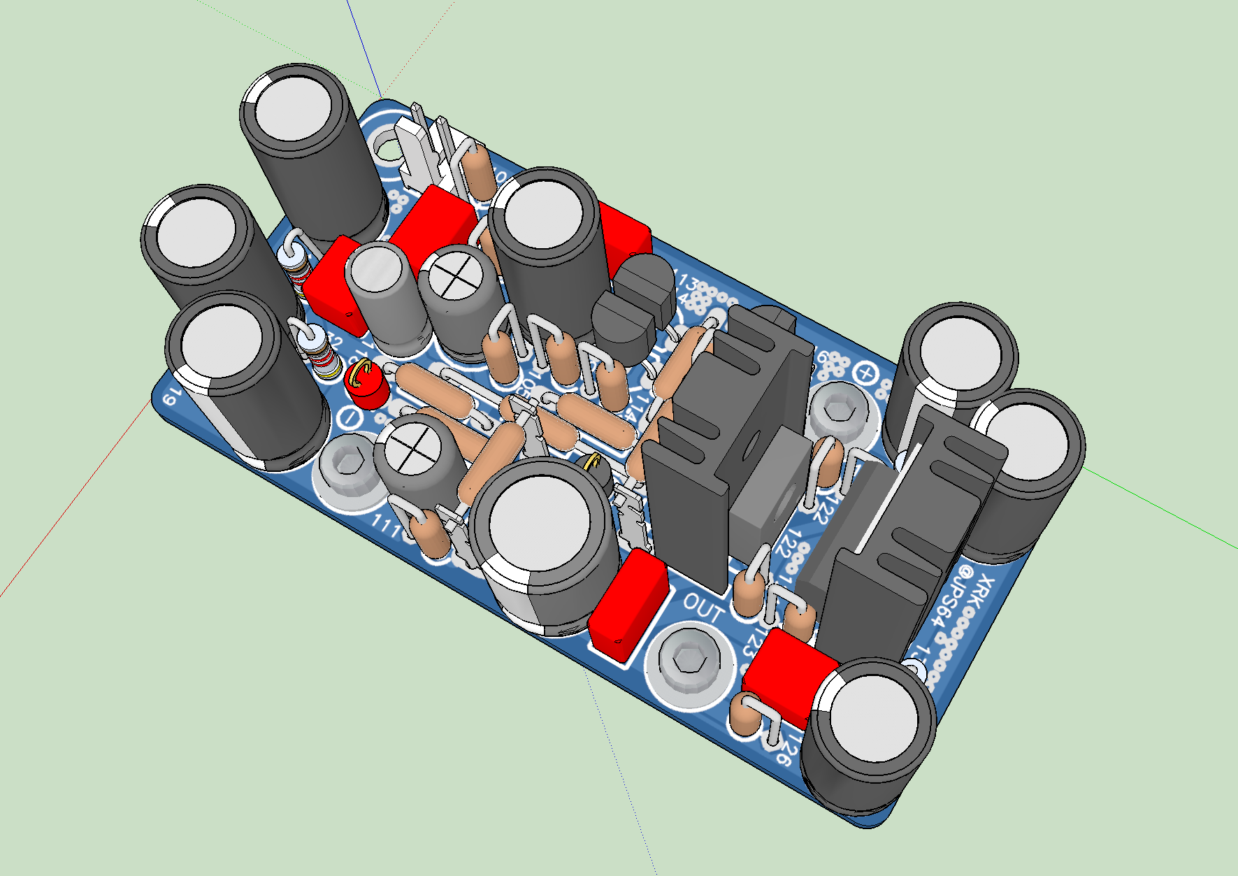

M2X Melbourne TH Daughterboards v2
Update: JPS64 finally had time to rework the error I had on the Melbourne daughterboard for the M2X. Here is what it will look like. Some stuff has been moved around for more optimum placement of parts. The heatsinks will now have more room to breathe and stay cool.
attachment.php
attachment.php
attachment.php
Founder of XSA-Labs
Joined 2012
