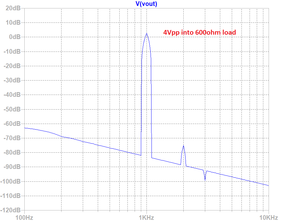

I missed that thread - thanks for the link. Ok, so I already looked into the worst case of 600ohm load so we need to boost bias current a bit. The Aksa Lender can drive 32ohm headphones when configured with 100ma bias current.
Re-ran sims with 600ohm load and here is what I get for 4Vpp - same bias current as before (no changes to circuit). 4Vpp with Edcor 6x gain is about 8.5wrms:
attachment.php
Predicted distortion components here with THD about 0.014%, still great looking profile:

Total Harmonic Distortion: 0.013278%(0.053681%)

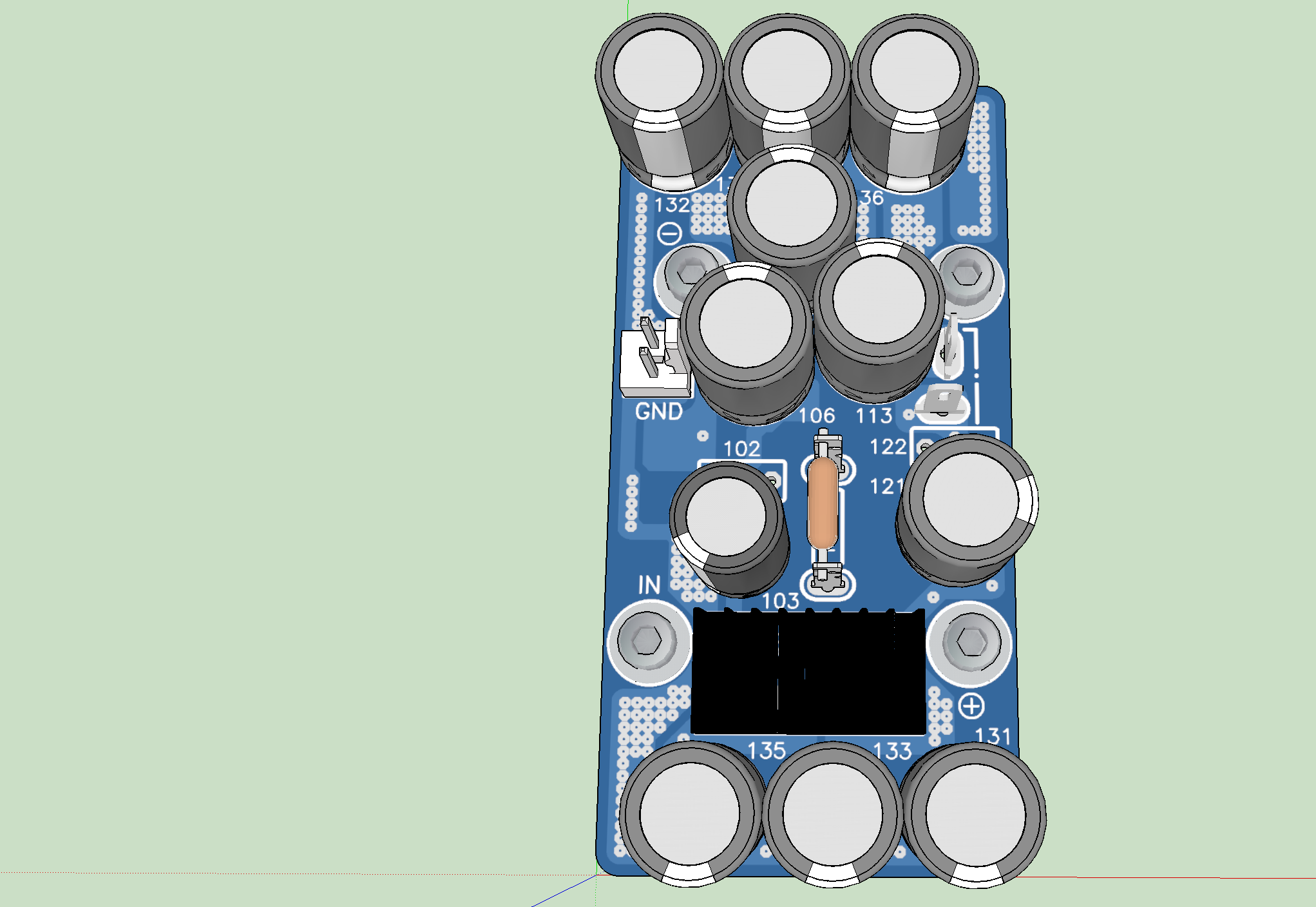

JPS64 and I are in the designing the layout to be compliant with M2X and still fit into a case and be UMS compliant as well. We may have to go beyond the original DB’s 40mm x 35mm outline in order to fit a much needed CRCRC power rail filter for the input stage as it will be DIR en directly from relatively noisy rails. Something like this:
717093d1542836023-diyaudio-watt-m2x-aksa-lender-m2xdb-melbourne-outline-sketch-jpg
If you have comments or suggestions on how to extend board, let us know.

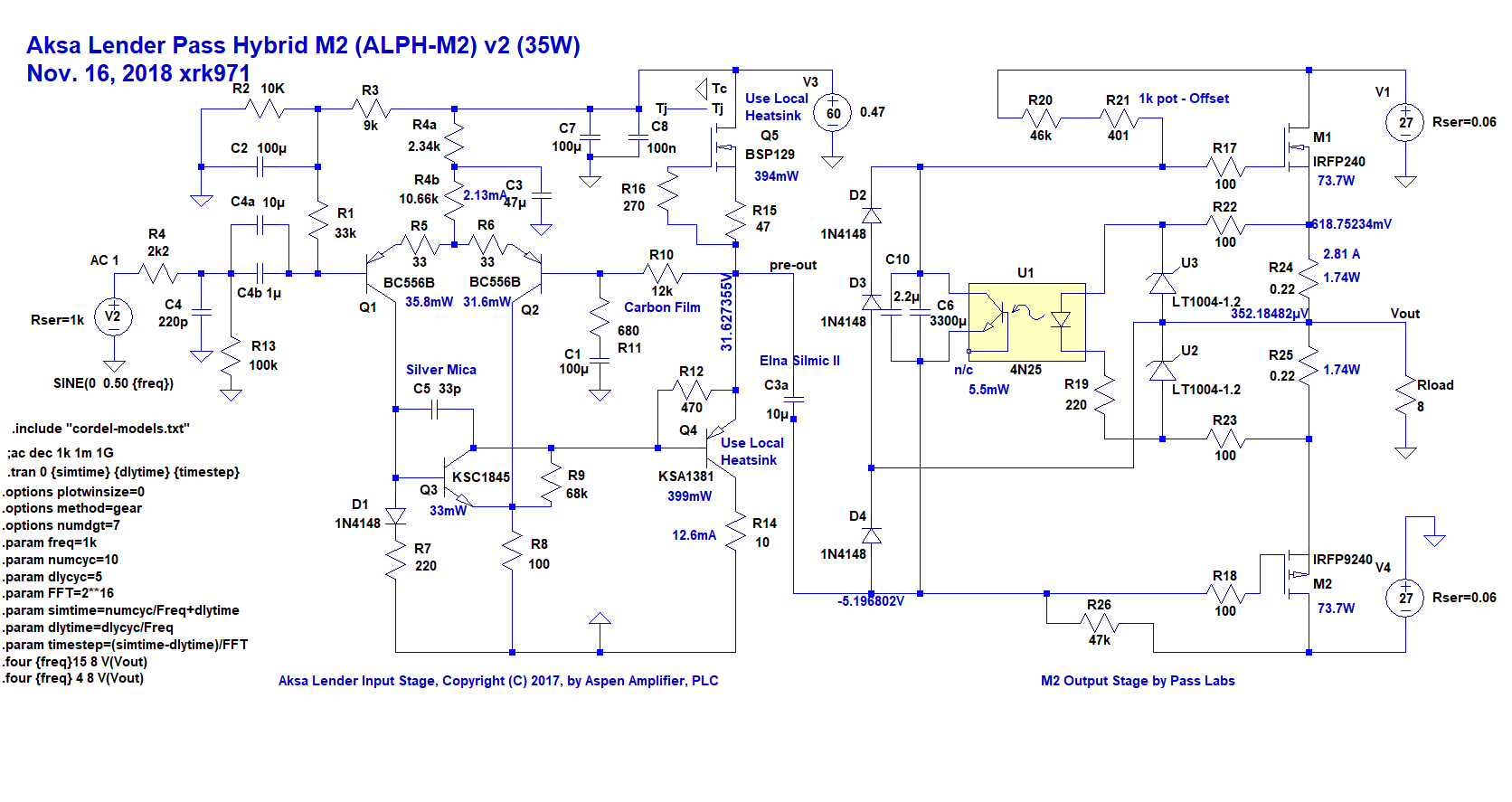

The ALPH-M2X will be a new amp with integrated Aksa Lender front end and negative feedback loop with the opto-isolator controlled push-pull output stage located where the depletion mode CCS mosfet would have been and a PMOS locates where the PNP BJT would have been.
Here is a 35w variant with +/-27v rails and 2.81A bias current:
715990d1542412975-aksa-lender-pass-hybrid-m2-alph-m2-amp-alph-m2-schematic-v2-35w-png

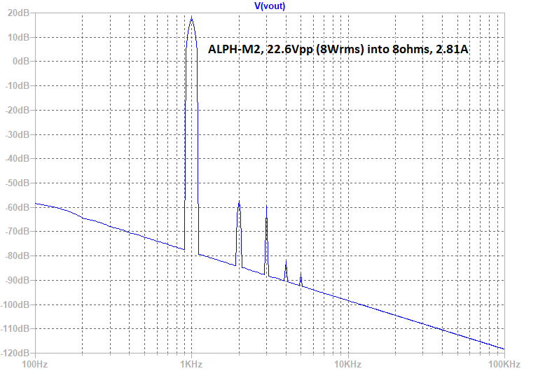

Here is predicted FFT for 8wrms into 8ohms, looks much better now:
715997d1542413562-aksa-lender-pass-hybrid-m2-alph-m2-amp-alph-m2-fft22-6vppv-2-8amp-png
Here are predicted distortion components and THD is about 0.02% but dominant H2 and lower H3, 8wrms into 8ohms:
For 1W into 8ohms is is now 0.005%THD

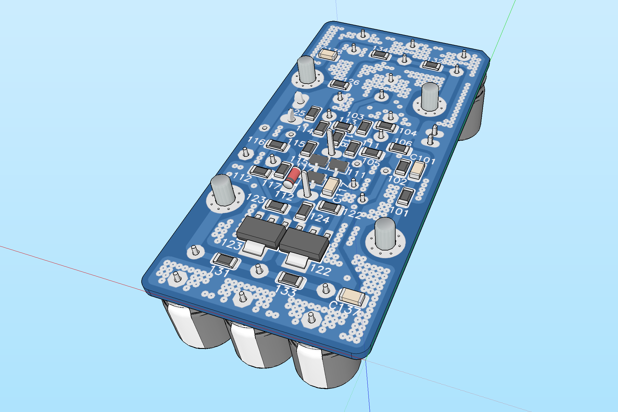

The SMT version is coming along, and you can see JPS64's artistry here. We are getting closer but still working out a few issues with keeping the cap sizes as small as possible by using close to actual working voltages needed rather than over-specifying them. The topside of the outputs are getting a small stick-on heatsink to help dissipate some of that Class A heat (circa 750mW).
Here are latest renders.
attachment.php
attachment.php
