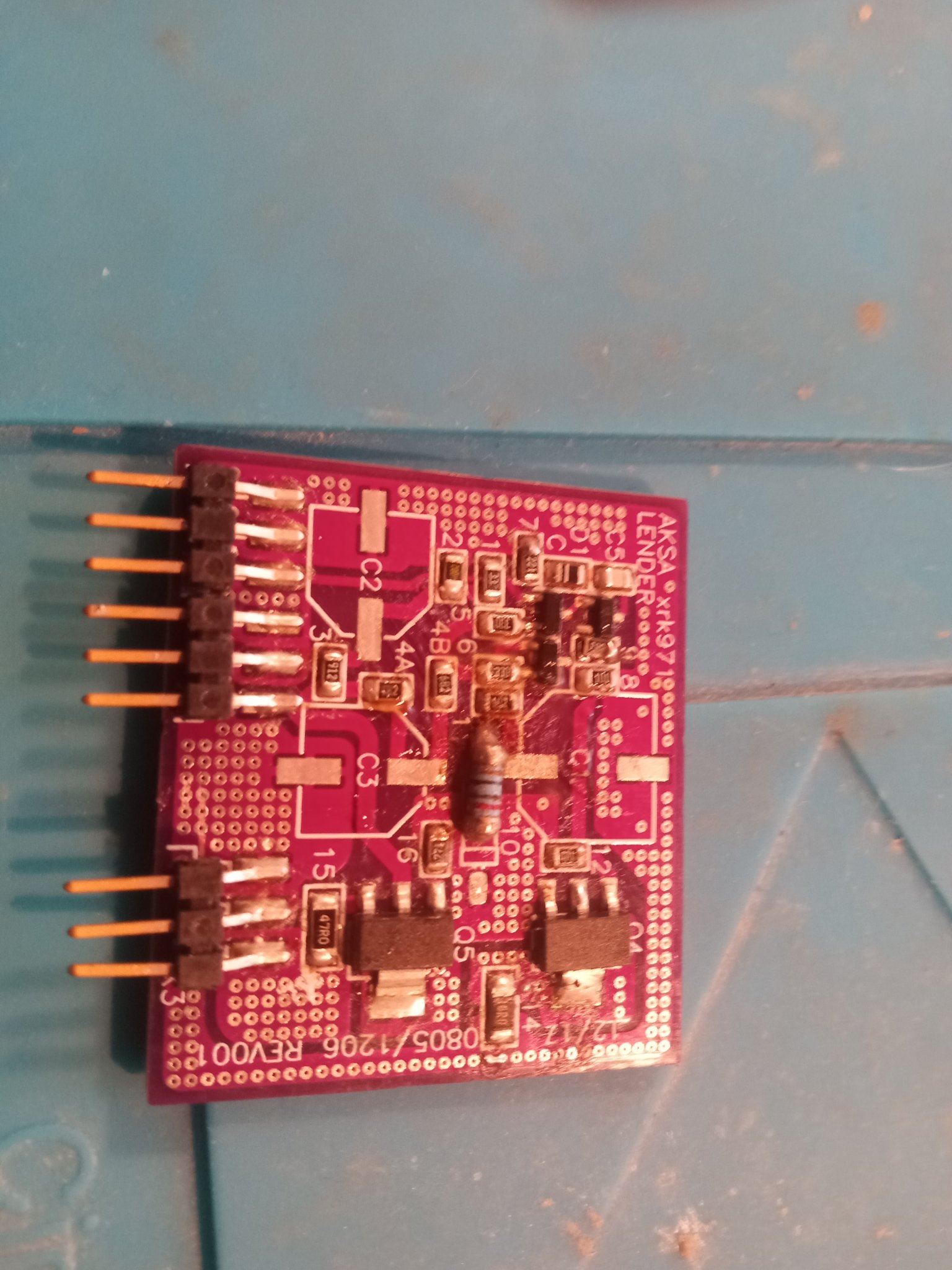

Hi X,
I got one of the ALP 0805/1206 boards soldered up using the skillet/solder paste technique. It worked pretty well, only had to do a few touch ups. I heated up the right end of the R10 10K carbon resistor to reposition it, and as I was pressing on it with the iron it moved, but the solder pad came with it. I managed to get it soldered again, but it looks flimsy.
I checked for continuity with the bad end of R10, and there is no continuity to R12 & R16. There is continuity with R12 & R16 from the pad at the right end of R10. I think the pad was made in case a long resistor was used. I would like to solder a resistor lead from R10 to the pad. I think this would solve my problem with R10. Any problems with this ?
Please see pic attached, and thanks for the help.
MM
