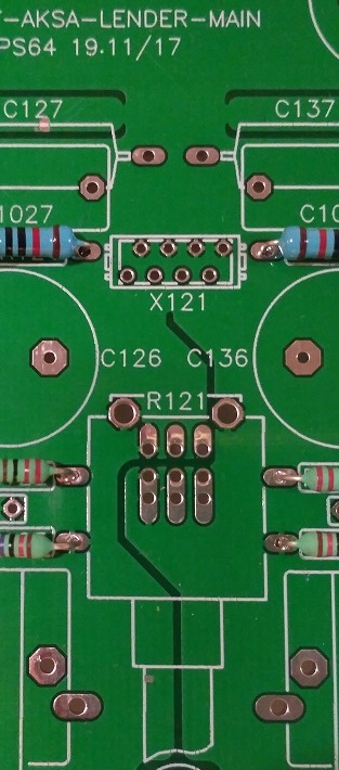

Could someone please help me with the wiring of the pot? I want to use an attenuator not soldered onto the pcb, but I am unsure where the in, out and gnd must go on the pcb. Googling the pinout of the proposed Alps RK09L did not give meaningful info.
I think I have it figured, but could you also please confirm the pinout of X121?

Rows left to right from above:
GND/Left-out/Left-in
GND/Right-out/Right-in
Out is connected to wiper.
And what is the fourth hole for?
You mean extra row? That’s to accommodate two different pin row spacings. Third row on bottom is same as second row. Two big holes for metal support bracket.
Sorry, I was looking at wrong connector (X121).
X121 is top row all GND,
bottom row: Left Out/Left In/Right In/Right Out.
Thanks X. Not building yet, but I'm planning to connect two pots via shielded cable so that I can have balance adjustment - like on the B1. Channel balance is important to me.
Thank you X - to the rescue as always! I see that it corresponds to the Alps RK27 pins which I have hot wired before, but somehow I doubted when I looked at this pcb. At least my feeling about X121 was correct. My confidence is now restored.Rows left to right from above:
I don't want to make any mistakes here - these boards are sooo nice. Had to de-solder the incorrect diode on the motherboard and that was painful enough.
