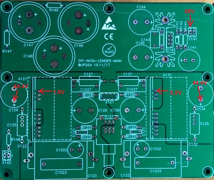

Short fixed and thank goodness no damage. And yes you are correct X - the mosfet (IRF610) is still fine and it seems like the Cap Mx is also working correctly. However, there still seems to be a problem as I am getting strange measurements (without daughter boards). The picture shows an unpopulated board, but with the points where I made some quick measurements. Left and right is different, so it could be incorrect polarity on one of the caps maybe? I will have to lift the board from the enclosure since most of the electrolytics are mounted underneath to make space for the daughterboards and biggish heatsinks. Will post more photos later if I still cannot find the problem.

Don’t worry about odd voltage on pin 9 (top one) that’s just the residual voltage you are measuring on the output cap.
Measure pin 6 and that should be same as 44.5v.
I think you are good to go.

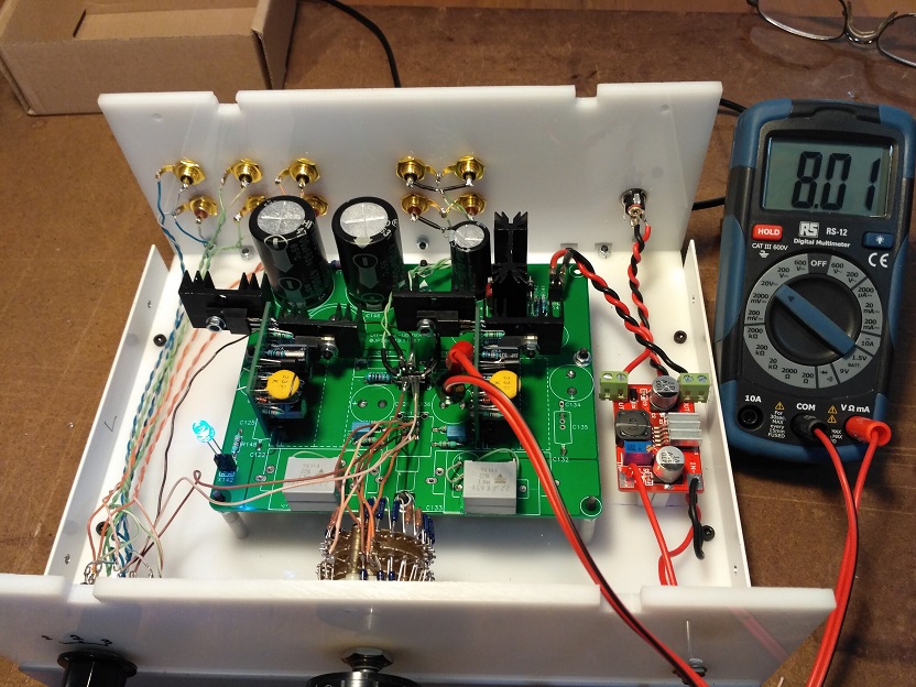

Yes, some good news and bad news. The Lender is (sort of) working, but I am very confused here about the bias. I measure 8V across R10 (10k) on both channels – is this normal? The problem is that the Lender seems to have less (or same) gain than my B1 driving the ACA. My Lender is stock standard except for:
Q4 = 2SA1837 (iso KSA1381)
R11 = 2k2 (iso 1k0), could 2k2 be way too much for R11?
The other problem I have is with this el cheapo 23 step attenuator - it is the biggest piece of rubbish I ever bought on Ali. It makes the most horrendous shorts while turning. Should have used the money on brighter color input caps. I saw some nice purple ones earlier in the thread.

Don’t worry, we will figure this out - there are no fragile parts except the DN2540 which can get zapped by ESD.
You can debug the daughterboards outside of main board on the bench with alligator clips to the power pin and ground pin to check and set bias etc.
If you measure correct bias outside on bench. It will work correctly.
Two places to check bias: the main outputs at R15 as you said. And also check bias of LTP at either R4A or R4B.
If using 2SA1837 - this is the HPA mod, increase bias current (from 20 to 100mA) by changing R15 to 11ohms 2 x 22 ohm 1/4w in parallel or use 10ohm 1/2w resistor. Decrease Vcc at amp (after cap Mx to 24v). If not enough gain change R11 back to 1k. Drop R14 to 2R2. Is R10 set at 10k?
Either way, 5x gain would have added 14dB gain - way more than 0dB of B1. Looks like your Preamp was not working and it may have been incorrect bias for upgraded 2SA18237.
