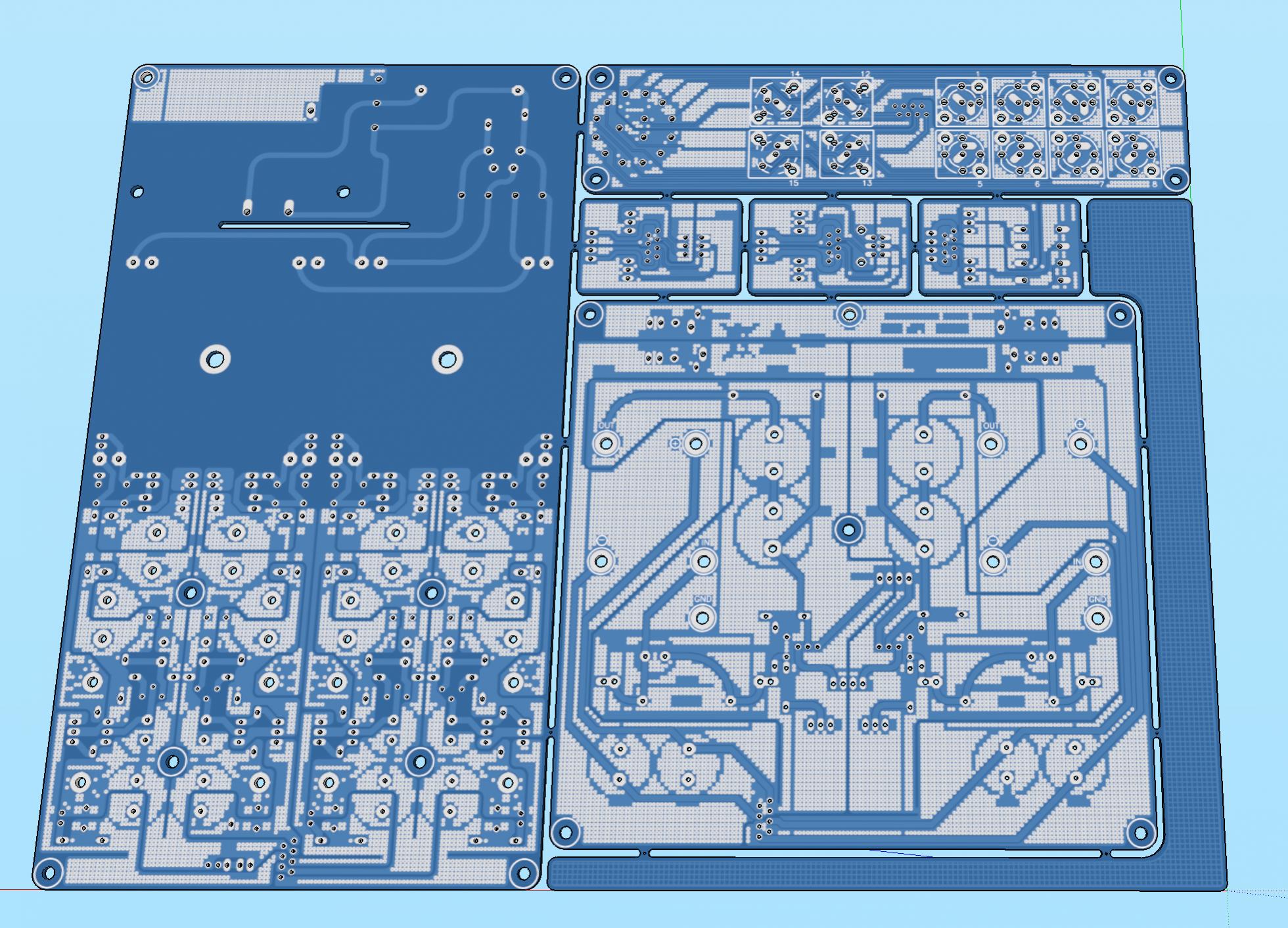

If anyone wants to build the new dual rail version of the Aksa Lender Preamp called the Melbourne - there is a GB going on now. Each little board is self contained and has its own CRCRC filter even. Just needs +/-24supply andnconnect input and output - so very versatile. It uses the M2X standoff and bolts format for input and output and voltage rails. It’s a very capable headphone amp as well and thus driving a 600ohm (design load as Edcor transformer on M2 presents a 600ohm load) as a Preamp is no problem. Output is optionally DC coupled if one wishes. Dc offset within 10mV or so depending on components and tweaking.
I’ll keep it open for a few more days still. In the meantime, JPS64 is making a new motherboard for it and it will use dual linear potted 10VA trafos with BJT cap multiplier for an integrated amp that fits in a 1U case.
Melbourne Daughterboard for M2X
The daughterboards are also pin compatible with the Mark Johnson M2X Class A speaker amp.
734405d1549477964-aksa-lender-pass-hybrid-m2-alph-m2-amp-melbourne-th-v2-top-1-png
The idea is that JPS64’s new motherboard will integrate all of this and reduce the clutter.

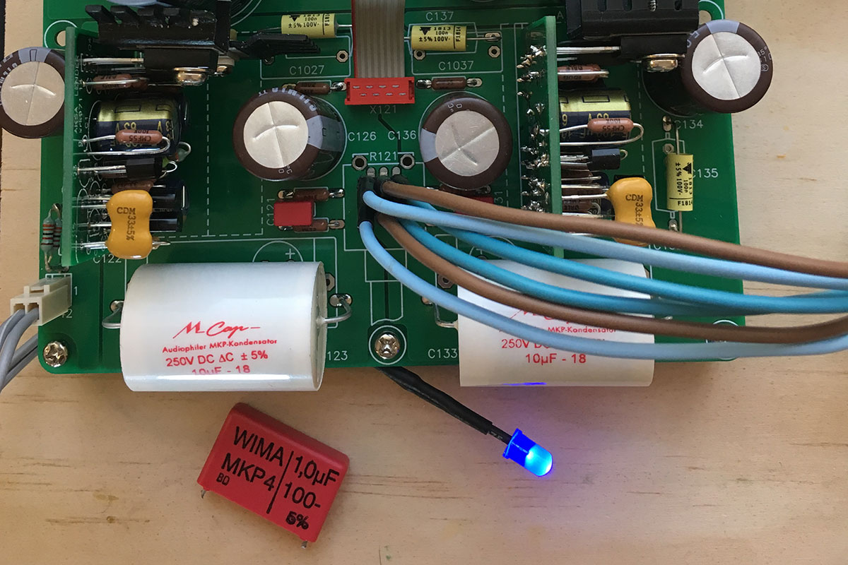

Finally, the Mundorfs arrived and installed them.
Sat down to listen to a few CD's and sounds good.
Unfortunately, adding the Mundorf has made no change to the cracking in the speakers if the volume is slightly above normal (no way I'm trying to make it very loud). It's sounds like the tweeters are crackling just above the normal volume.
That's a bit of a problem because the various of CD's have some different income volumes. If I set the volume up for quiet CD's it will make crackling if the next CD is starts.
So, is the problem something with my Lender pre-amp, or does the Pass ACA causes the crackling sounds when the volume is at the PASS AMP's limit?
Founder of XSA-Labs
Joined 2012
If the sound happens only on high crescendos then it sounds like your ACA is clipping. You can tell if you connect a more powerful amplifier and crackling goes away. ACA is limited to 5w rms for 19v supply. 5w is 18vpp. Tweeters often draw high voltage transients on crescendos. You will hear this with soprano female vocals on opera, or piano played fortissimo or trumpets at full blast. The crackling is not caused by the Aksa Lender - but because Aksa Lender permits the 14dB gain of ACA to be driven to clipping levels.
An oscope will show clipping easily.
Thanks for your response.
Ok, will drag out our old amp and test it. That sounds to be the problem, always has the tweeter making the crackling if the volume is up.
Next question: It sounds I will need more amp power. Can get another Pass ACA, would it make enough power for a variety of speakers or should I swap to something else with higher power to build? Would want something that sounds as good as the Pass.
