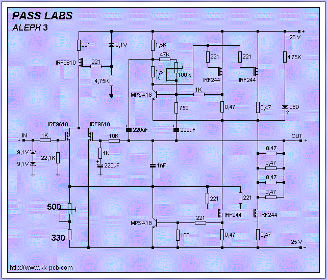

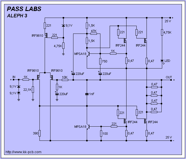

I am a happy owner of this amplifier, built with my own hands, reading here in the forum I saw that you can make some mods .
Here are my questions :
1) do you need to increase the supply voltage if you want to use max bias?
2) it is possible to implement ccs modification of W.Newby ?
That is all for the moment. 😎

- clarify No. 1 - what are your intentions and give us details of your amp
- I think I know exactly what you mean with Newby tweaks , but link to exact thread could help other members/readers ; most imoprtant thing you can easily make on your amp is putting that 5V6 zener across small bjt in Aleph CCS , that cures almost everything needing cure
Thanks ZEN for your kind reply.
N1 I would like to raise the bias as much as possible. on this topic: Top ten ways to a better Aleph? ,
there is also talk of bypass the resistance to set the bias. My intention is to exploit all the possible changes on this circuit to make it better .
My A3 clone is powered at 25v as the original schematic.
Using active cooling, I would like to set the max bias
as Dady asked - which speakers ?
and , give more specifics of your clone - number of output mosfets , dissipation you have now ...

My speaker Klipsch heresy II , output mosfet are 4 , 2 positive and 2 negative , my dissipation is 30x22x5 cm and fan cooling .

wasn't asking for dimensione di dissipatore , I was asking for rail voltages and standing current (Iq) , which multiplied is quantità di calore (V x A = VA= W)
so ?
I hope I understand correctly, the rail voltage is 25v, and the rest current is 1.06A .
WxA = 26.6 +/-
WxA = 26.6 +/-
so , you're having twice 25Vdc (meaning +25 and -25V) and standing current 1.06A per one mosfet vertical pair , which is 2.12A per channel ?

change drain resistor under LTP , put two trimpots
for instant increase of Iq for +25% change ALL 0R47 resistors to 0R33
100K trimpot is (increase value ) for increasing of Iq
500R trimpot is for DC offset setting
in any case , do not go above 40W per mosfet ( that's rail voltage 25V x Iq)
in any case , above that is not wise to go , simply because then you need higher rails for more juice ..... with more output pairs etc.

I was about to write it and you preceded me. These changes have been made. I wanted to know if to increase Iq we have to increase voltage rail?
Increase Iq will not you lower the voltage rail? Because of the increased absorption?
