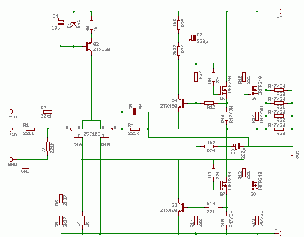

Not sure if u lost an "o" somewhere out therePapa's schematic is god enough

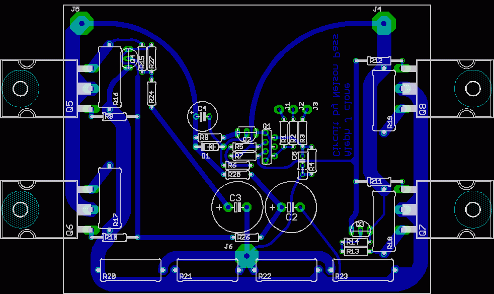

Aleph J PCB? Here ya go.
HBarske,
You wouldn't happen to have a PDF of the trace or gerber file for pro board productions would you? I'd like to have some (4) made for me.
regards,
Vince
Here ya go. There are two pdfs in the zip file, one with normal drill size, one with minimum (0,3 mm) drill size:
www.hb001.de/alephjpcb.zip
Cleaned up a bit, we're slowly getting towards something useful:
Bottom layer pdf: http://www.hb001.de/aj_pcb3.pdf
As said earlier, I omitted the input coupling cap for giving everyone the opportunity to tie a bulky paper-in-oil cap directly to the input jackwhat about the film cap on in -?
traw said:The Vgds max at 25 volt. What does the 3 legged fuse see in Aleph J? Anything to worry about if using 26 volt or so supply?
even 27 can be fine ;
more .............. poof!
![xeye :xeye: :xeye:](https://files.diyaudio.com/forums/images/smilies/xeye.gif)
- Aleph J Schematic
