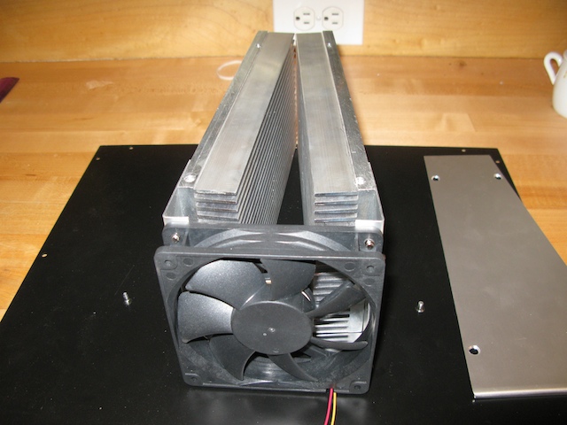

Nope.
Resulting thermal resistance number of a blown heatsink depends on the air flow and ; heatsink type, fan, synergy between the two.
A factor three reduction generally requires a substantial air speed, something in the order of >16ft/s.
Which is too high/noisy for audio purposes, a reduction of the natural convection number by half is more realistic for moderate air speed numbers.
OK, I built my finned forced-air duct and tested it. Using a somewhat crude heat source (a low power ski-waxing iron ;)) and barely audible fan speed I am getting 0.17 C/W from aluminum that should be about .33 C/W. So your prediction was extremely good, Jacco! :D No worries about fan noise at this airflow. Hopefully each stock Aleph J stereo channel will be happy with this much cooling... :confused:
Frank
Joined 2007

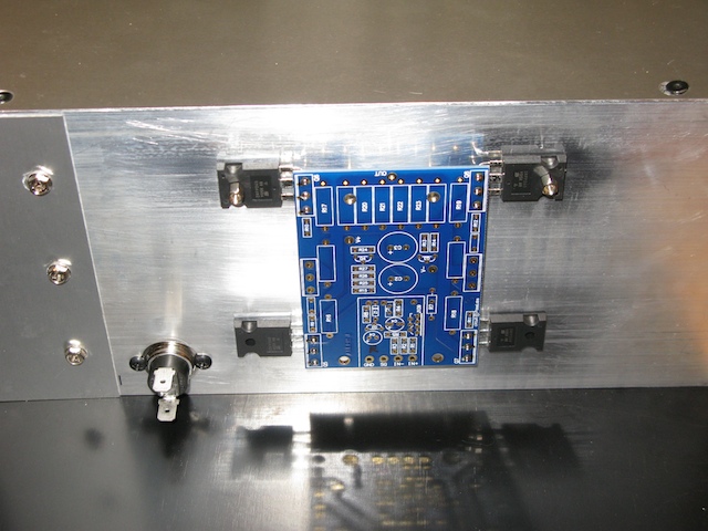

I tested my air tunnel heatsink with the Aleph J board idling and believe it to be up to the job of cooling the MOSFETs. I don't have measurements but the '5 second test' was no problem. A couple photos are attached to solicit your comments. The reason I don't have measurements is the subject of a separate post, to follow. :mad:
Frank

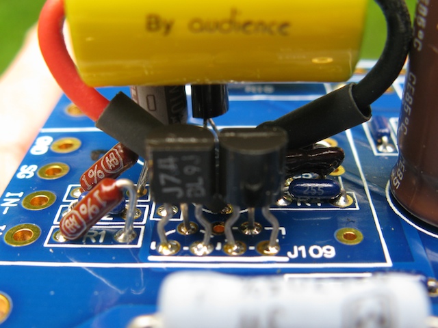

Smokin'
As a class A tenderfoot and non-ee, I need to ask advice from you generous people.
I made a dumb mistake and installed the wrong value resistors into R2 and R4 of the Aleph J. During heatsink testing, R4 (1/4 w) eventually failed and started smoking. (I should pay closer attention to the "Ks" on those parts! :eek:) At the same time, the J74s were running hot. Can I check if they survived without removing them? ...and looking at the attached photo, do *genuine* J74s have the shoulder bend in the outer pins? If I'm also replacing the JFETs, I definitely want the right parts...
Any and all thoughts/suggestions much appreciated!!! ;)
