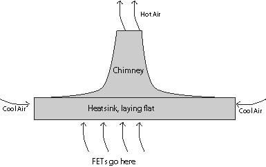

One thing I've been thinking of is building the case with some sort of chimney to generate a stack effect, like in buildings and chimneys, where rising hot air escaping from the top of the stack draws cool air in from the bottom. Building a case with the heatsink flat, fins pointing up, and covering the sink with a chimney assembly should cause an appreciable amount of flow. By my calculation a 20"-high chimney topping a 12"x12" heatsink (sealed on all but the fin edges) should cause a ~50cfm airflow. This assumes a heatsink temperature of 50 C, and an external temperature of 20 C. I can't be the first to think this would work, so:
4. What am I missing this with line of reasoning?

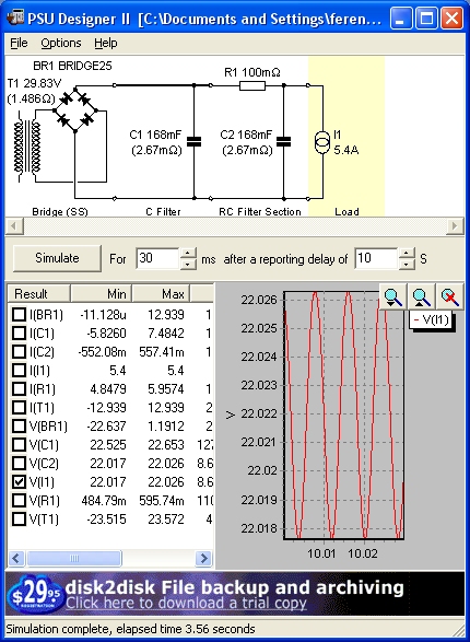

Being that I want to ultimately build a J-X I'd like to size the transformer to be good for two A-J channels or one A-JX. Antek offers a 600VA 18V toroid which, from comments here, will be under-powered. They also offer a 800VA 20V toroid which would probably be sufficient. Here's my PSUD simulation:
attachment.php
Note that the only reliable values in this simulation are the ESR values for the parallel caps (3x56mF). The transformer and current sink I'm not sure I configured correctly.
5. Can I use the 800VA/20V trafo in a CRC configuration without having to cascode (and learn how to do so, at least not now) the JFETs?

Last, with that amount of caps in the PSU you'll likely get problems with inrush currents and max diode currents. Either reduce them or think about soft-start.

The heatsinks fins should be parallel to the airflow rising against it like a chimney.

I was thinking a CL-60 in series with each primary. Not enough?

i understood the description as the fins ridges were pointing vertical, rather than the standard way so the length of the fin ran vertical, if you know what i mean. he was half way there, but not all the way unless i misunderstood

You understood correctly. What I was trying to describe was a structure where the heat rises up a chimney and draws cool air from underneath. Something like this (excuse the crude drawing):
attachment.php
The basic principle is the hot air within the heatsink/chimney structure want to escape out the top of the chimney. As this hot air escapes it draws in cool air from the sides of the heatsink that are open. These sides are normally the top and bottom of the heatsink when it is mounted more traditionally, i.e. you can see through them between the fins.
This technique is used in buildings where you want to take advantage of passive ventilation instead of pumping air through the structure using fans. I thought it may be applicable in this situation since the temperature differential is so high that you can create quite a high airflow with a reasonably short chimney.
In any case, I was just throwing the idea out there in case anyone had tried it and discounted it.
Regarding my transformer question, though, would a 20V transformer (dual secondary) produce over 24V if configured with CL-60 in series with its primaries, individual diodes for rectification (two bridges, one per rail) and CRC for filtering. Better yet, what values should I use in PSUD for:
(an explanation of how you derived these values would be great!)
  • HFA25PB60PBF diodes
  • Antek 8420 transformer
  • The current draw for the current sink
Thanks!
