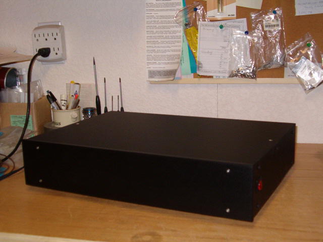

I am surprised to see that you have so many leads sticking out of the bottom of your board. Why don't you cut them off? If you don't, they might short out to the case once you have everything closed up.mjounot said:I finally have my ONO assembled . . .
I had a brief listen and it sounds good.
Iwill attempt to post photos.
What do you think guys?
Mike

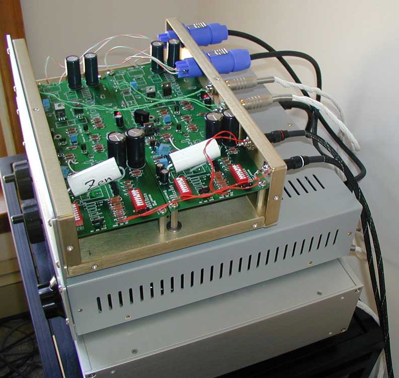

Here's a picture of my ONO, which I built in two boxes - one for the power supply (single toroid, dual power supply boards) and one for the phono stage.
---Gary
