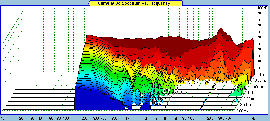

Money no object eh? How about the Audience A3, Sd=30cm2, xmax 12 mm!
One of the cleanest CSD plots I've seen...
Frequency response might need some help but this driver has Line Array written al over it ;).

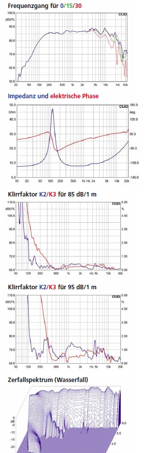

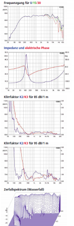

Don't know about the Celestion but FF85Wk has very little xmax. A7.3 has a funky dip at 1.5 kHz and huge resonant peaks at 10kHz and 13kHz and has the biggest fat bezel that won't let you get tight center to center spacing. I think the TC9FD or TG9FD iare great choices as Wesayso and the IDS-25 had proven. If you want to beat those drivers go with the Scan Speak 10F/8414 or 10F/8424. Same family but better performance with great CSD and smooth response and 2.5 mm xmax, not 0.75mm xmax.
Let's not forget the very well built and cost effective RS100-4. Great fit and finish and nice solid cast alloy frame with smooth response and class leading 4mm xmax.
Well class leading would have to go to the Audience A3 driver with 12 mm. But strangely enough the distortion plots of the TC9 are cleaner than the Audience when driven harder (95 dB). But with 25 of them (or more) it would probably be a minor difference.
I do wonder about the off axis response of the 10F. The TC9 does have more similarities in on axis/off axis behaviour than the 10F.
Anyone have an off axis plot of the RS100-8? The CSD of that one seems cleaner than the RS100-4 judging from Zaph Audio:
(The peak obviously needs some attention)

Nice CSD and usually those kind of drivers have excellent off axis response, though frequency response often needs help. He's had a few people over and impressed most of them (if not all) and most seem convinced enough to try the BMR's for themselves after a visit.
