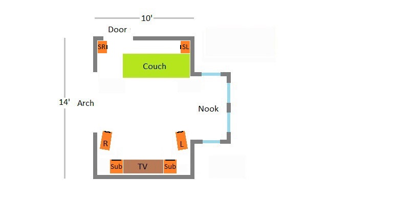

My Room
Here is the current layout of the room in a 4.2 set-up, with the Aveburys in the front and the arrays in the back. The back speaker locations are not ideal, but it does work better then You would expect. Side wall mounted THX di-poles would work good in this room. As You can see, 7 main channels would be over kill, but for movies, I do prefer 4 channel compared to a 2 channel mix down. For music, I definitely prefer 2 channel. I move the arrays from front to back quite a bit.
As some of You already know, I swap The Avebury and arrays all the time. Avebury has the tonality and DDR, and the Arrays have the encompassing, engaging sound field. My goal is to have the best of both systems for this project.
Also, I will be figuring something to do with the back wall, as it is so close to the main listening area. Right now, I have a heavy fir rug hanging up there, which does help, but more needs to be done...

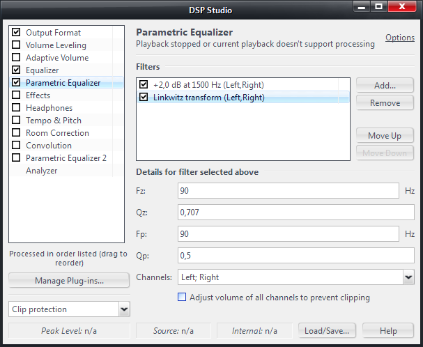

.....I would actually like to hear a given driver in the two different cabinets, one aligned for 0.5 and another for 0.707. When I choose a driver, I may experiment with this assuming it is even possible with the given Qts.
I can not see EQ making a high Q alignment more "transient perfect", just tame the Q peak, yes?
To such tests under controlled SPL wouldn't Linkwitz transform inside JRiver's DSP engine be a perfect tool.

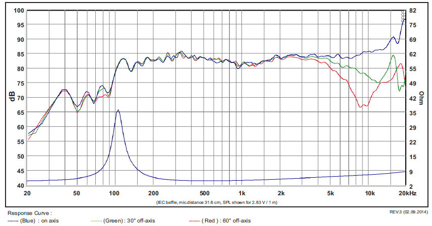

If you like the sound of an A7.3 but want a tighter square bezel and lower cost - the Peerless P830986 should be on your list to look at. It has an aluminum cone with a very large breakup peak around 12k that gives it that enhanced ring induced audibility of low level detail.
http://www.parts-express.com/pedocs/specs/264-1056-peerless-830986-specifications.pdf

...Linkwitz transform inside JRiver's DSP engine be a perfect tool.
I will need to revisit the Linkwitz site, to remember what this is all about, it has been awhile...

If add a bass line too is no problem as with the BMRs then what about 2½” SB65WBAC25-4 it could yield a nice tight spacing and has HF extension as a tweeter.
Link to shared distortion plots by 5th element http://www.diyaudio.com/forums/full...in-5in-full-range-drivers-43.html#post4257521, and general recommendation http://www.diyaudio.com/forums/full-range/268626-vifa-tc9fd18-08-best-bang-buck-21.html#post4247643.
xrk971 have a pair mayby he could make comment his experience their sound quality http://www.diyaudio.com/forums/full-range/273211-sb-acoustics-sb65wbac25-4-what-do.html.

2½” SB65WBAC25-4
That is a sharp looking driver. I could fit 40 -42 of these per channel, bringing the price to $1340/channel. This is in the same price bracket as the Fostex, so they would be compared in that light.
When I do the driver blow-outs, I can set these up as a FAST system, using my Avebury cabinets for the Lows, as that would allow me a cross-over point between 150 - 300 Hz and really good integration due to the Alpair 12. Once I found the full-ranger I like for the mids and highs, I would then find a suitable mid-bass for the bass arrays. Who knows, maybe a line of Alpair 12s.
I have not heard the Alpair 7, but I would be interested in your impressions between the Alpair and the SB Acoustics. Better yet would be impressions between the FF85wk and the SB65W. I really like the off-axis response of the SB, considering it is not a BMR.
The part I really want right with this system is the 1 kHz - 6 kHz range. I want this area clean of any "nasties" what so ever. I also want the best off axis dispersion behavior possible in this area. I do not mind EQing the response if it is solely a response issue, verses a break-up, resonance, or wacko phasing issue (which can not be fixed with EQ. Reasonable phasing issues might be able to be fixed with convolution). At the very least, I want the selected driver to play down to at least 300 Hz with a reasonable cross-over. I will play with cross-over slopes more during the driver blow-outs.
It looks like the SB acoustics fits this criteria well. Will need to check out a CSD on this also. This unit has a tough running mate: the FF85wk.
