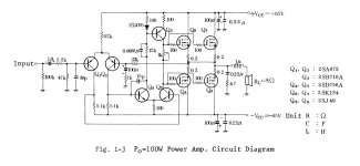

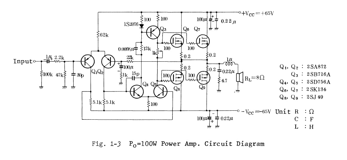

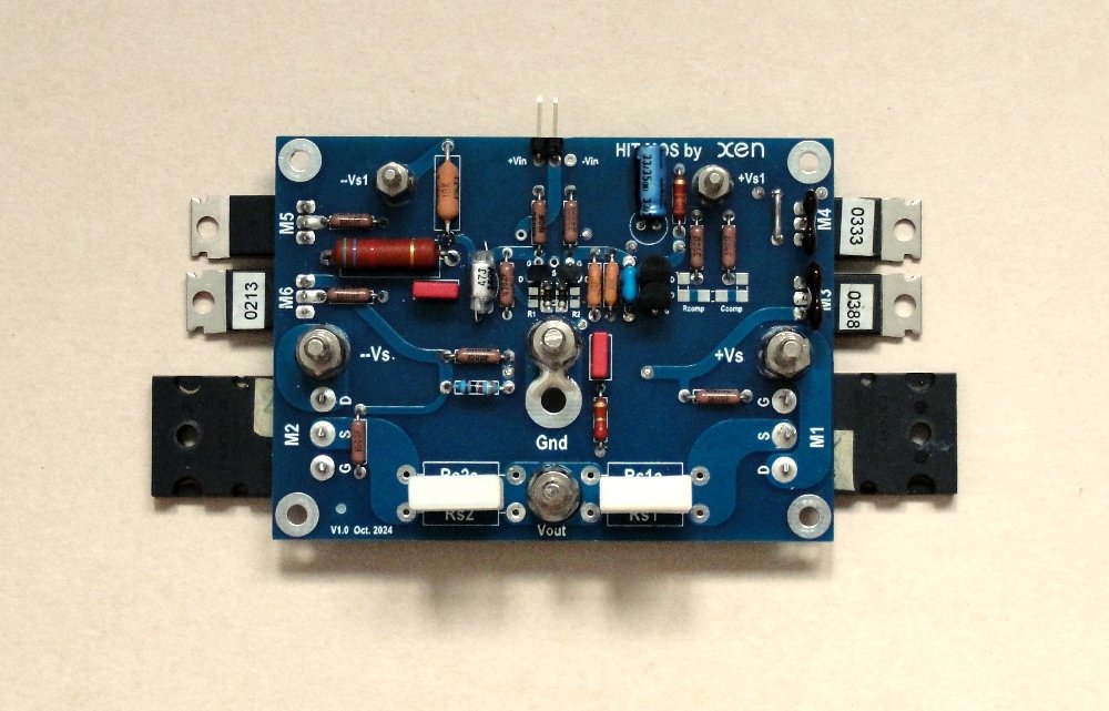

As mentioned before, we have now built the BJT front end version exactly according to data book.
We shall build the all FET version, thoroughly test both, and release details in a new thread when ready.
We shall stick to the original as much as possible, and make no attempts to "improve" the original circuits.
Patrick

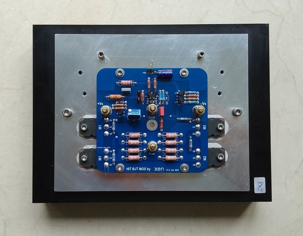

One piece of advice: in comparison to fixed resistors, those 20-turn trimmers have poor Tempco. This means that your bias level will vary according to temperature... The performance seen on the bench / when cold, will not be mirrored in the listening room. Secondly, I am not suggesting that you have used a cheap brand of pot, but I have seen (don't use 'Suntan' for anything) lesser makes of the same trimmer jump wildly in value in the field... This could potentially create a catastrophic amount of heat. My tip is to adjust bias via a dummy load, taking into account your size of heatsink, finding a sweetspot on the bench, while the amp is relatively cold. I would then replace the trimmer with a pair of fixed resistors that have been chosen for good Tempco.

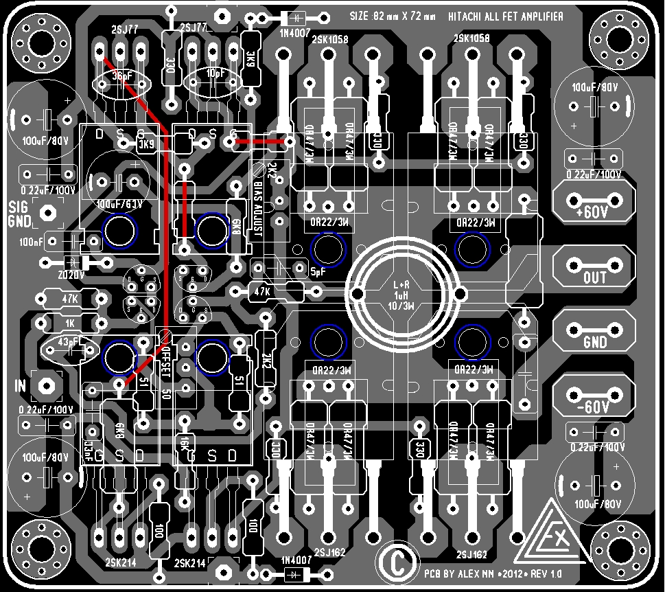

NB - your amp is identical to the one in this thread https://www.diyaudio.com/community/threads/maplin-mosfet-amplifier-ga28f-construction-thread.257488/
The all-FET one is a different beast and I look forward to reading about the results. My suspicion is that it will not outperform the Maplin-style one you've got here. If you look at Hitachi's later designs, where they changed the front end to FET, they give much the same THD spec, but are slightly noisier. The 2SA872 BJTs are extremely quiet. You will have to get up early in the morning to find quieter front end BJTs.
If you would follow my previous projects, you would know that I almost never use trimpots.
The one in the photo is only for setup.
Once it is finally installed in the final heatsink case, the trimpot will be replaced with fixed resistors, as I always do.
The PCB is designed to take both.
Patrick
