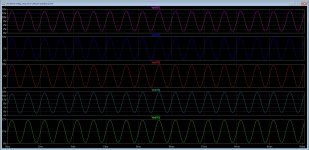

Voltage at the source contains idle current by source resistor value while the one at the output does not. So, you need averaged difference of two precisely half-wave rectified voltages which basically yields the idle current of yours times source resistance. However in class A current through MOSFET never goes to zero you may skip rectification. The complicated part is rectification at higher frequencies, which would be pricey.
Ho Alexberg
Thanks for the advises, the autobias you do mention there is a lot of documantation about, special in the tubes area.
I have try with transistors as error correction who do work also, however what do happen with the sound, I have low pass the feedback from source resistors so it have no impact, but I did hear this kind of correction does compress the sound?, it does work very stable because did test this in the past, however abonded it because of the compression warnings. I did see distortion is higher with the bjt bias tracking but not so much.
Rectification for high frequenties can be done with skottch diodes, not so expensive, but the whole stuff is quite complicated, the circlotron needs te stay floating, a little disturbance do shoot distortion skyhigh. a normal amplifier with ground is a lot easyer to make a autobias, I be aware that a autobias give much lower distortions,, but we speak about 52 mV over the source resistors, that is little voltage and it need to be measured during the zero transitions, therefore a sample and holt is used in some designs.
But it is interesting to investigate,
regards kees

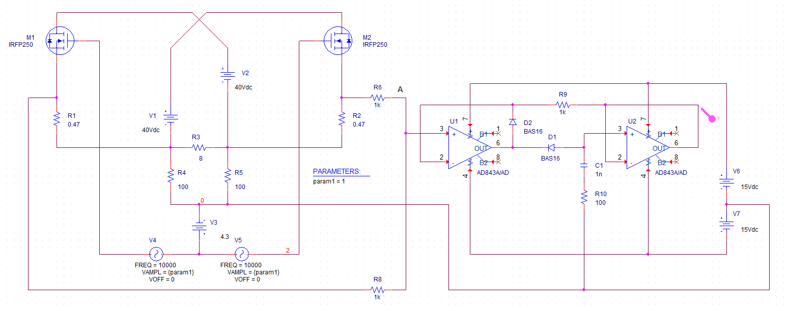

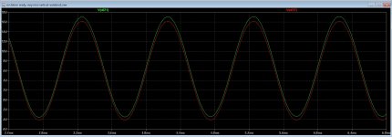

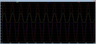

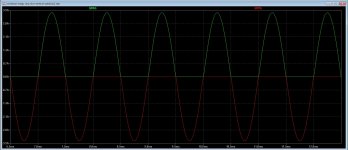

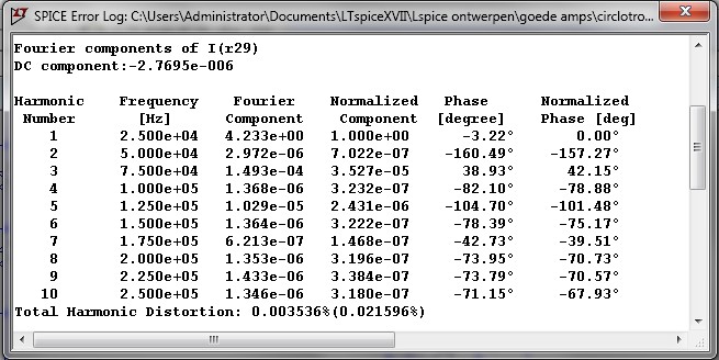

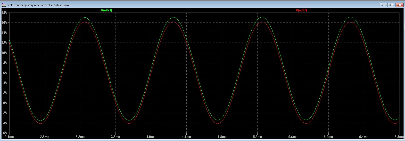

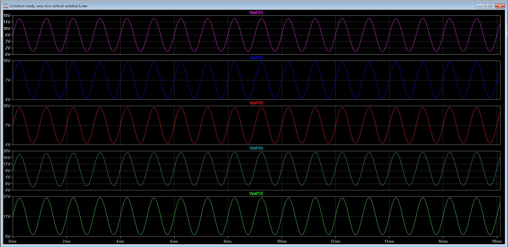

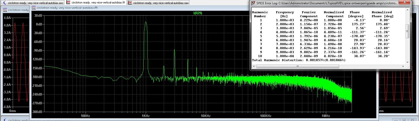

I have use now a opamp for better tracking, it even does set the offset very nice, do two things,.
I did read a lot about autotracking servos, much people have bad experiences with them in class ab, I have now try it in the circlotron, I do not now if i have done it the right way and or there is compression of music, however the servo do swing with the output stage so do see only dc voltages and because of floating amp, it does not compress I think.
It has also better distortions as with the bjt alone. but the need for a rail to rail opamp is really needed or it does not work wel.
Last pic is a 25 Khz distortion measure.
regards

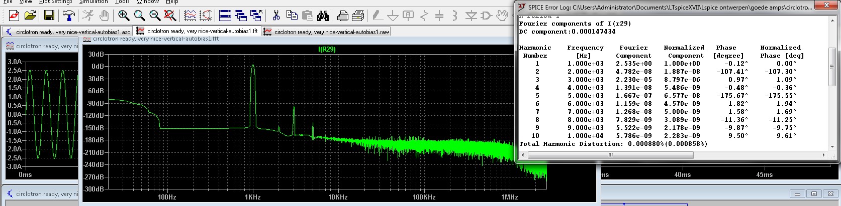

Look, there is a reason for averaging only positive half-cycle to extract bias alone. Your solution measures the sum of output and bias current which is not what needed. For instance "standard" PP EF approach with opto takes into account the fact that average value of AC output current equals to zero. Thus exactly bias and only bias is controlled.
Cheers
P.S.@Kees52, I've have no intention to steer the design of yours from the route to completion. Approach mentioned was simulated and prototyped. Unfortunately it seems too complex.
Cheers

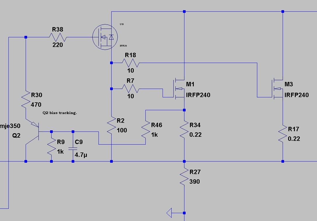

Ah you was the guy behind that complex opto coupler approach? I did read somewhere and see the schematic for that, but it was not for a cirlotron.
I have include the servo into the floating output, two separated servo,s that is, because the whole circuit is in the swing it do sees only the dc part, as that was what i did think. A circlotron are two single ended parts, driven with out of fase signals, the output is floating so the servo circuit needs also be floating the output 1Khz signals is not seen by the servo, it sees only dc.
It does work, but as I did read on much places, the idle current servo is special for class AB very difficult to implement. I think a sample and hold circuit and a little cpu can do better?. with single ended tubes, the idle control is very easy to do, it give a much better respons from tube also, better then with cathode bias.
Your help is welcome, your help is of value for me thanks.
In pic's the opamp input and output in ltspice is measured, and one pic I have measure the diodes over the source resistor, you see the dc component, that is only what the circuit sees because it is included in the floating supply of the circlotron output stage, all the signals are in fase of one half output, servo seeing only dc, same for other half, now we have a constant current output.
regards

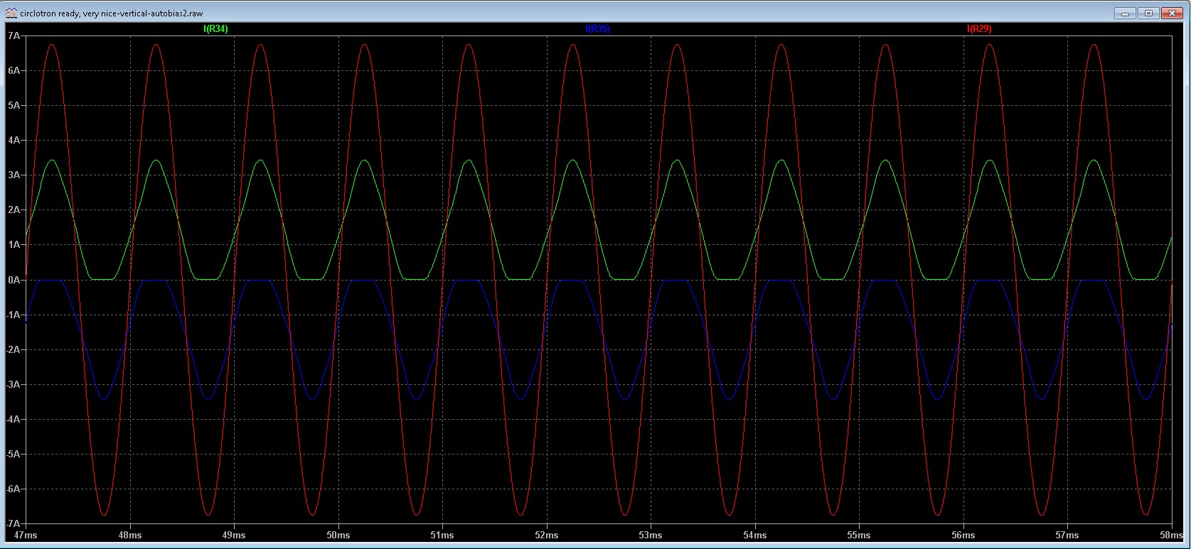

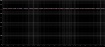

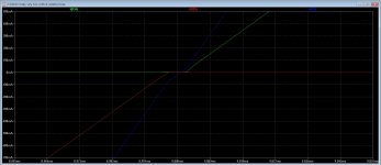

I have done some sims, but I see that I have just some millivolts to use for the servo, plus, the difficult part it has always needs to be above a minimum what the output signal will do, like max power, that is the difficulty and the complexing is about autopower.
However, I can cancel out the audio, so I have only a dc part, what I do camp with a diode and resistor, then I have 20 mV differences with 200 mA to 3 amp setup, that is little.
regards
This servo I did find on the internet as a example do work for some part, to get shure I need to build it.
The extraction of current from Rsource, where is also 7 volts dc do this not destroy measurement? the other part of the circlotron has also +7 volts. cancel offset to zero.

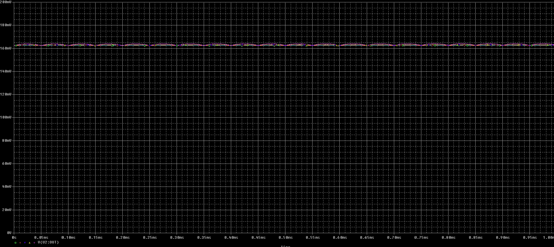

Here you can see with the servo I have done, only when I get clipping the idle current runs out of steam, I have still some 100 mA left see circle in pic.
for normal use and almost full power it seems to hold idle current stable.
regards

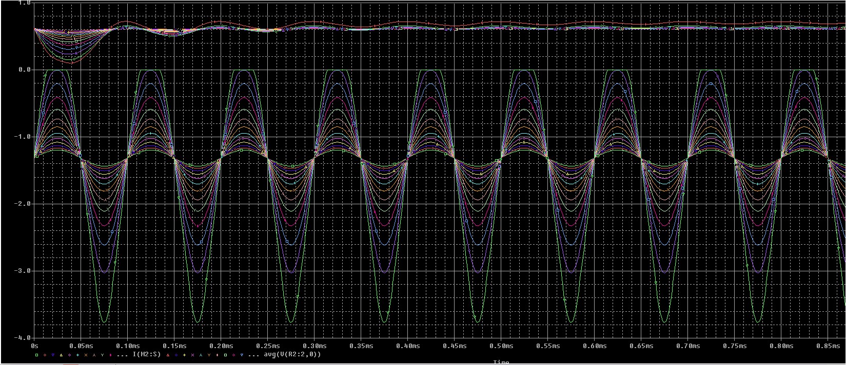

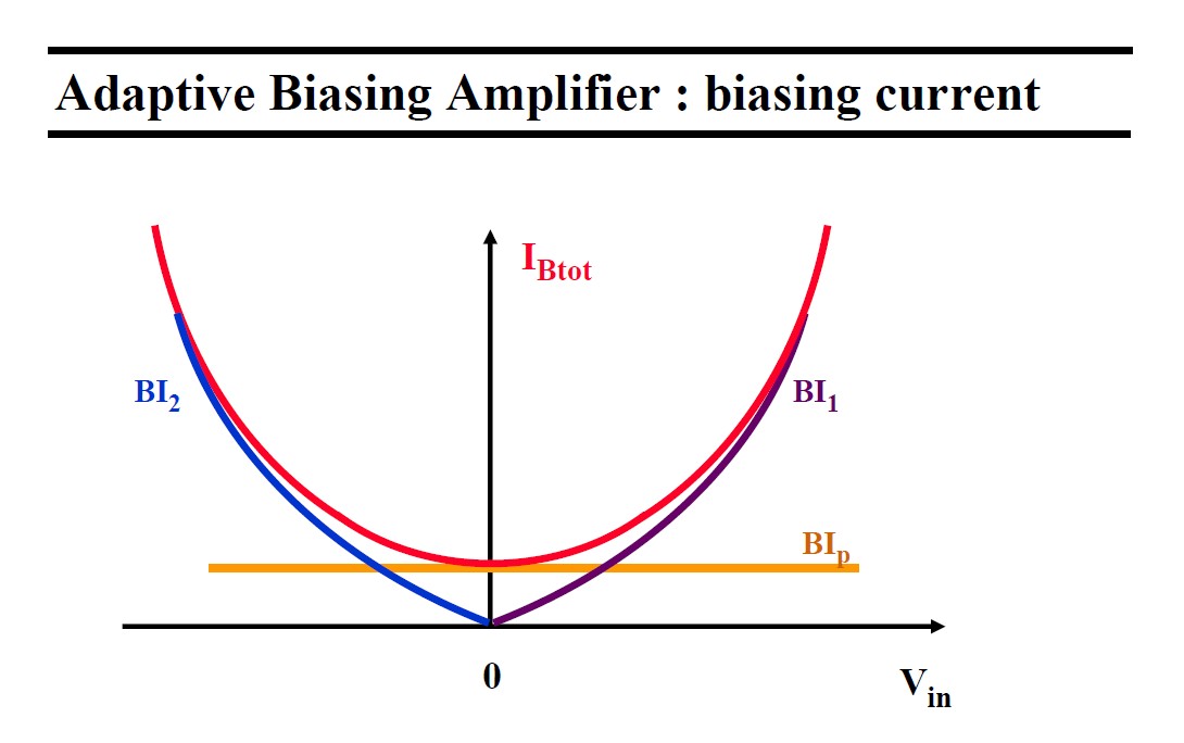

Bias

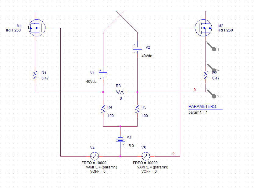

As soon as amp leaves A class, average current through fet departs from the initial value, see attach. Sorry the circuit of yours does average the current trough FET. Diodes in measuring circuit do not conduct due to absence of the reverse current through the fet.
So maybe a circlotron can not be auto biased? because of the halves and floating output?, we need reference, it has with two resistors but maybe that put trouble, that is why I did put the opamp into the halves on each side.
This is a shortcoming of me, the theory, but calculating and such, I am hobbyist so, never get on school for learning theory, I do now much but the small difficult things, I can not, and an autobias is quite difficult as I have read on much places, where she do talk about using cpu for that.
here is the schematic, just play some with it, it is better than see pictures.

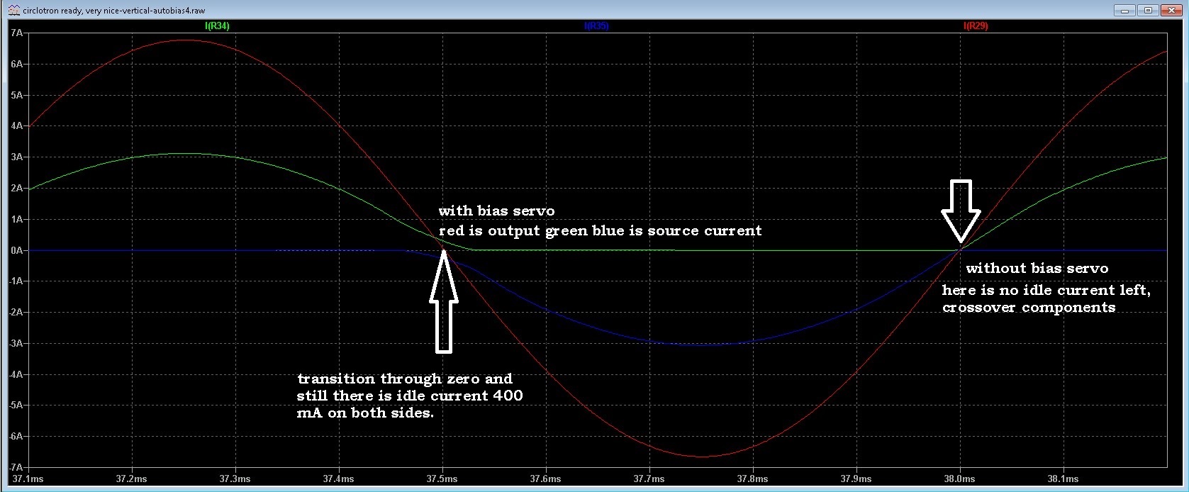

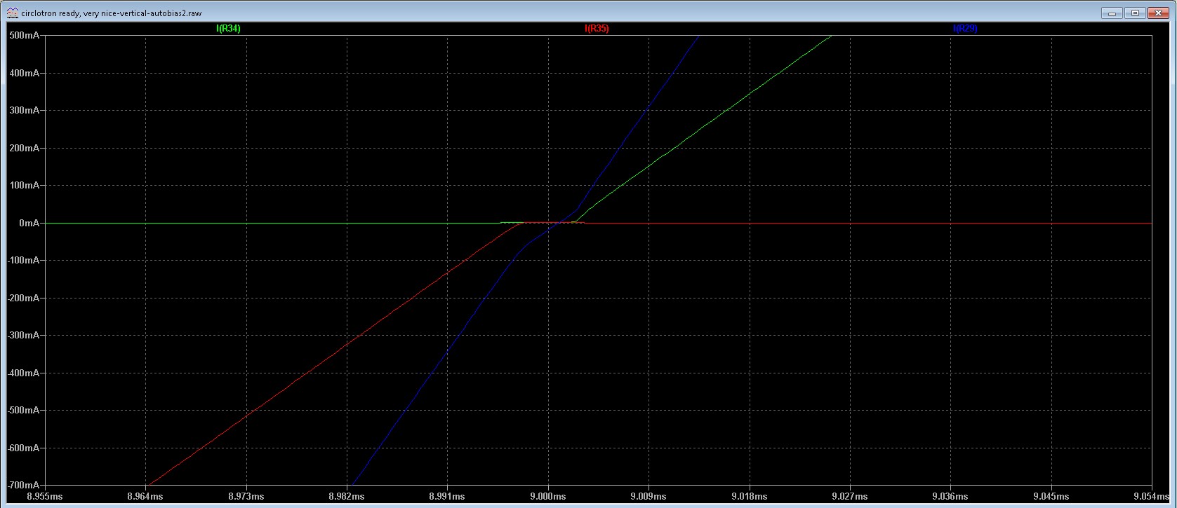

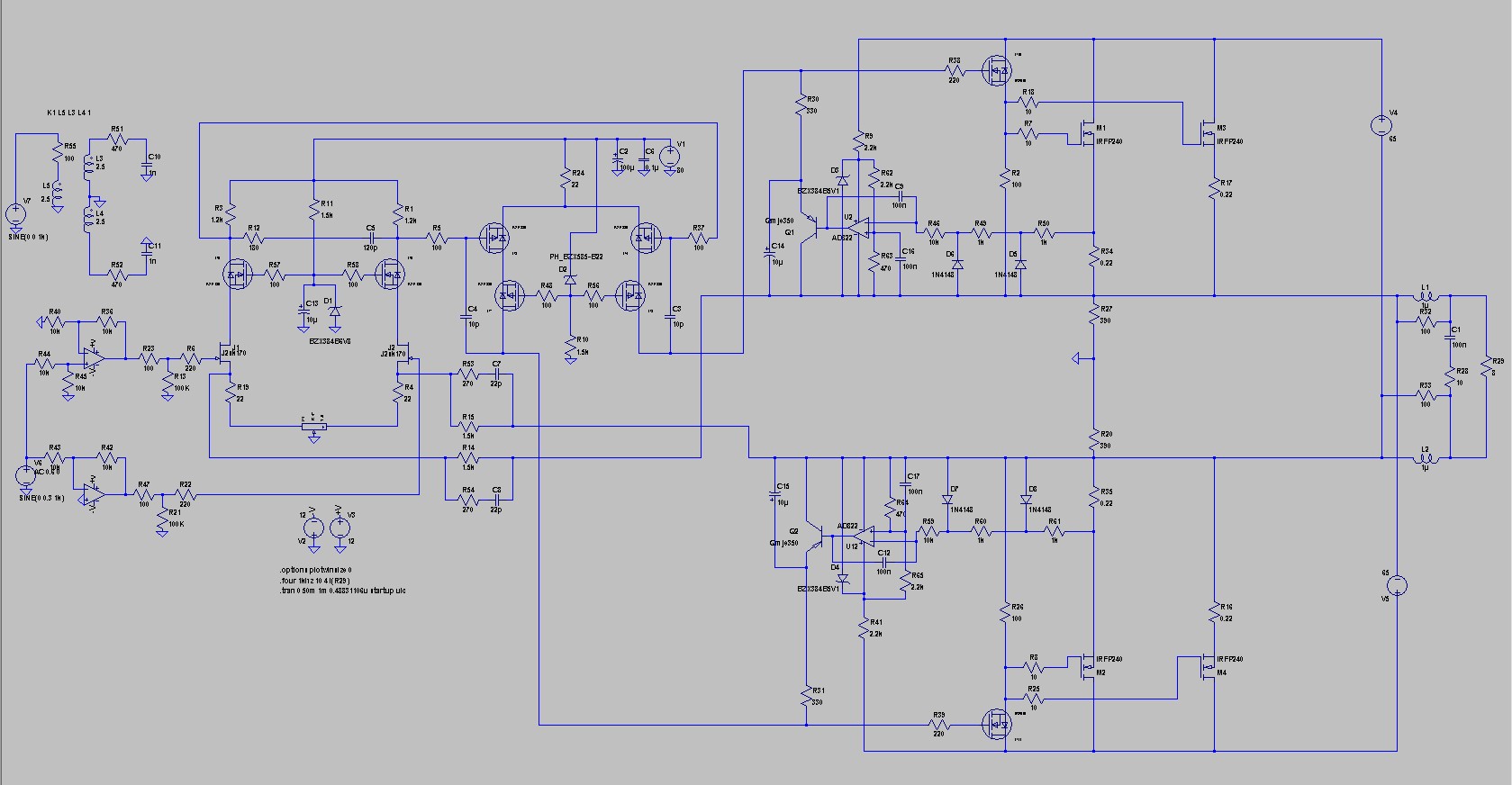

I have sim with and without the auto bias, you are right, with the autobias I get even worse plots, the diodes are just pushed to the zero line, so I can not measure this way with a circlotron?. Nice afcourse to play, it is quite exciting stuff haha.
With the autobias you see clearly the crossover see last pic. so work to do and learn, need put the autobias outside the output stage. The opamp is grounded with the negative pin and also the rectifier diodes, so it can never go below that, problem occur. with a normal EF version we can use a negative voltage on the opamp also, here it can not.
You now I read a lot about autobias as mentioned, it is quite a challence I do read also and not much amps do use it. And class D get better and better.
regards

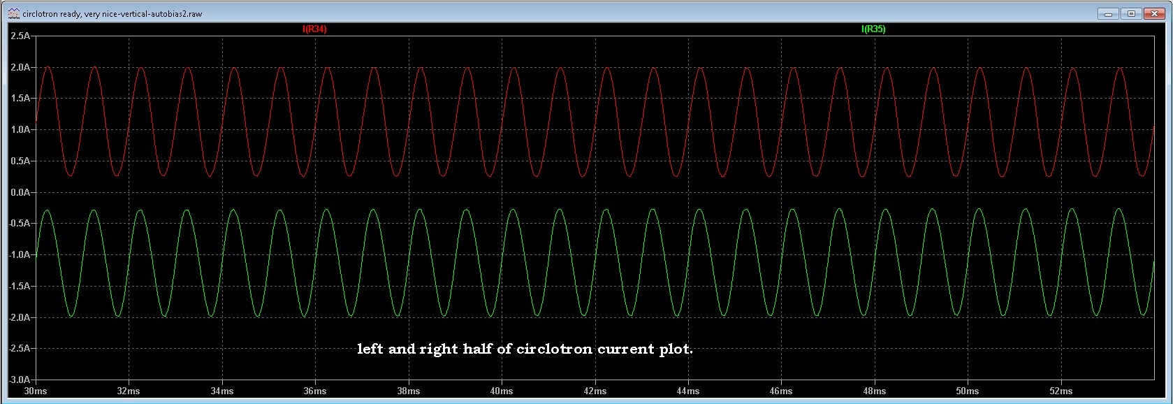

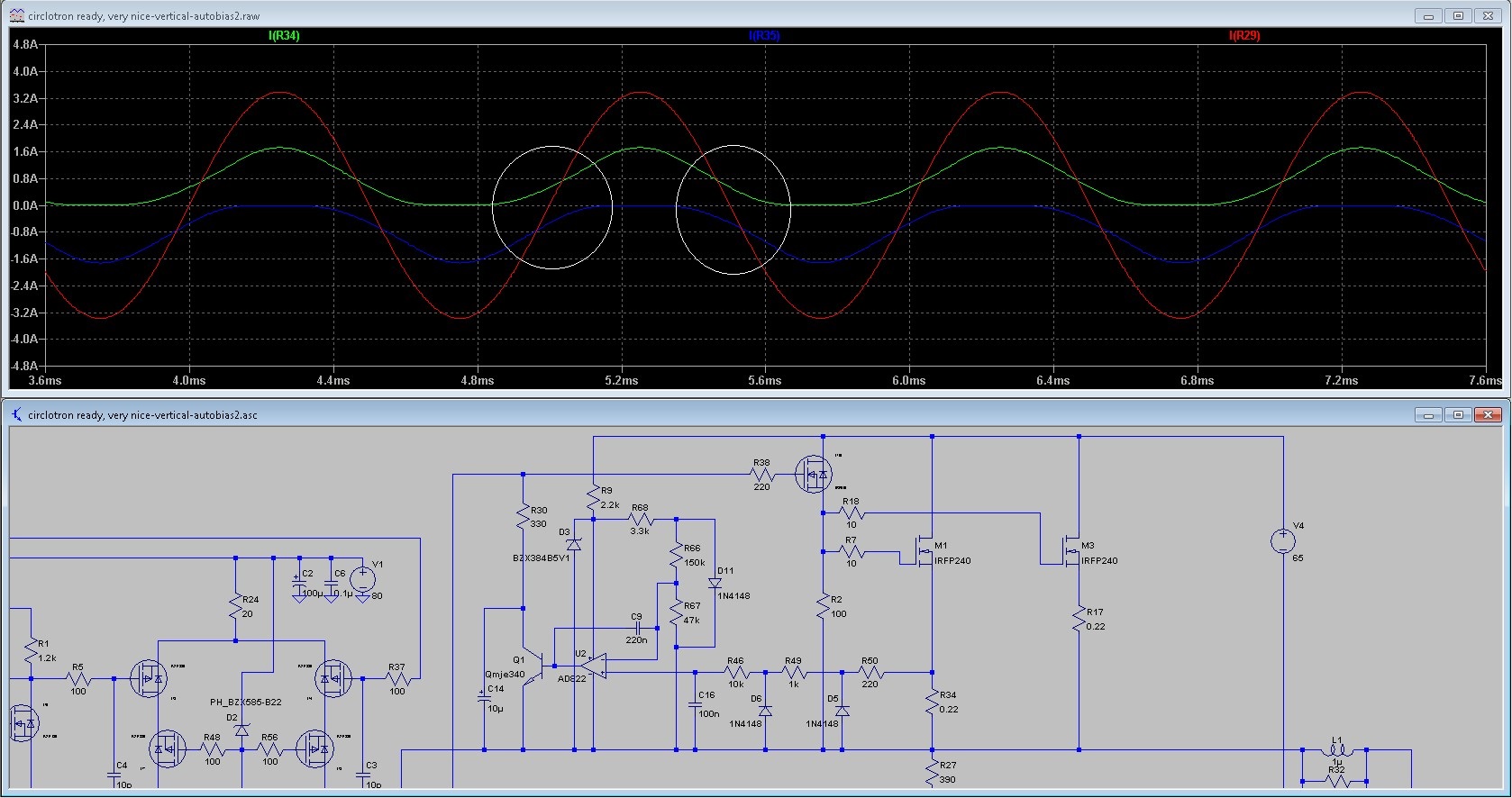

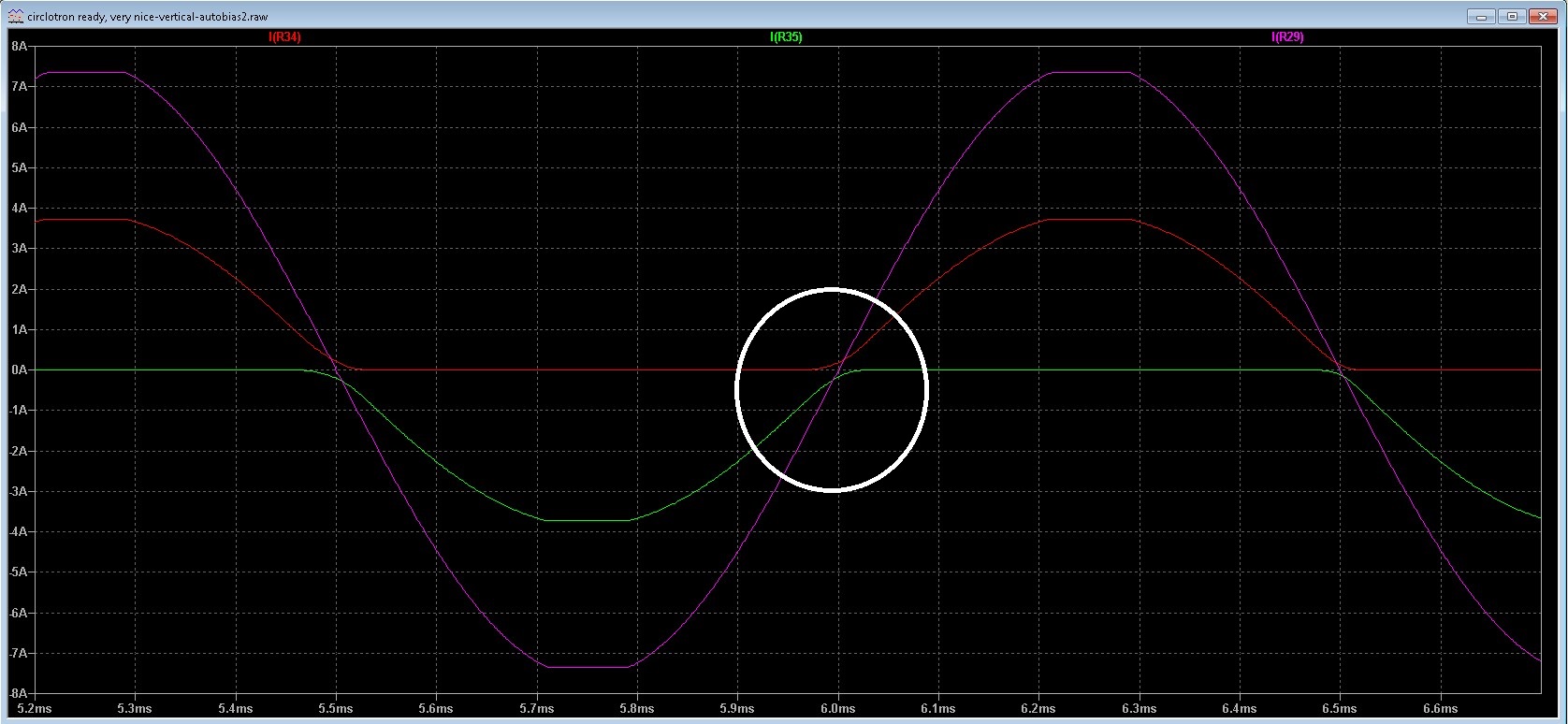

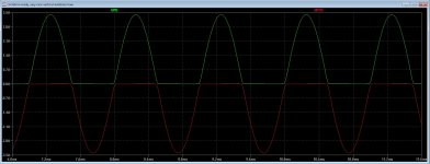

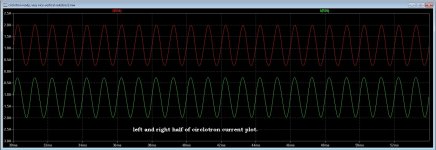

blue and green line is current over the source resistors and red is output signal, idle is 1 amps as test, the output is near clipping.

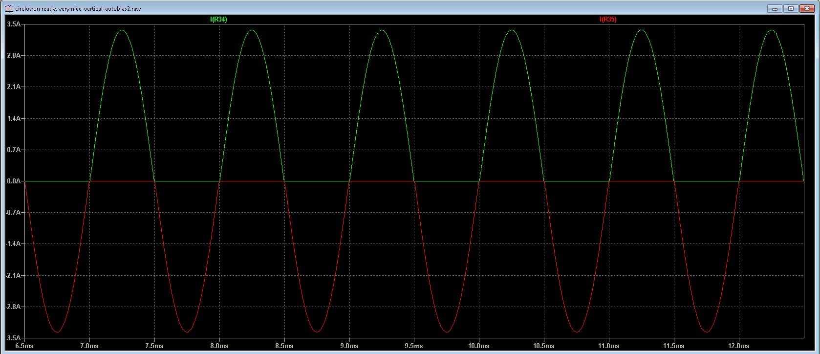

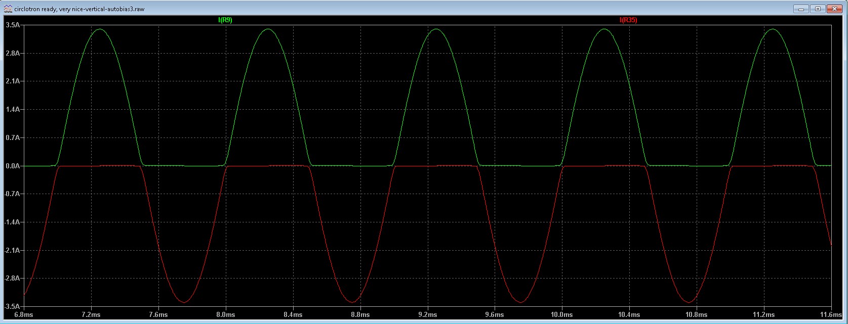

I have disable one half of the bias servo and drive amp fully, there is clearly some bias left on one half and nothing and class b on the other.
Do I drive to clip, both get in class B.
explane please, am I wrong here? diodes do conduct, have some Milliamps there. complicated stuff, therefore autobias the right way is difficult, but this do work quite nice as a normal bias tracker.
pic three is what we want, stable idle current on all output power.

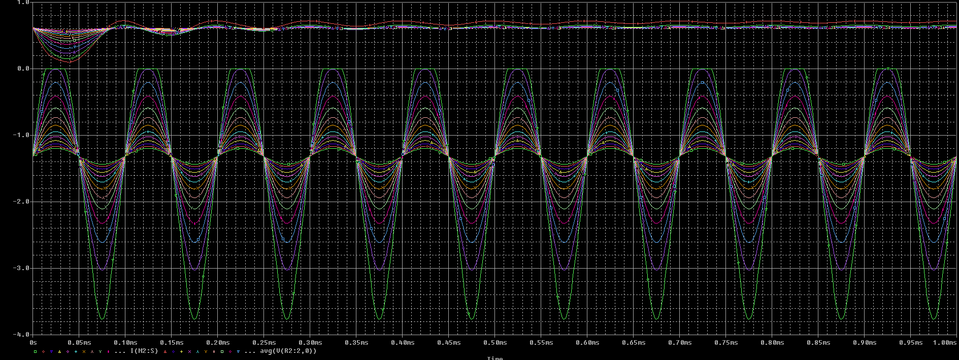

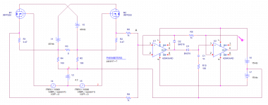

It's easier than one may think - getting old I guess.
Anyway, see attach.
Sweep is done for Vac1..16V which translates into 28 Vpk at the load. No NFB though.
