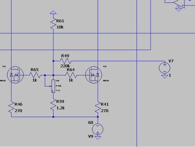

I did this, disconnected autobias section and connected this.
Now bias current through each irfp240 is 1Amp... When in class A part thd is very very low... also overall thd level dropped very much.
But 65 W per mosfet is nice heater 😀

yes you did right voltage source do replace the autobias, these is when simulating very slow, becais eof very long times as with a servo.
You do now that this idle setup with cause temperature runout?, putting the current source mosfets on heatsink do not work, it get the wrong way.
regards
But why, ? mosfets have kind of lower drain current with increase of temperature and constant gate voltage!?
Why not measuring voltage drop using op amp on source resistors of IRFP240? using that info to control the voltage and V7...
In real life how can we be sure that top part of output mosfets is identical to botttom part, so that output current is zero through 8 ohm speak. I presume DC servo serves to make it zero. This is useless in spice because all mosfets are identical, but source resistors may be changed to see if DC servo bias works.
But resistors at the output of DC servo bias seems to be too large R63 R27 R20. I think mosfet imbalance can be higher in reality... maybe lower value of those resistors should be used..

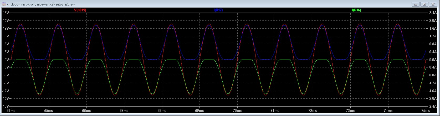

I am simulating and it seems that 6,5 V DC (at voltage source I put on schematics before) is optimal voltage for lowest THD..
0,0012% for 0,5Vin ( 27.5 V out peak)
0,0037% for 1 Vin (55V out, near clipping)
0,0025% for 0,25Vin (13 Vp out)
0,0013% for 0,1Vin (5,2 Vp out)
0,00038% for 0,05Vin ( 2,6 Vp out)
VERY good results !!!
The resistors on the servo output can not so low, for dissipation concerns however when use the amp for home and not big disco then it can be lowered to 100 ohms and 47 ohms. The servo left keeps the amp stable in the4 null volts on output for proper working of the autobias, but I did still have to test the other one who has only a servo who do both voltage and bias, see if that works, reason, the rectifier have not much work, the audio signals are already canceled out the servo did take care of the last stuff.

All in all circotron works very nice in spice. What owuld making real model reveal ?
I suggest to remove all opamps, and maybe even use generic mosfets, to make simulation faster... Then we simulate different mosfet characteristics (so that DC servo has really to work to get zero V).. Up to know did you managed to create this amplifier in real life?

simulating is difficult, the autobias has a very long rc time it do impact distortion when put that to low, just try using a 100 n cap and not 1 uf.
the integrator of the autobias does need 4.7 uF or even higher, the dc servo needs to be sligtly faster to get it lock properly.
