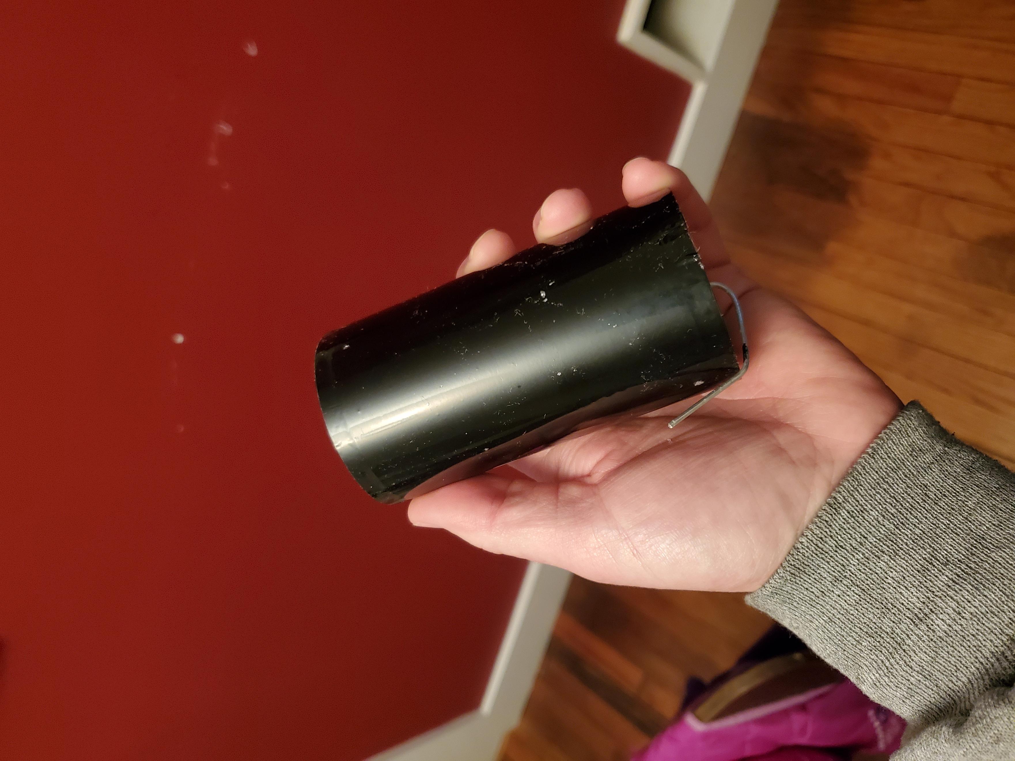

They get some, but not a lot of direct sun. Season and window shade position dependent. Maybe an hour a few days a week for one of them. Pretty much none for the other, and yet they have faded at a similar rate.
Weird.
Still sound good, and I kinda like the look, too.
Hopefully it won't lead to structural issues.
Dave: were yours black from the factory? I figured the color was part of your treatment.
Weird.
Ah. Makes more sense to me now.

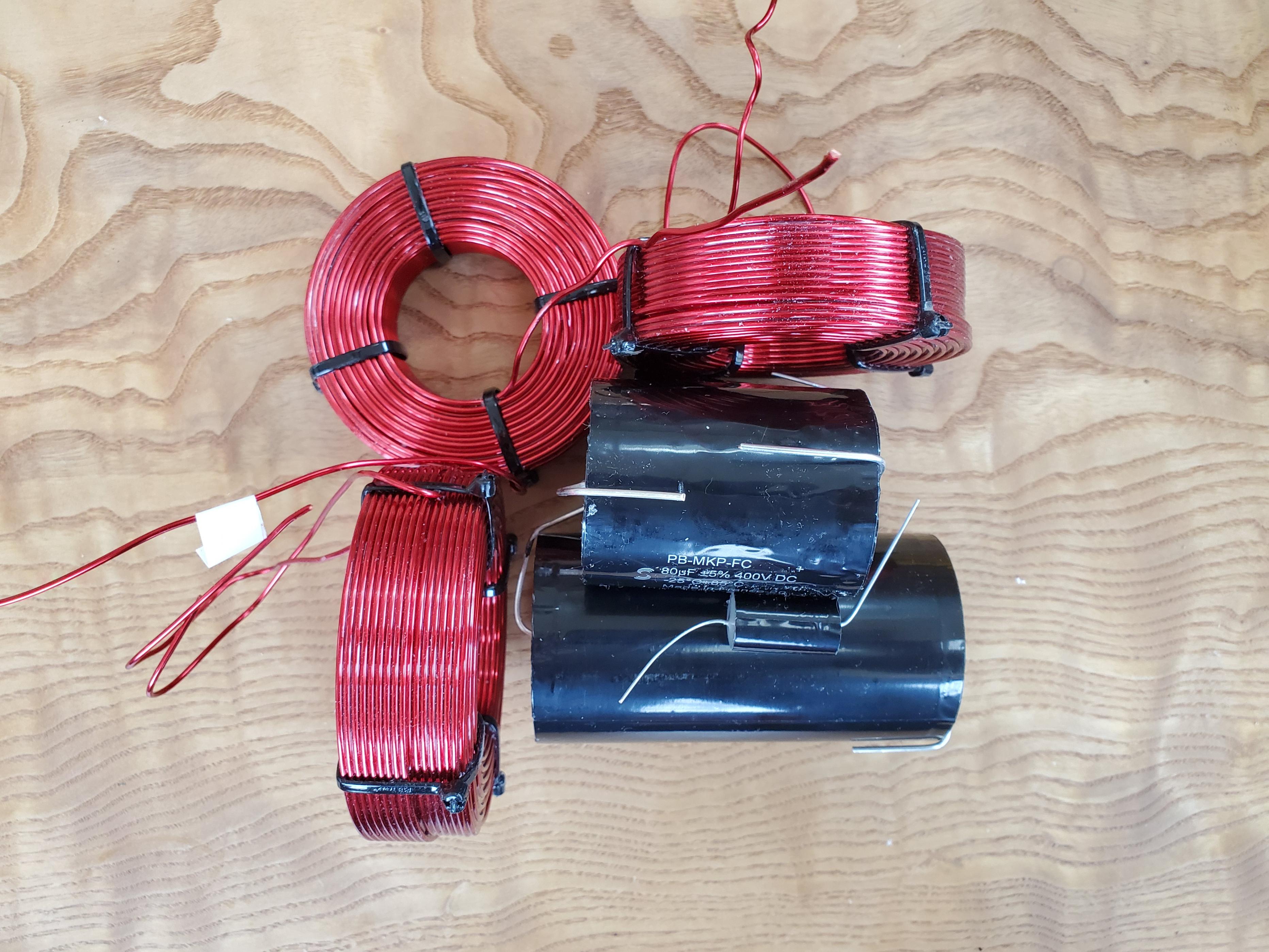

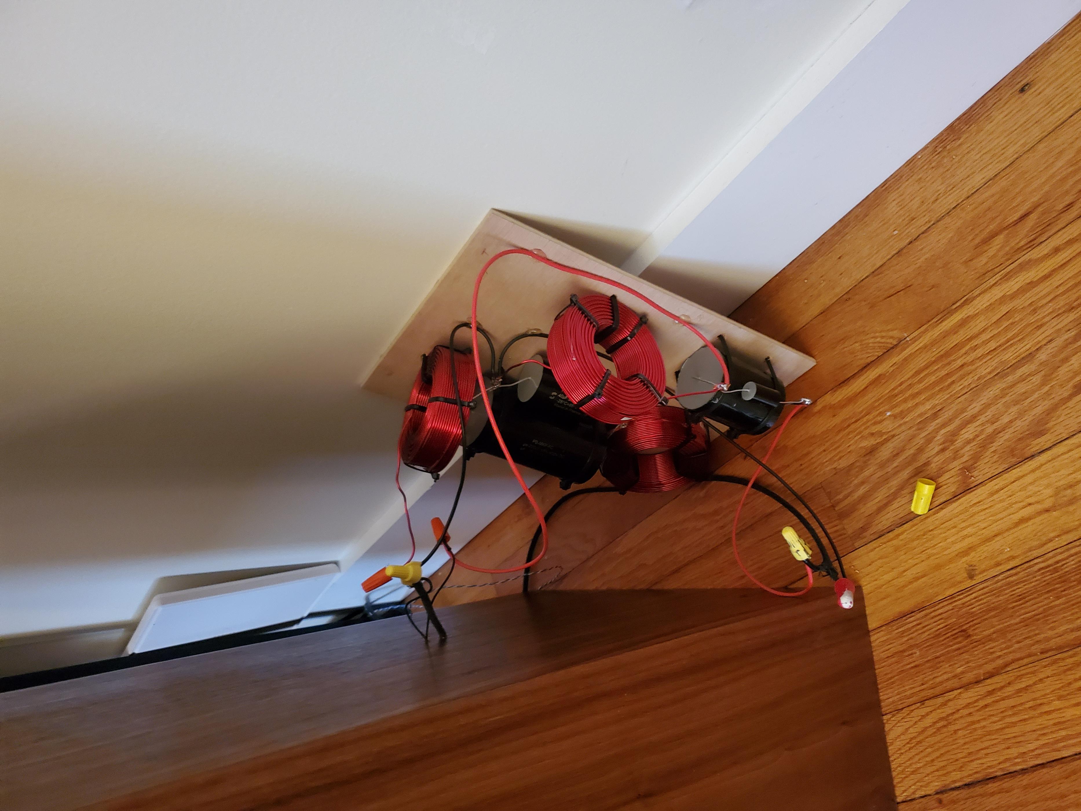

In other news: my crossover parts arrived! I hope to build them this weekend. Is the layout in your picture what I should shoot for, even if I squeeze it into a smaller footprint? The capacitors are HUGE and I want to fit the circuits into as small a space as I can within reason.

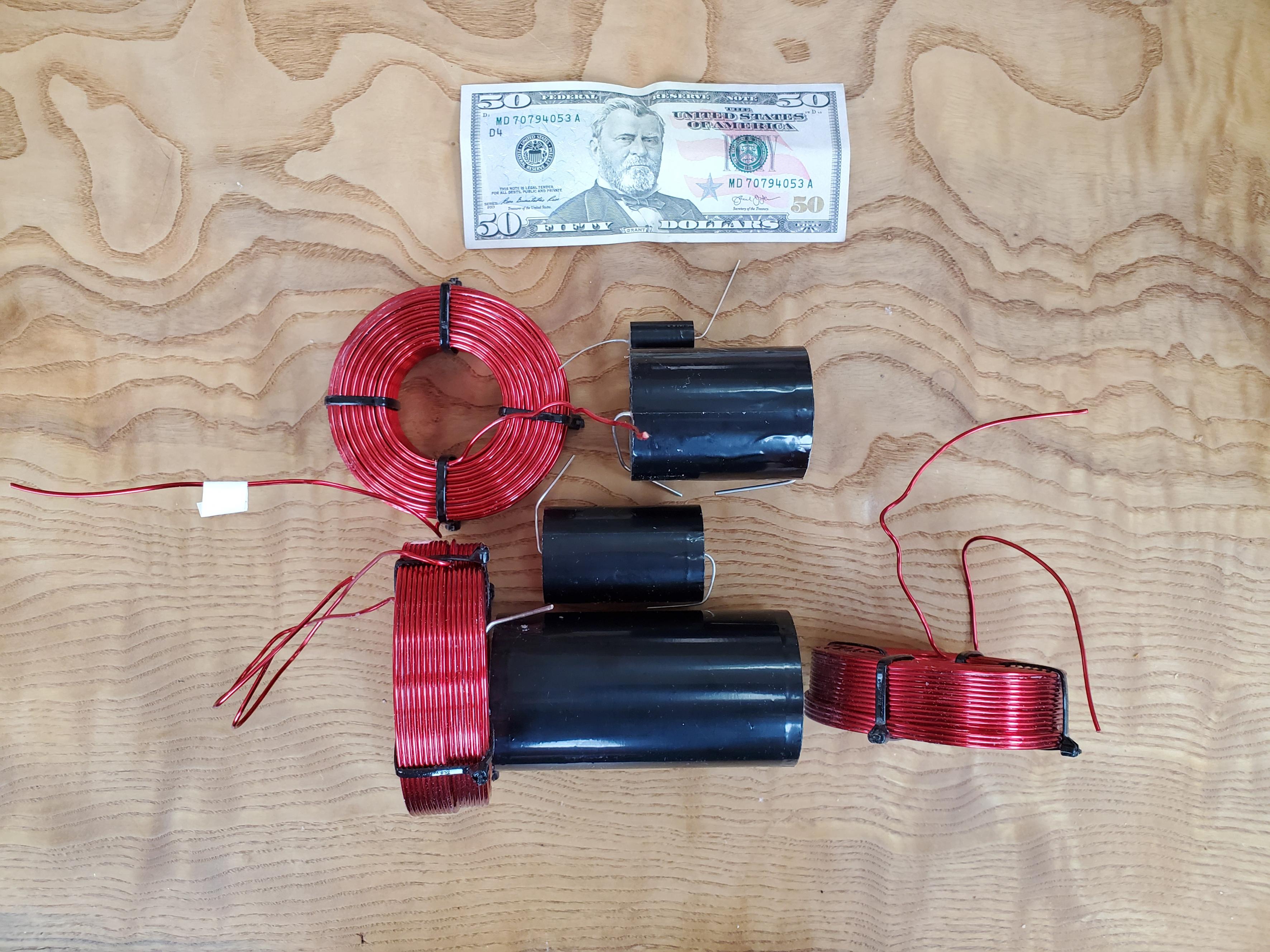

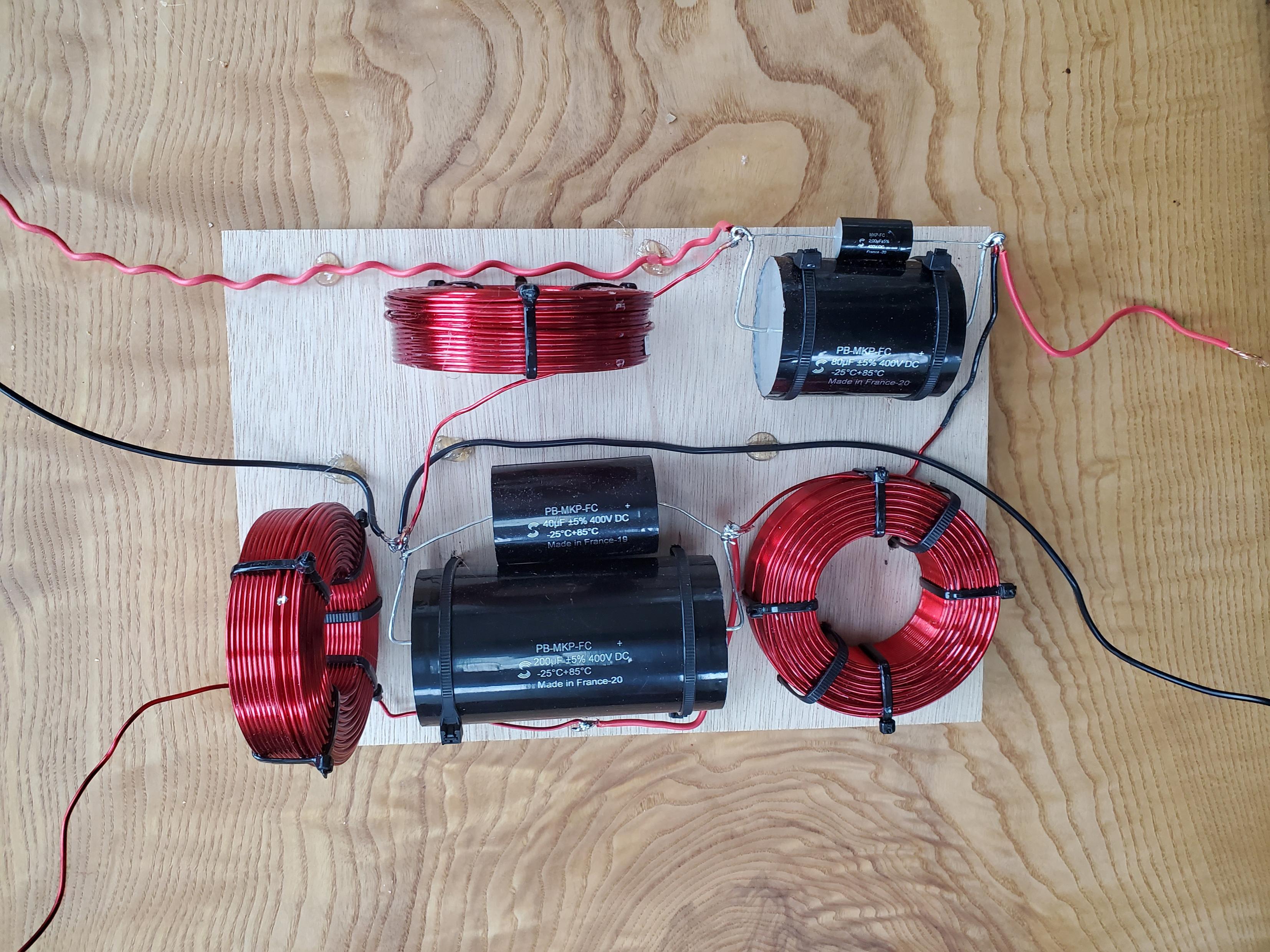

Following your advice and general layout, along with the inductor rules I've seen on Troels site and elsewhere, I plan to go with something like this.
I hope to fit this in an as-yet unconstructed box that I'll affix to the back of the speaker. I dont have much floor space to spare, and these parts are huge! $50 bill is for scale (both physical and financial).
I usually try to follow this as a guide. There is a summary image at the bottom of the page.
Placement of coils in crossover networks

I built my (huge) crossovers this weekend. After a few false starts due to my ignorance (turns out the red coating on inductor wire is an insulator. Who knew?! ) they are hooked up and playing.

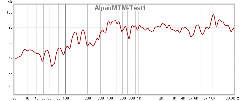

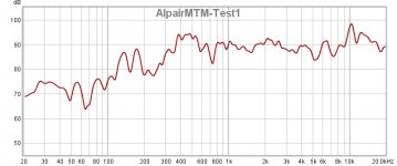

OK. Test 1 results are attached. Amplifier is Bottlehead Stereomour 2a3 SET, pushing a blistering 3.5 watts of raging fury.
Low end is attenuated. Is the solution to remove dampening?
Some ripples up high. If I understand the concept of an aperiodic TL, I think it means I need to add dampening.
A lot of the ripples are likely room effects, as the mic is sitting on top of my couch.
If someone could please confirm I sure would appreciate it. Kinda out of my depth here, but trying to learn.

Bas sis clearly some 10dB down. Ripple between 100 & 200 is likely the room, too close together to be the TL.
This ML-TL is not aperiodic, only the midTL.
The polyfluff needs to be extremely well teased. Pull it all put, put a movie on, give th wwife half ands see how big a pile you can make. Then put half back in, it can be concentrated in the top ywo-thirds if you would like to try that.
dave
Thanks, Dave.
Understood about the midTL being aperiodic and ML-TL not. That is why I thought to fix some of the rippling up high by increasing the dampening of the midTL only. Figured maybe it wasn't absorbing all of the back energy.
I'll focus on the ML-TL and get busy with the teasing for now. Once I get the bass dialed in I'll work on the midTL.
