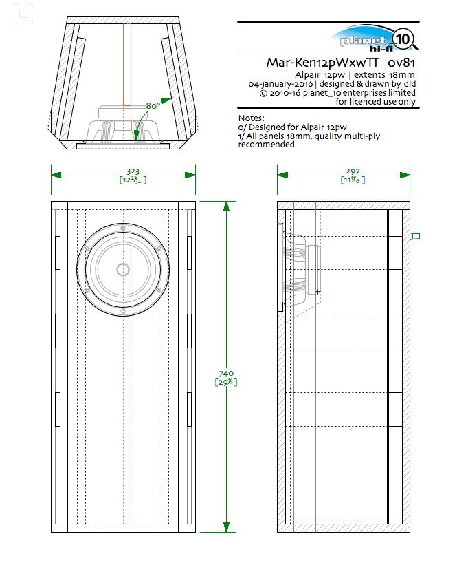

Dimensions: 732 x 190 x 210mm
If we assime 18mm material and no braces we have: 18.5 litre ML-TL just under 0.7 meters long with a 268 cm2 cross-section.
The box is small for the A12pw, but Scott may be able to come up with a terminus size for the box.
Sealed, it is almost a perfect volume for max flat response, F3 70, F10 40.
dave

About 31.5 litre. Bigger by a factor of about 2. Much closer to the ideal volume.550 x 275 x 280
1st estimate, shorten the vent to 77mm.
dave

The base folded ML-TL is a freebie: http://wodendesign.com/downloads/A12pw-folded-MLTL-291015.pdf
For any paid plansets you can mail eithr Scott or myself.

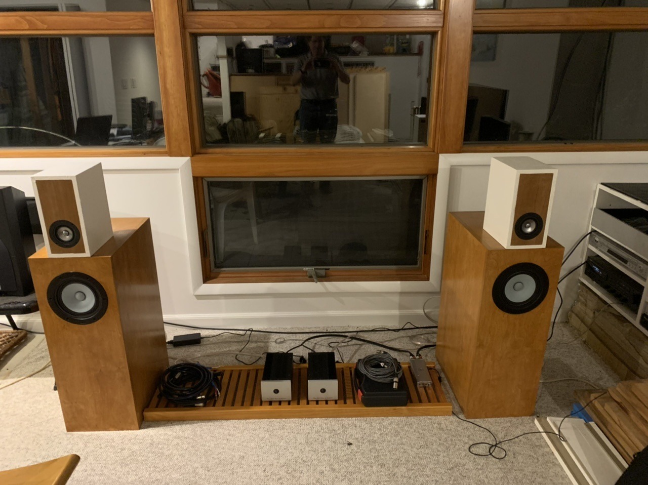

Chiming in to express my continued satisfaction with the 7.3/12pw ML-TL MTMs. Driven by a 60watt LFD integrated amp, they are extraordinary.
The Mar-Kens were very good, perhaps having a slight edge in imaging, but the big MTMs are so rich and effortless in the lower mids and bass that I consider it a good tradeoff. I considered stacking another Mar-Ken for the second 12pw, and they may have been the best of all worlds, but they are too tall for my small room. The MTMs are 4' tall, which is plenty.
Happy to answer any additional questions you might have.
