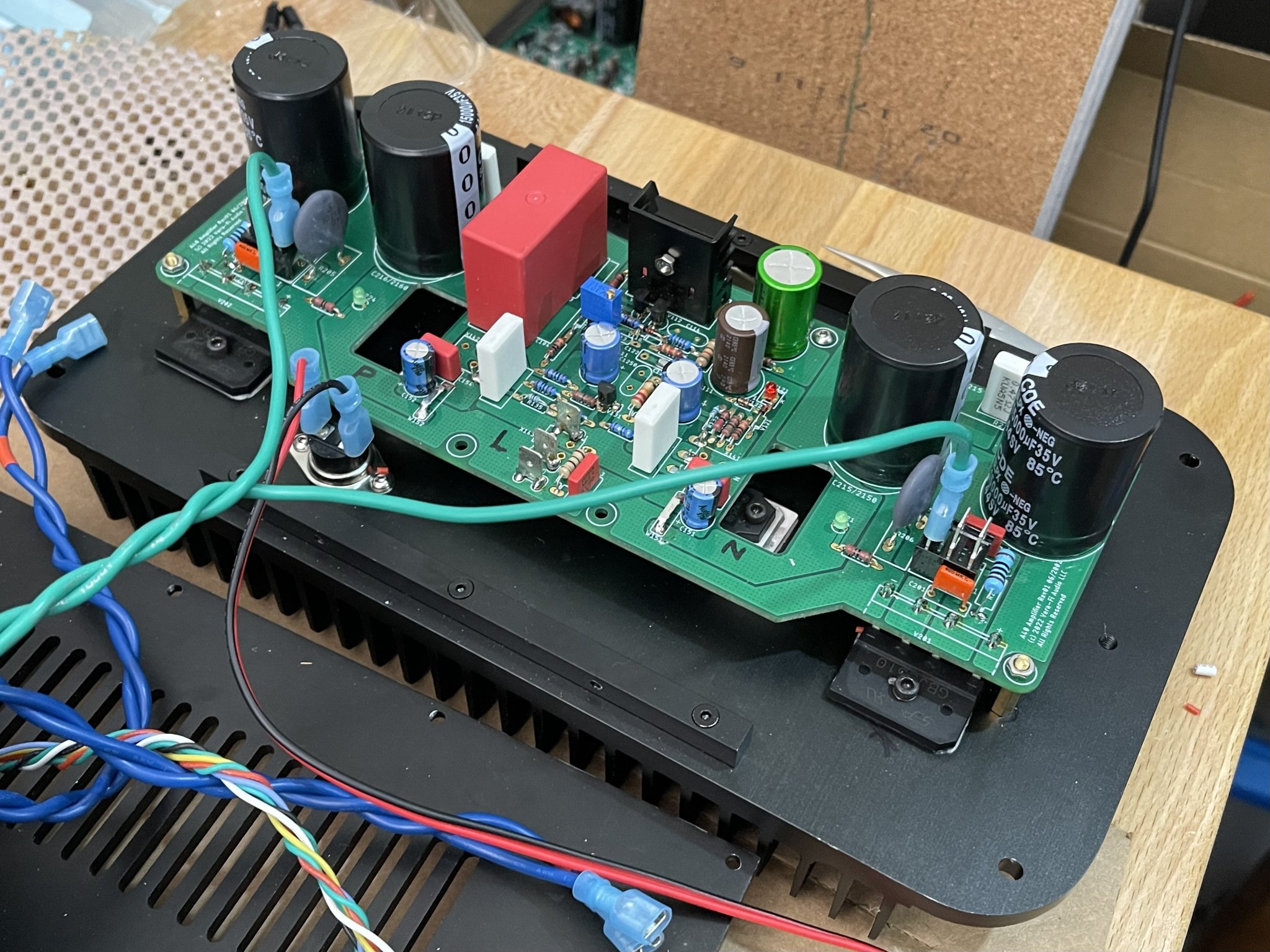

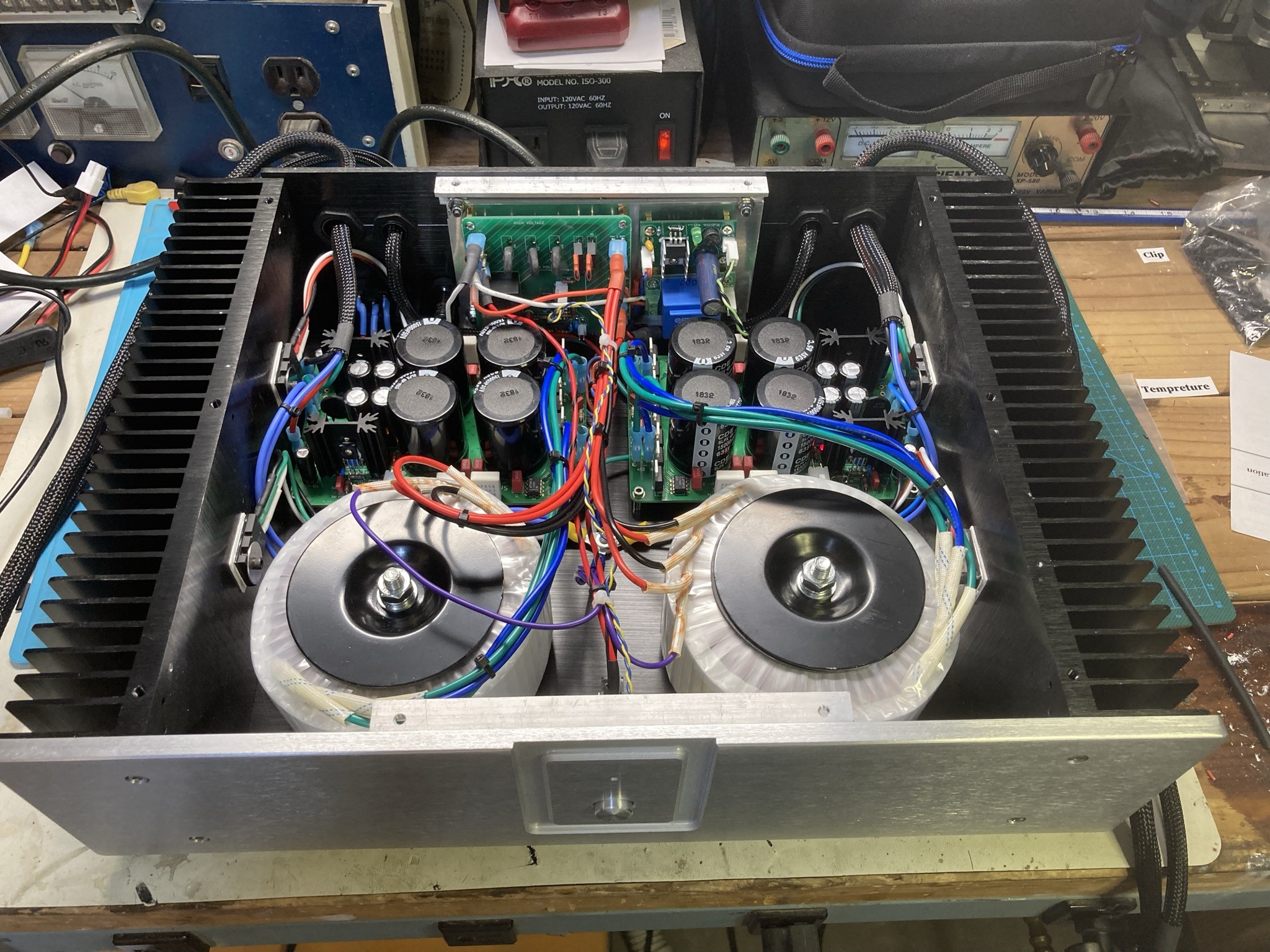

It is quite interesting the way X has placed the pos side of the power supply on one side of the amp and the neg on the other. I would have been concerned about hum from the ac but he seems to have it under control. Nice looking amp, I consider myself lucky to have an amp that performs as well as his.
Bill

Splitting +ve and -ve PSU rails like this is common. What causes hum are grounding topology and current loops. You want to avoid making a large physical loop that encircles a trafo - it basically will integrate and collect the mains magnetic field EMI.
Think of it as you never want to “lasso” a trafo with a wire. Run two lines with twisted pair next to each other if you have to but don’t split them and lasso the trafo with them. The green wire here is the chassis protective ground.
