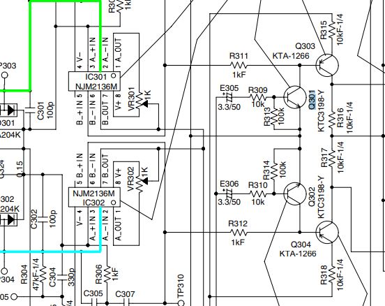

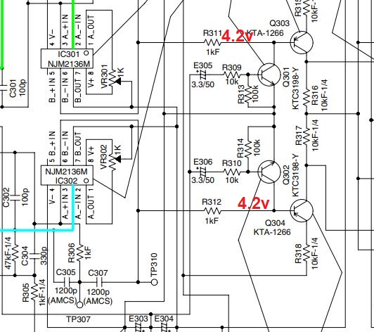

There is +4.2v at the collectors of Q301/Q302 instead of the -1.5v in the service manual.
IC301/IC302 have +4.2v at pin 6 -IN, instead of 1.5v in the service manual. OP amps supply voltages are correct.

The error in voltages is likely due to the fact that the feedback signal is not what it would be if the amp was working properly.
What's the DC voltage on all terminals of Q303?
1 - +4.8v
2 - minus 45v
3 - + 4.2v

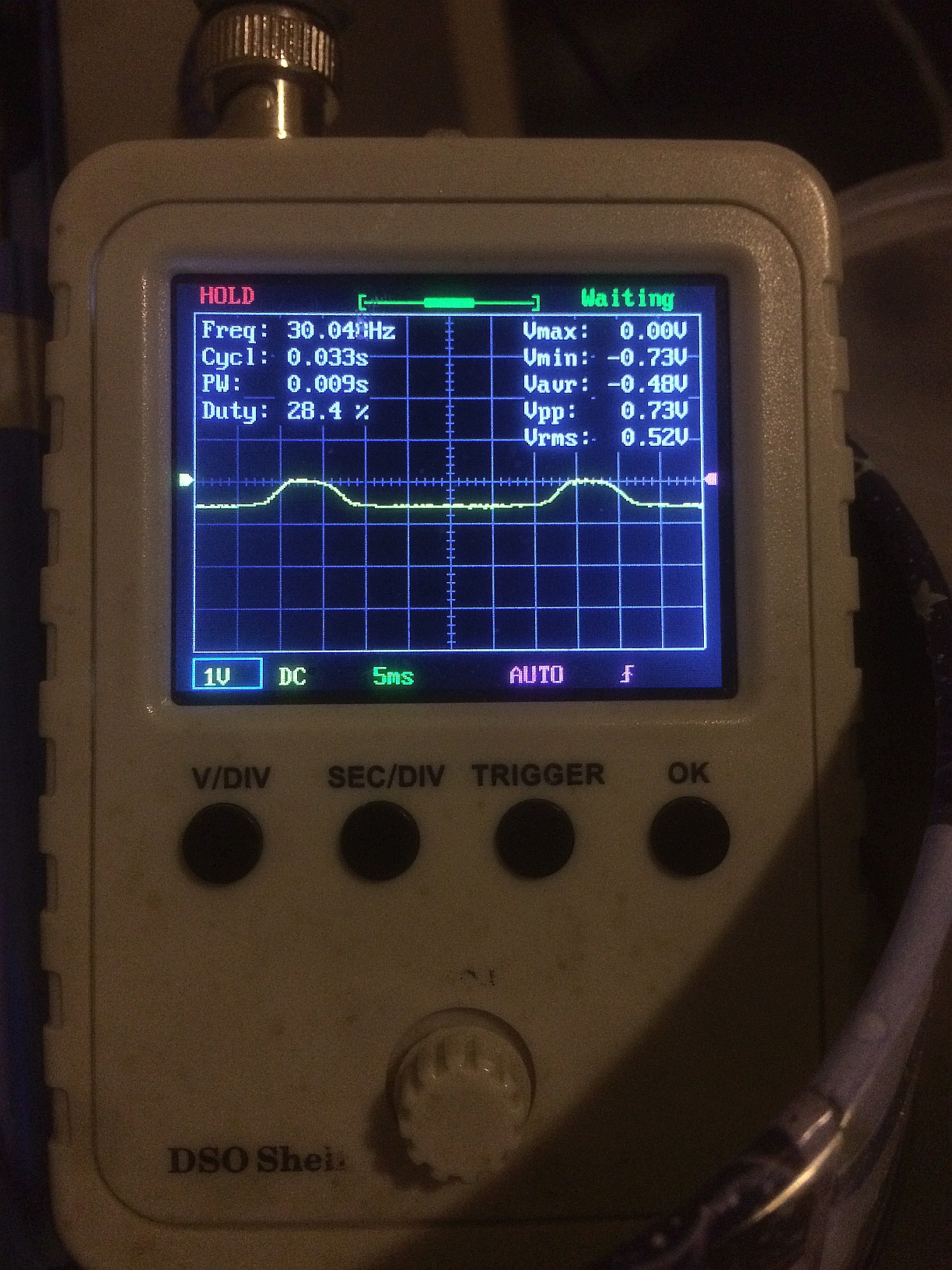

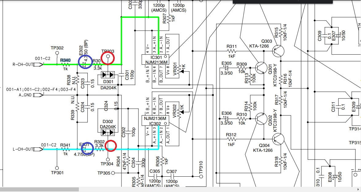

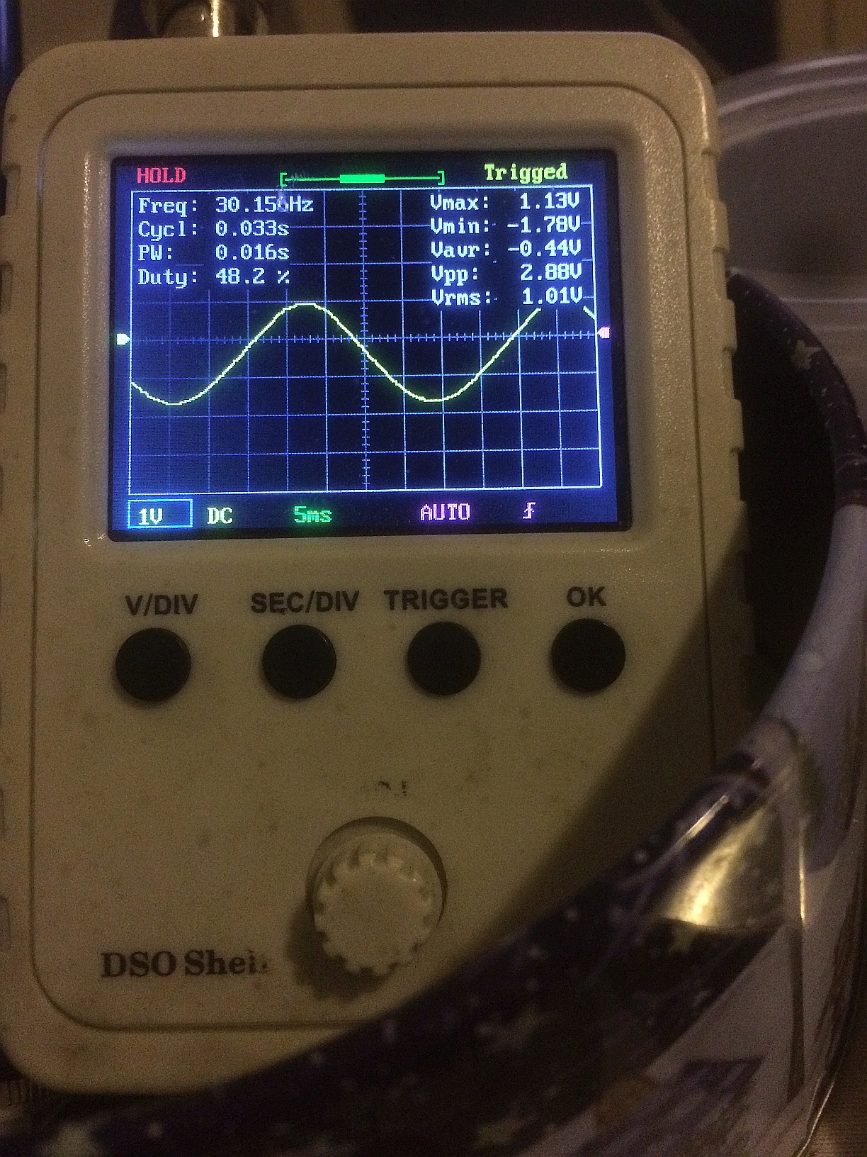

It's not the PRE-AMP section. I've traced the injected sinewave to here.
Blue circle is where it's still nice clean sinewave.
Red one is where it's only half of it and it's "below" ground. Like something is dragging it down.

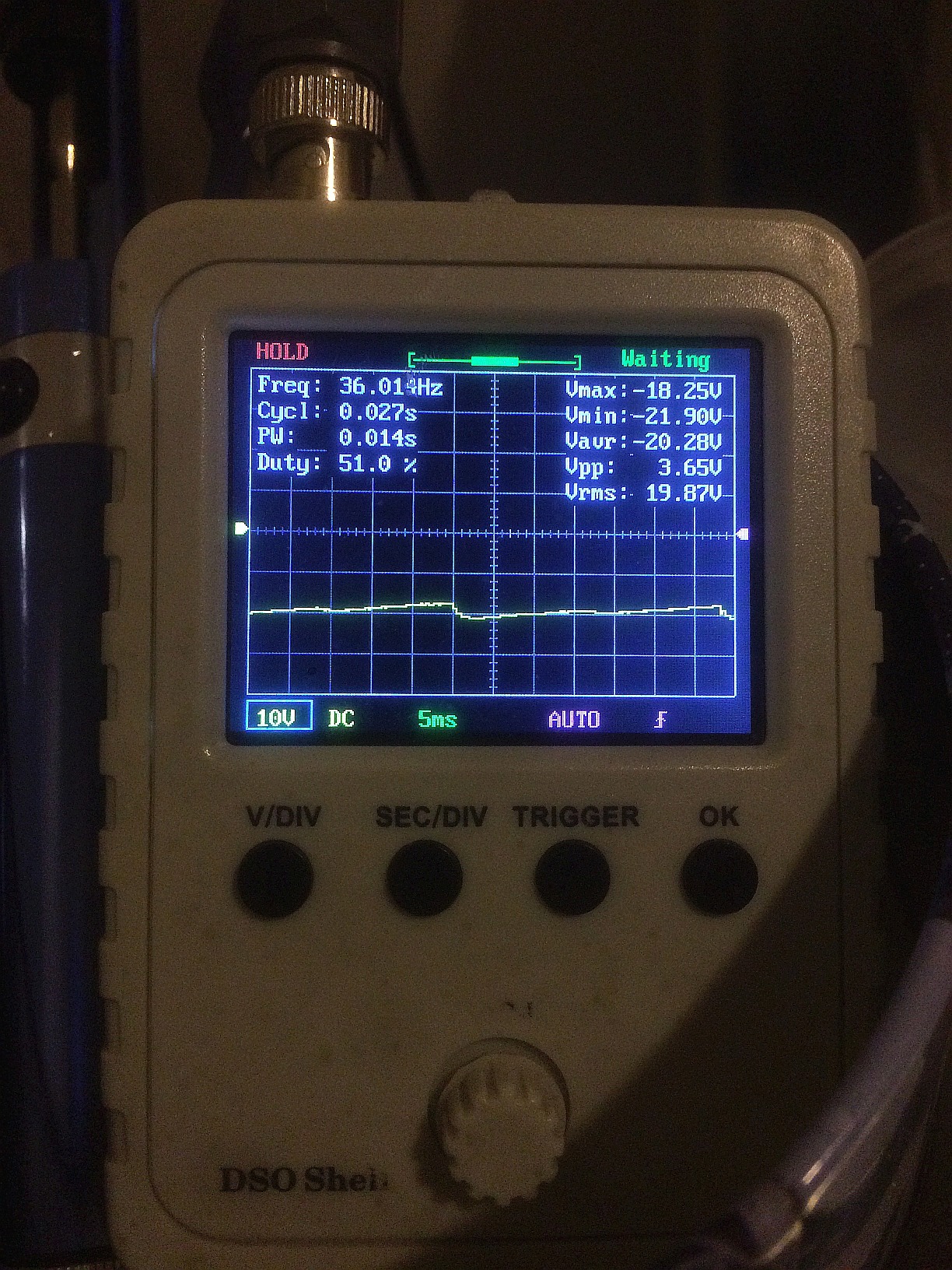

Last picture is what I have at the output terminals. Something like a sawtooth wave below ground point --> this being an full bridge amplifier i was expecting a half rail voltage at each termial... ?!

This is exactly what i did. I've put 30hz sinewave into the RCA. Maybe the word "injected" is not the right one.
If you connect a jumper from each speaker terminal to ground (preferably through something like an incandescent bulb, 2 bulbs), does your signal get through the op-amps?
