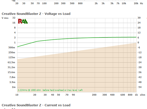

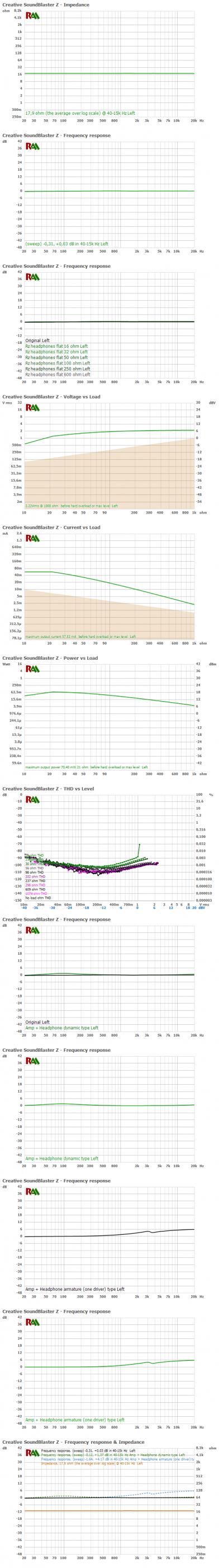

I have found this I hope it is useful, the screenshot its fot the soundblaster sound voltage out put.
Alpine UTE 92bt specs:
- Power Requirement: 14.4 V.DC (11-16V allowable)
- Pre Output Voltage (Before Clipping): 2V / 10k ohms
- Aux In: 1.4V / 10k ohms
