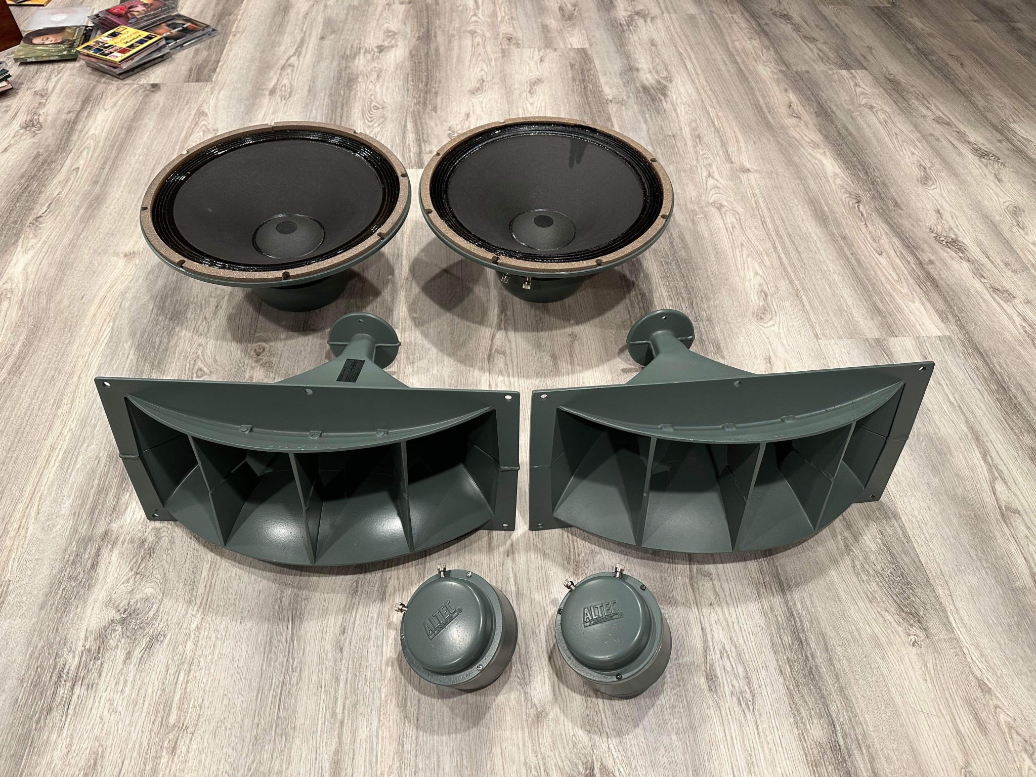

I’m the new proud owner of a nice NOS set of 806-8A, 811B horns, and 416-8A Altec’s. So now I need the Brain Trusts help in deciding on what cabinet to build for them.
I’d like to keep these in the 4-6cuft range and also would like to run the horns free air exposed sitting on top. So what would you guys do? Iconic style or Valencia with the horn on top?
As far as crossovers should I just grab a pair of the GPA N1200-8c and call it a day or is something else needed.
Amp power isn’t a problem from my Yamaha AS2200. I’ll also use digital room correction to extend and smooth out the frequency response.
Should I plan on adding super tweeters?
Basically if these showed up at your door what would you do?
Thanks.

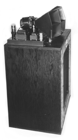

I personally have a thing for the early Black Utility cabinets / Iconic
Where the plywood edges show on the front.
And really dont care for extremely large overpriced
crossover components. That are popular for
other " HiFi" builds
But In this case would actually use excessively large coils and
have crossover visible on top , outside the cabinet , with largest
ugliest components possible. Including as many motor start
caps as possible.
Likely paint the caps with krinkle finish and make fake magical
hifi labels for them with 1940's style text/borders
Likely add extra bracing inside the cabinet.
And use round ports on the baffle. Not square cutout.
All good, it hides behind the grill. Just more modern
bracing and ports on inside. Outside just plain old
painted plywood like original. Grain showing and all

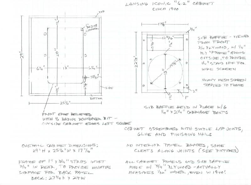

A number of ways to answer this starting with 'Iconic' is the original Valencia complete with an Iconic sticker on the back, so what Iconic are you referring to? The original 'bare bones' 30's model or the 40's version Les Paul used or?
Yeah, all things considered, the M19's XO is fine IF you maintain the same woofer/horn vertical spacing, horn set back as the M19 = *
Me, given your 6 ft^3 i.d.? max net cab Vb; I'd make the cab's o.d. = horn width and Iconic's 18" o.d. depth, figure how high it would be, which should place the woofer up around my seated ear height to get some of the 'feel' of a live event and angle the horns down and speakers toe'd in as required. The horns would get some terminus/mouth, bell damping.
Personally would do my own XO as I've no use for the M19's EQ and prefer using the pioneer's PIO audio caps that are still around as appliance 'motor start/run' along with CD horn EQ to flatten it and with my hearing haven't ever needed a super tweeter**, plus prefer a lower XO point/slope and separately mounted for easy tweaking if desired. As for cosmetics, the '40s era 612 utility/ monitor cab.
* need to find my sketch or you can figure it from this factory drawing
** Dan Trainer's now long ago built, 'tightened' up, M19 w/super tweeter

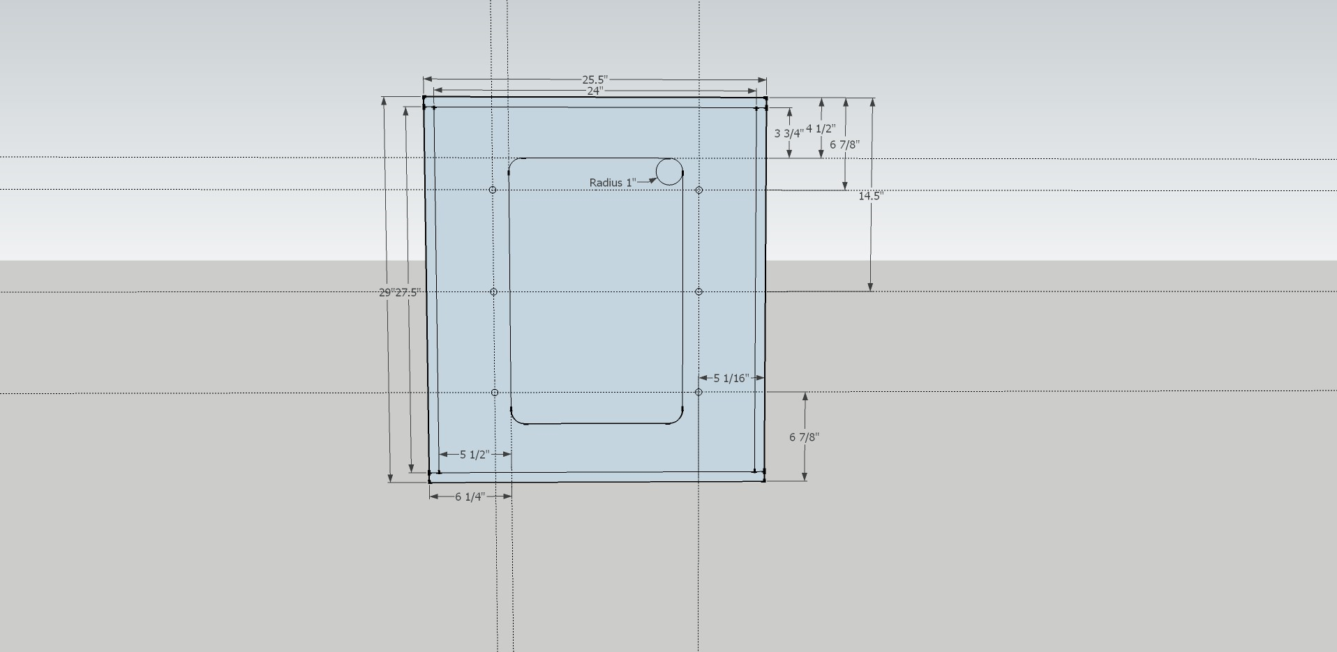

We are on the same page the 1940s one. I was thinking at first a cabinet similar to what you described (18.5inW x30inH x17inD)
Driver up a bit higher, ported and similar to the 612.
Does that sound about right?
I can start with active crossovers and play around until I find what works then build from there.
Thought I’d probably wind up pretty close to the m19 values tho anyway.

* 17.25", 2" IF you use the GPA 1200 Hz XO, otherwise it's a function of the point/slope or put it where you want and use DSP to time correct them.Yeah, all things considered, the M19's XO is fine IF you maintain the same woofer/horn vertical spacing, horn set back as the M19 = *

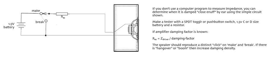

The pioneers in general and Altec in particular only damped one side, top, back of vented alignments with the understanding that 'top' meant the opposite end from the vent end, so for the original Iconic/846A this meant the bottom of the cab since the horn was in the reflex vent at the top.
Regardless, if wanting a true 'original' sound speaker, just google the various models and copy them, which means minimal bracing, damping that varied in type/density over time based primarily on cost reduction and screwed on panels with no gasketing!
In short, best to damp to personal 'taste' in room and if wanting some consistency use the pioneer's simple 'click' test.
