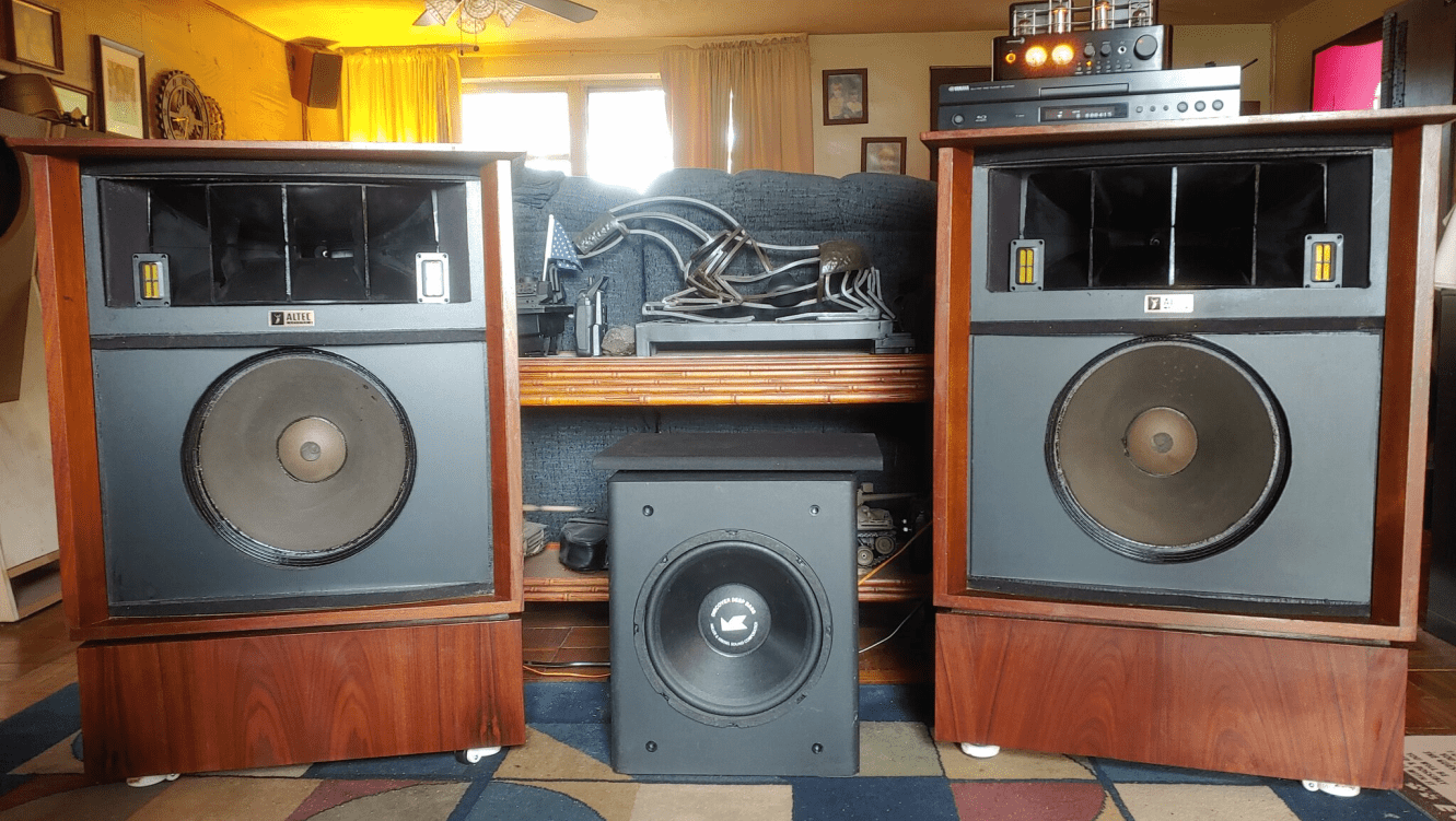

I don't see any vent(s), so a Santiago?
Vents might have been turned into quasi-aperiodic with the addition of fabric hiding the original fiberglass ( if still present ).
The owner is very happy with his modified ( second-hand ) Val's >> so I guess it's all a bit moot.
- Altec “Valencia” type cabinet
