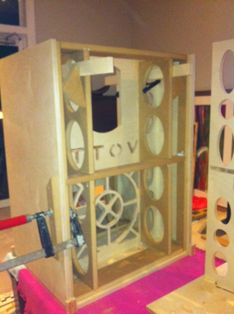

Thanks Cal...your'e very well regarded on the Altec forum...so I appreciate your kind remarks.

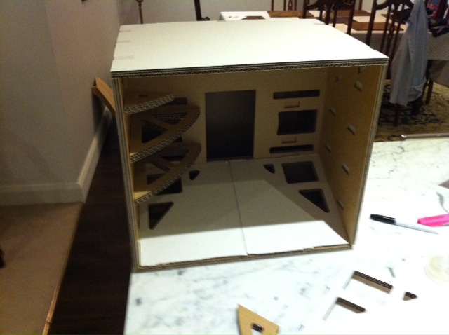

I'm also starting a smaller version of the bass horn, using 515 drivers.
This takes the cues from the A7...but about 3/4 the size.

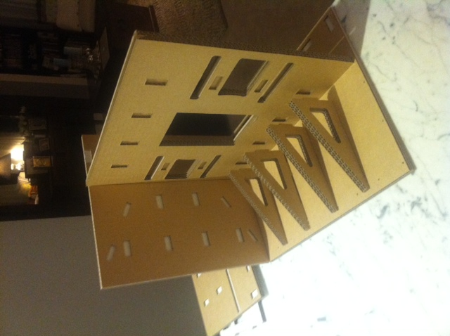

I've even created a 1/3 scale of it, using 10mm CNC'd cardboard...to check all the panels line up. See pic of little white cardboard horn. See also pic of my 3D rendering of this horn. Can be sat as a low profile, or an upright profile. Target response 50Hz-600Hz. Ported. Using Euro Birch Ply...same as A7.

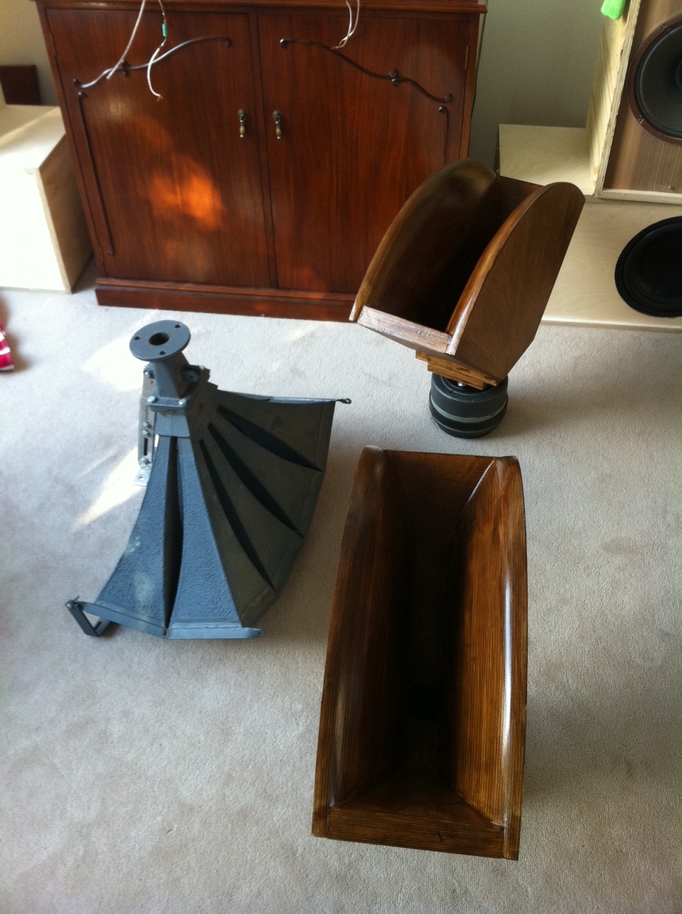

This will be for a two-way horn system, with one of my DIY CAD/CNC Yuichi horns on top and driver TBA, maybe 288, or a modern Radian or Faital Pro two inch.
Active xover, dual amps etc.
Fun.

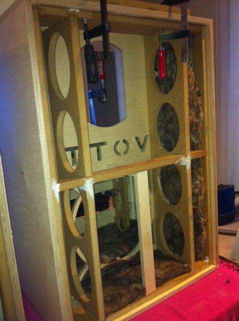

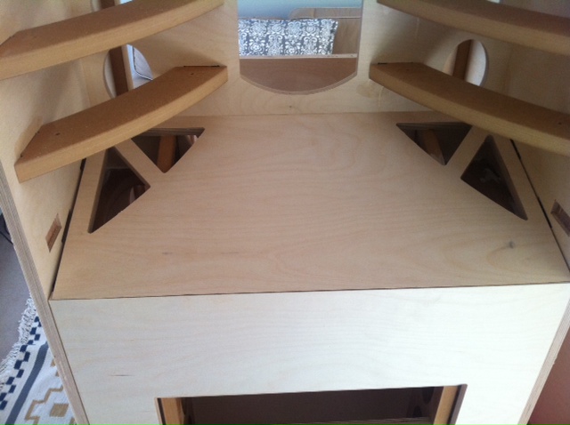

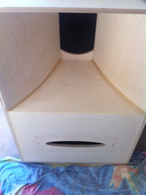

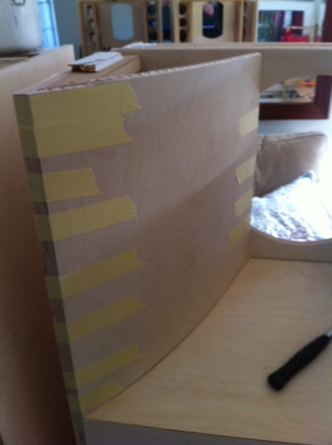

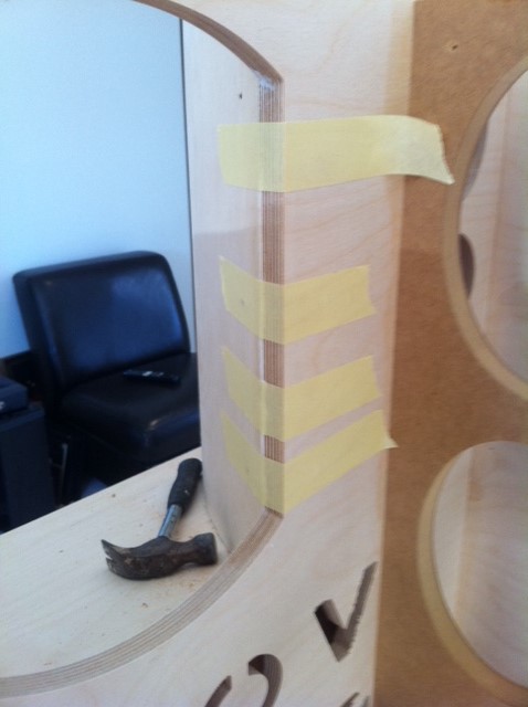

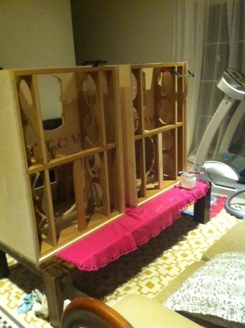

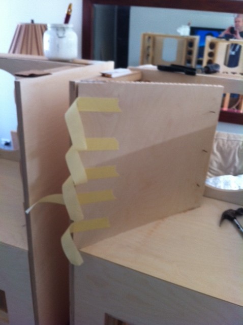

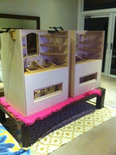

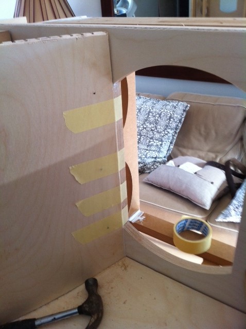

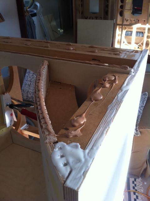

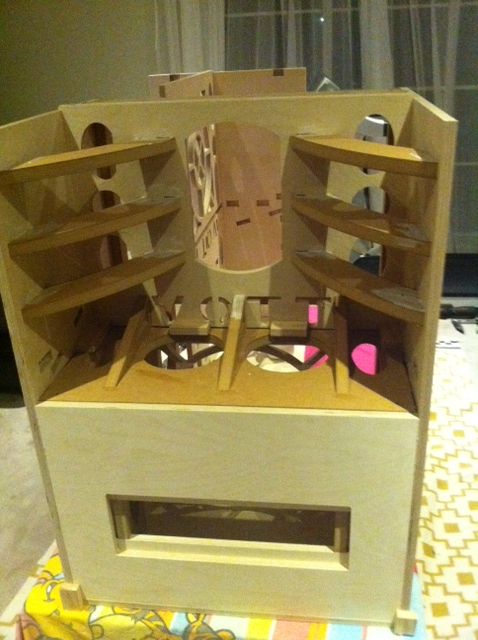

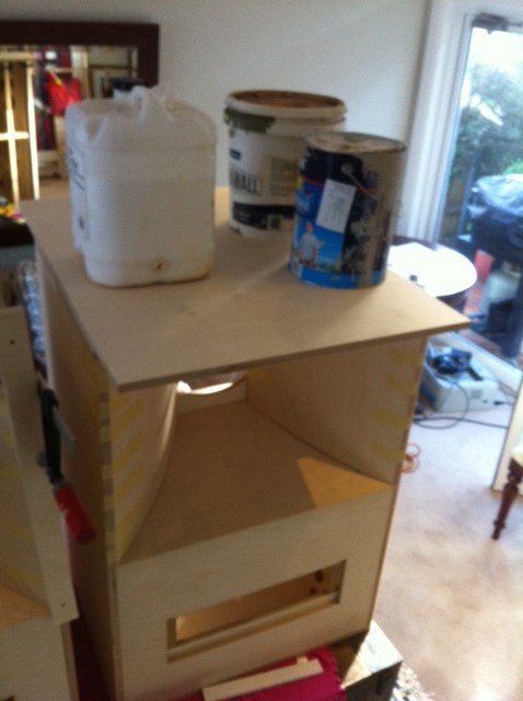

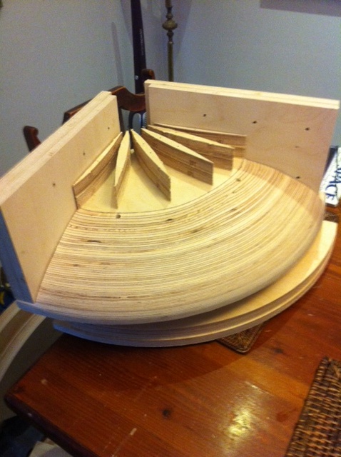

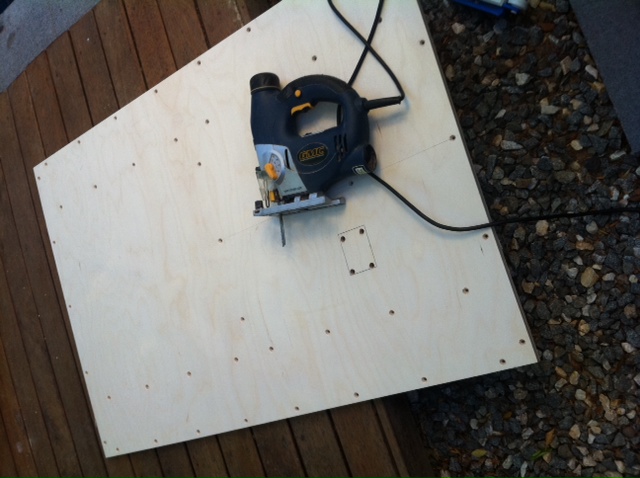

Flares in, lid on, min wool felt in.

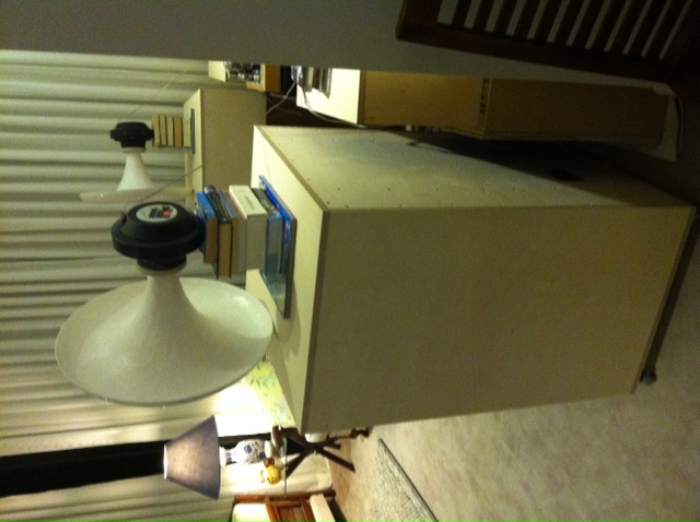

Congrats! Until someone makes a VOTT cab out of concrete, thick plate stainless steel or similar, it looks like yours are going to be the world's most rigid construction, ergo least able to 'color' the sound other than by Altec design, though I can't help but wonder if the DIY ones I did way back when with triangulated bracing, a double thickness top plate [since I didn't use a screwed on horn 'sled'] and oily/kitty litter filled horn cavities would come measurably close enough.

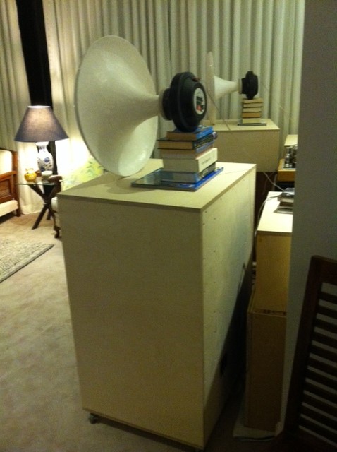

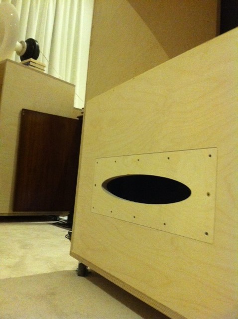

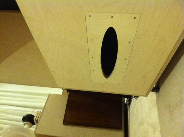

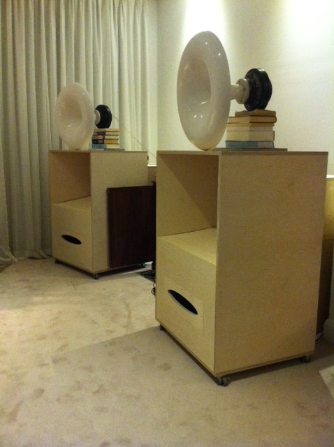

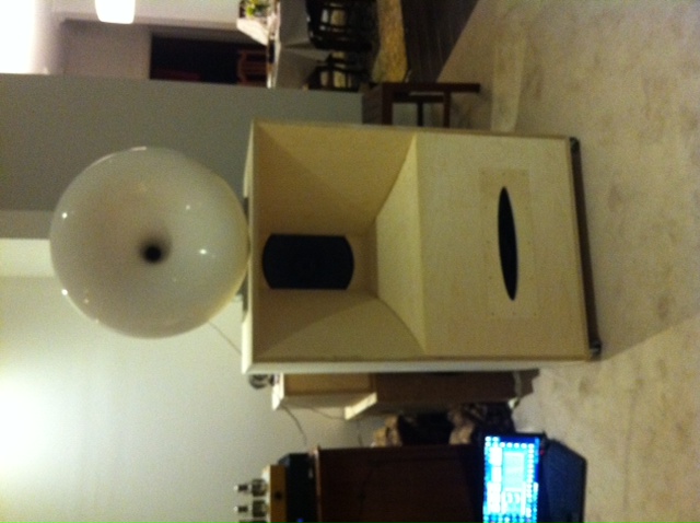

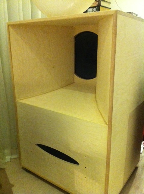

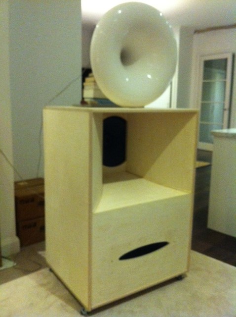

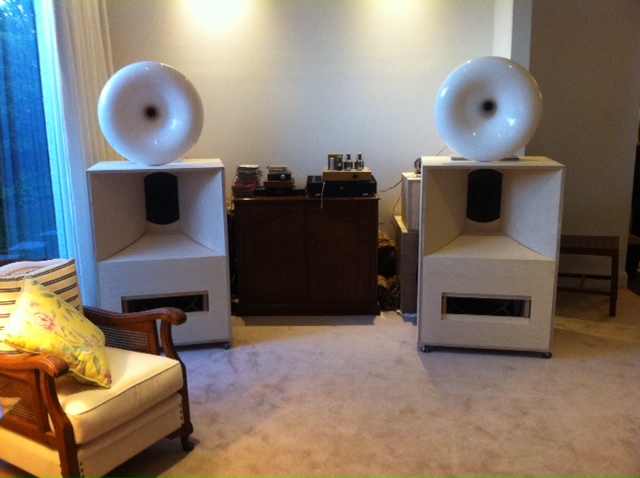

Just finished tonight...and fitted 515G's for initial testing.
Really liked the sound...took quite some time to adjust MiniSP to suit, eg 550Hz xover with BW 12db slope to match 600Hz Azura horns.
I now know these cabs need a BIG room....I just wanted to turn them up rally loud to test them.

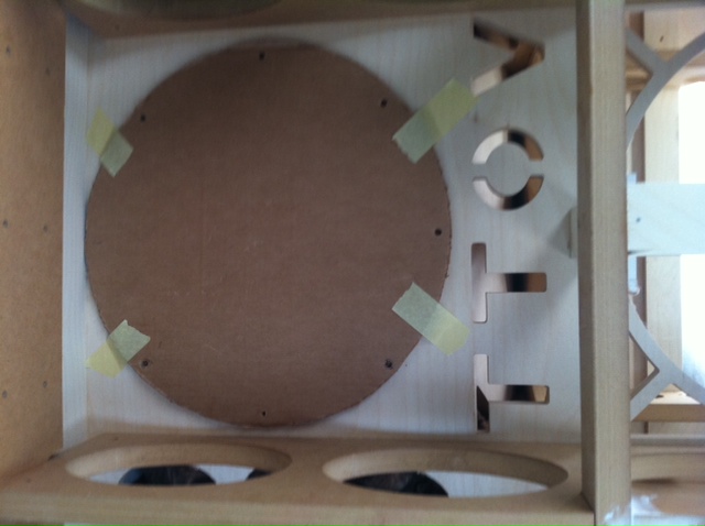

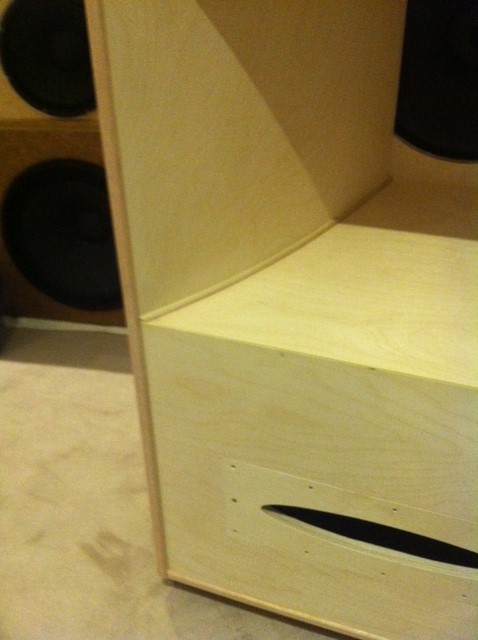

Added Oak beading and Oak trim.

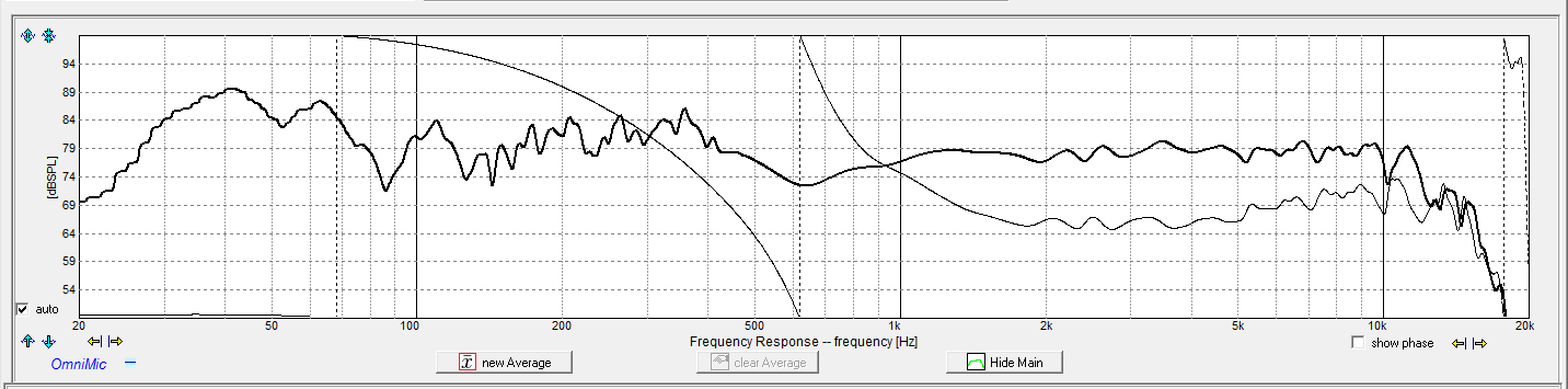

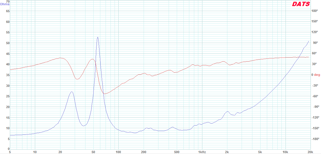

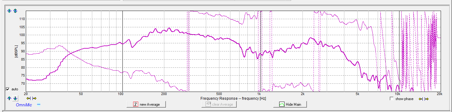

Measured the units today with Omnimic....added a few tricky EQ settings to 180Hz, 250Hz and 400Hz....now playing very nicely indeed.
Response plot of before/after EQ?
GM
i did the measurements, unfortunately i don't have the before and after, only before and after with azura horn on top 🙂
the above with Azura is out of phase, the dip was not as deep as it should be because we didn't adjust the levels properly.
it was a 20mins quick and dirty EQ and cover with miniDSP 😛

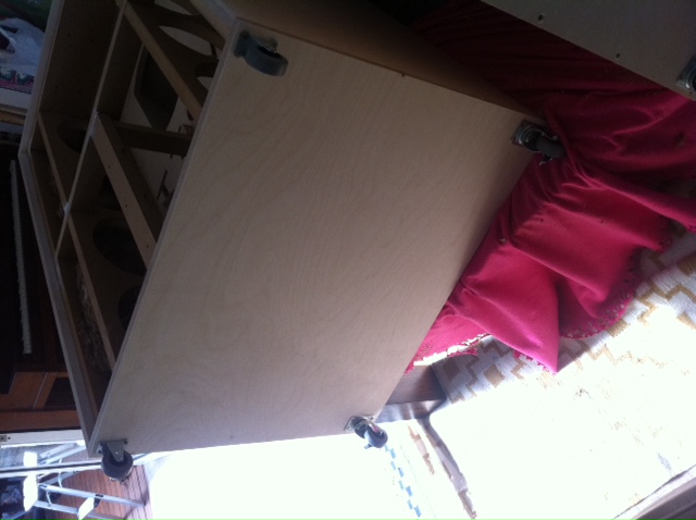

Install spikes!
Beautiful job!
While I realize the cabinets are a pain to move around, I'd replace the casters with spikes once they are in their new home. I believe the bottom end would sound considerably better if properly coupled to the floor.
Again, very nice!
Steve
Beautiful job!
Again, very nice!
Steve
Outstanding! It's statistically identical to Altec's measurement above the box tuning BW once I realized your plot wasn't a true log one. All it really needs now is a proper set of 'wings' and HF horn baffle + horn super-tweeter and separate sub system to make it a truly high SQ full-range HE system.
